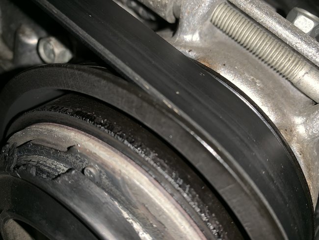

I've done some looking online, I saw where it could be A/C compressor failure. So I looked at the A/C compressor to see if the clutch was engaging. The clutch is engaging, but still no cold air coming out. Also the belt is also spinning. So I'm wondering if a A/C compressor can be bad, but the clutch still engages.I did notice that there was some wear and tear on the clutch. Rubber pieces around it, has begun to tear away. Also when I cut on the A/C the burning smell comes back.

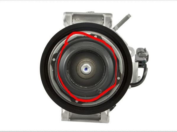

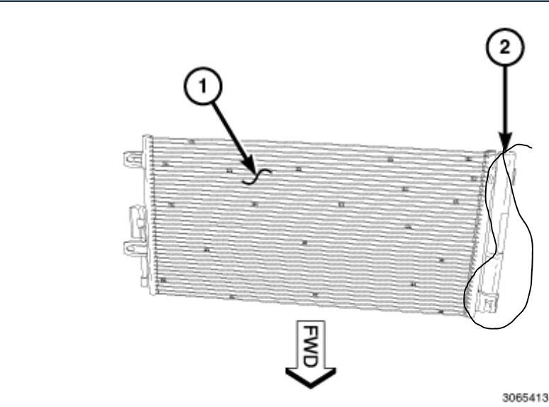

Based on your description, it sounds like the compressor has locked up. When the AC is in the off position, the pulley on the compressor spins freely, without resistance. When you turn the AC on, you will hear the clutch on the compressor click which engages the compressor. The clutch is the center part of the pulley. If you look when the AC is off, you will see it isn't moving. When on, it should spin. If the compressor is locked or in the process of locking, the belt may be slipping on the pulley and causing the burning smell.
Try this, with the AC off, open the hood. Have a helper in the vehicle. Watch the AC compressor while the helper turns the AC on. See if smoke starts coming from the AC pulley area. Also, pay attention if the center (clutch) of the pulley is spinning.
I attached a picture of an AC compressor and with terrible accuracy, I circled the clutch portion. That portion should only spin when the AC is engaged and not when it is off. See if it does when the AC is turned on.
Check that and let me know what you find.

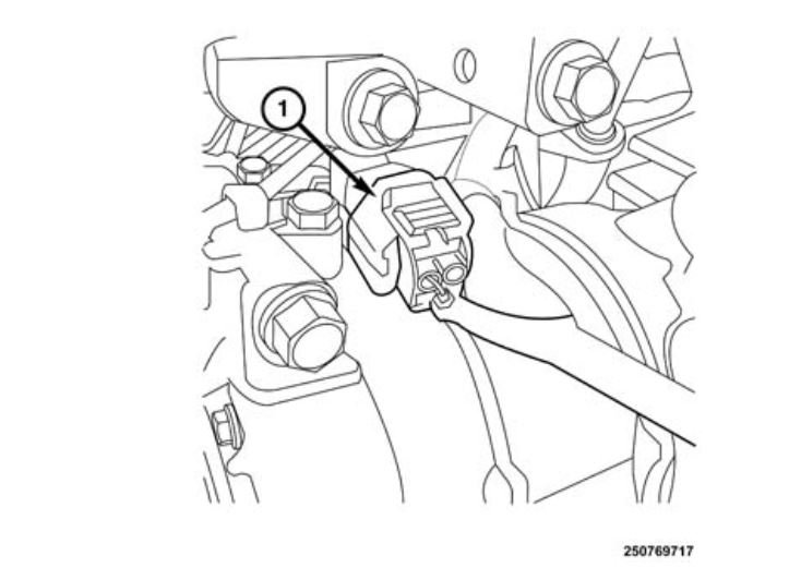

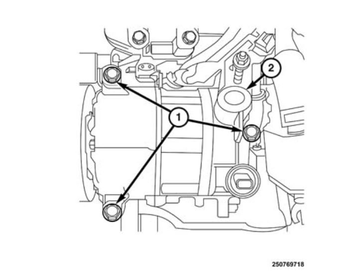

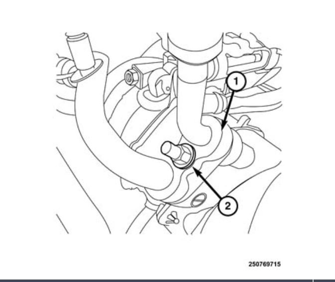

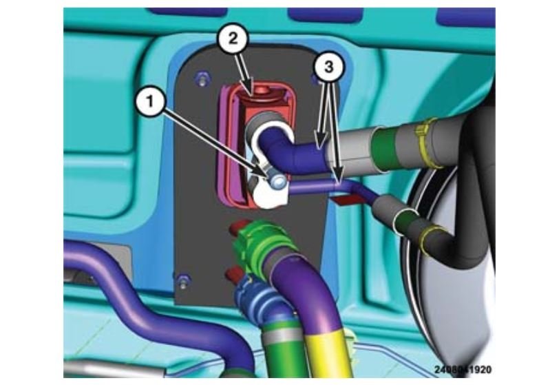

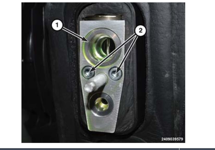

You will need to replace the compressor, dryer and expansion valve. The system will have to be cleaned of all debris and then evacuated and charged.

Spinning by hand won't work. Remember, the outside of the pulley where the belt rides will most likely always turn. It is the center that we need to know about. The center has an electromagnetic clutch that reacts when power is applied to it. It plungers inward and engages the compressor.
Because it is hard to see, do this. Have a helper with you, open the hood, and have the helper start the car with the AC off. Have the helper turn the AC on while you watch the compressor to see if you can tell. Also, and more importantly because of its location, it should make an audible clicking when it engages. One click each time it engages. See if you are able to hear it at the same time you are watching it.

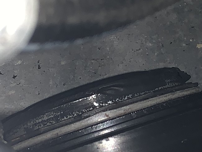

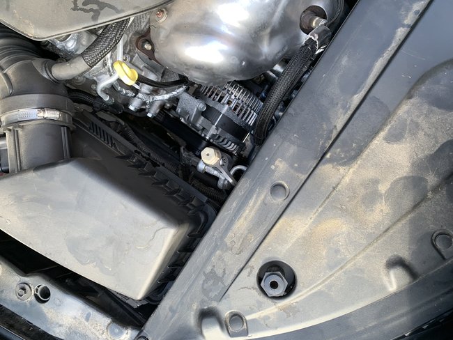

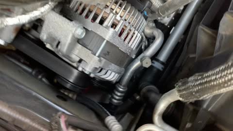

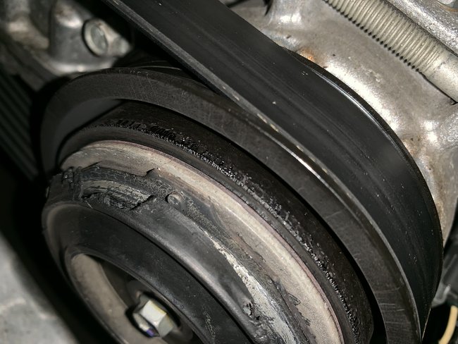

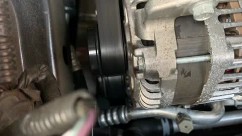

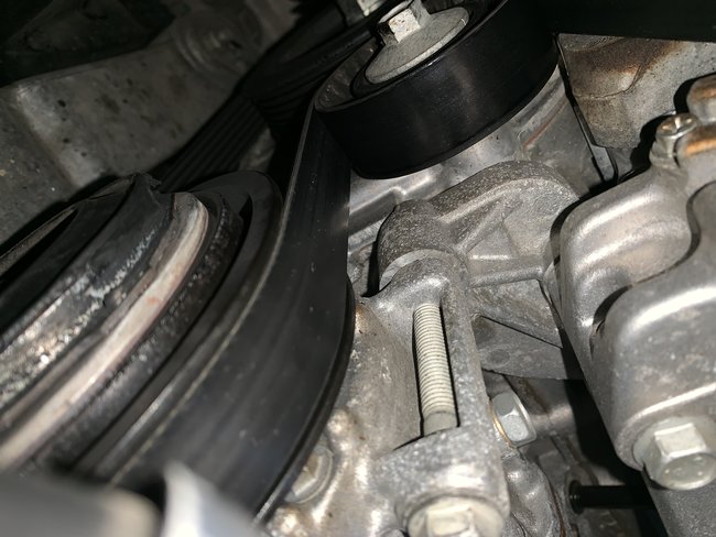

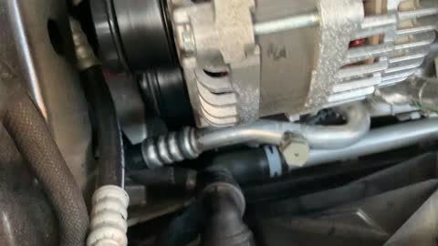

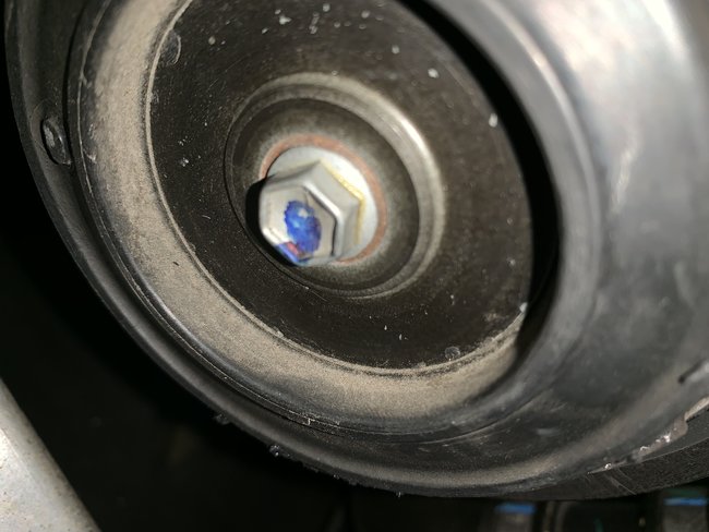

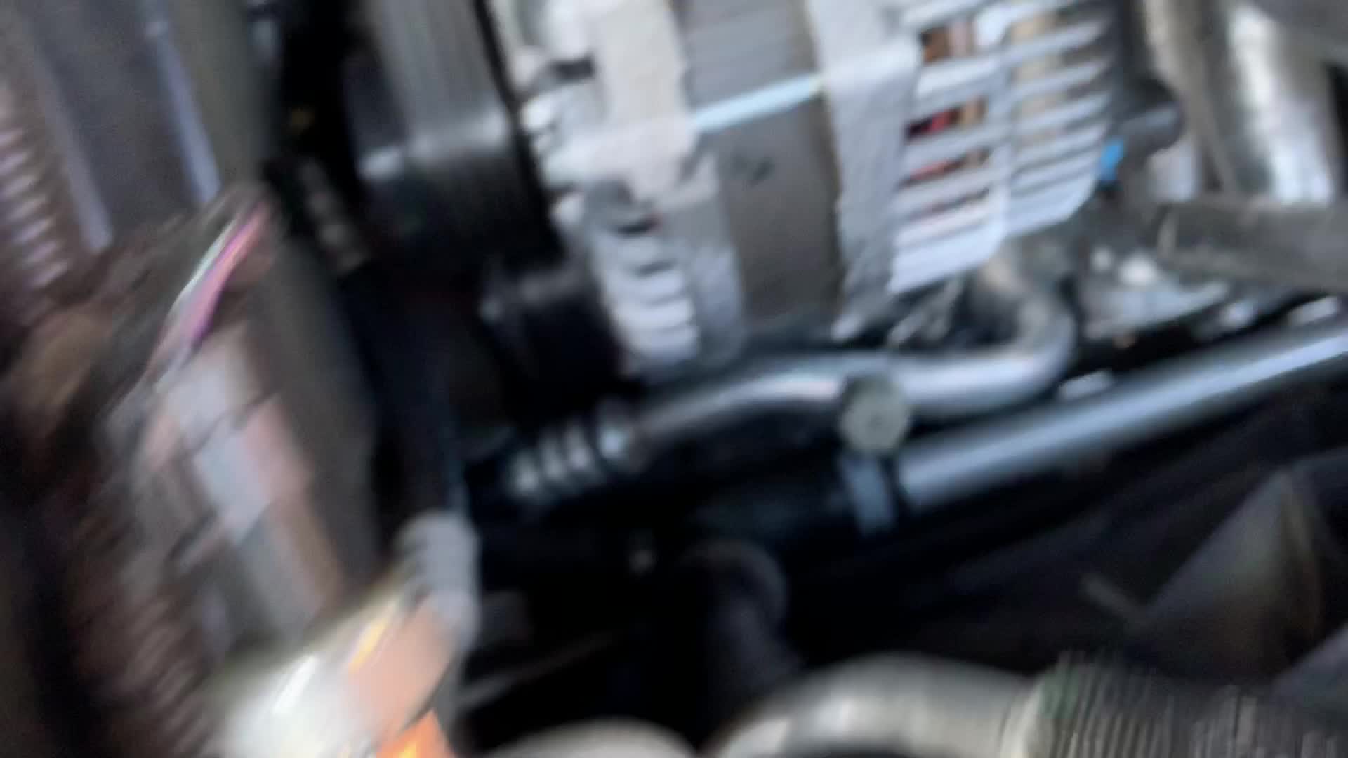

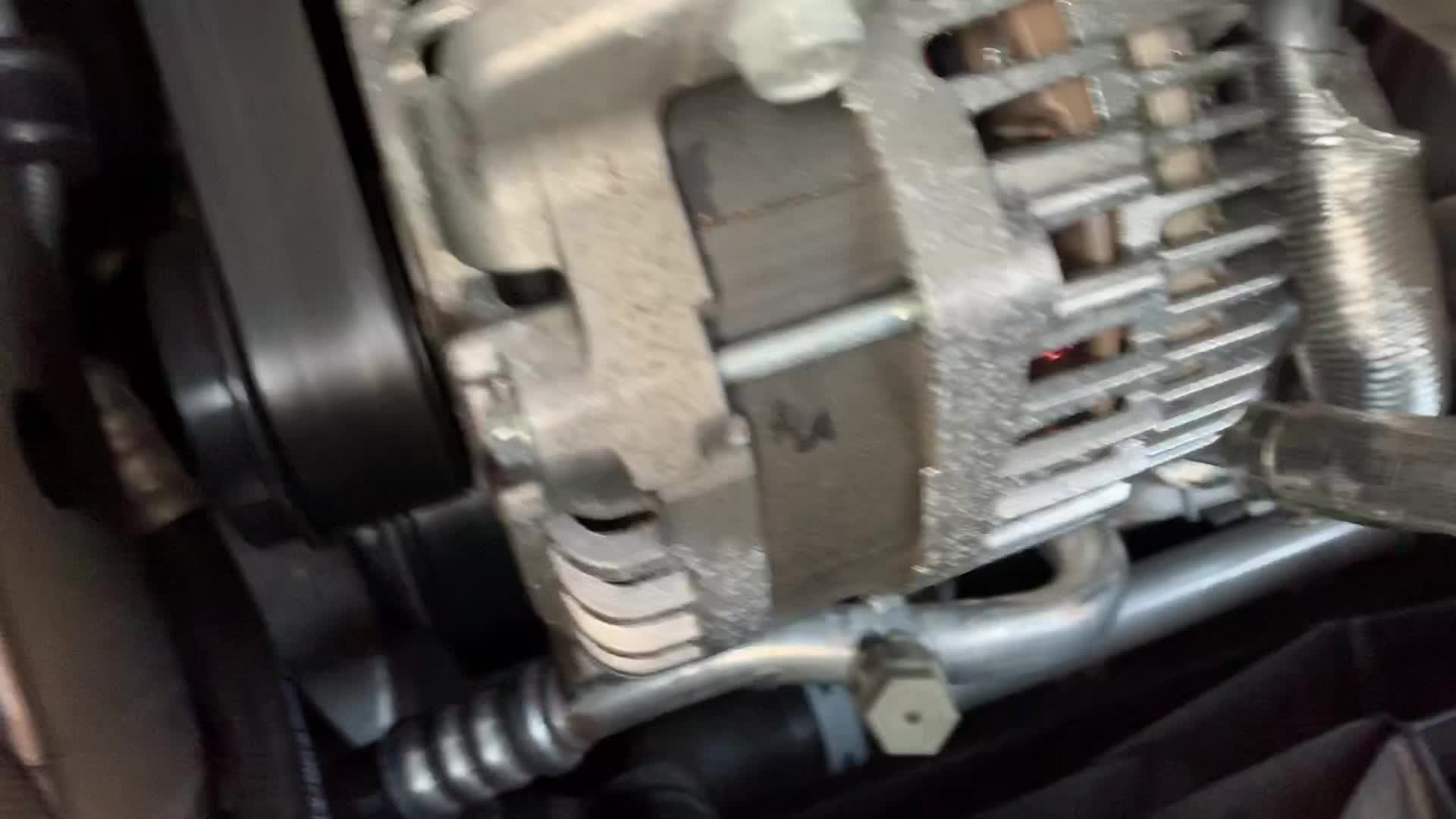

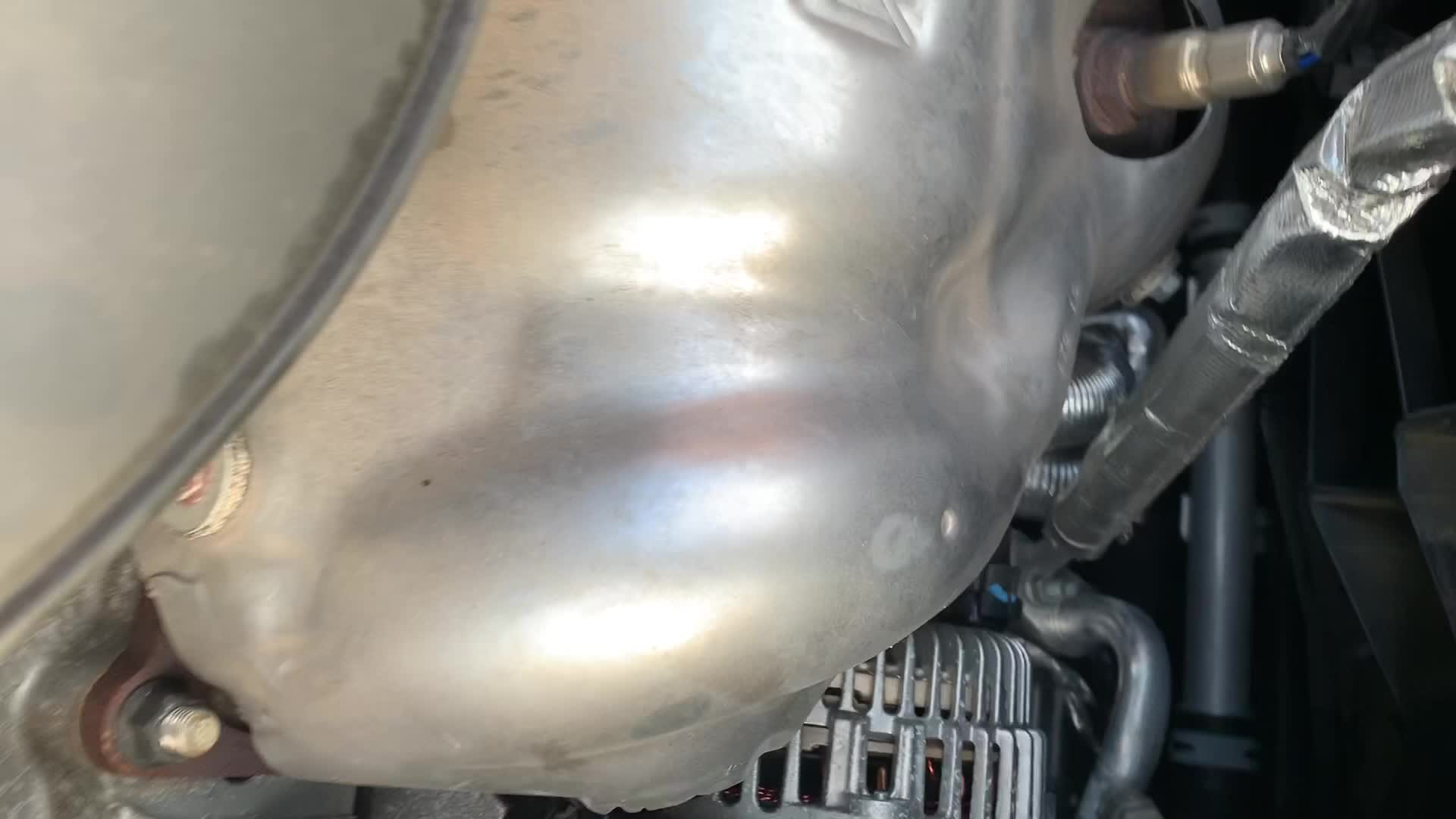

Hello Joe, I gave it a shot this morning. I also had a helper with me during this. We could see and hear the clutch engaging. We heard that clicking sound that you mentioned.
I'm attaching some videos and pictures. Particularly when the A/C is off, it's like a rattling sound coming from somewhere (2 short videos). Hopefully you can hear those sounds, it's almost like something is out of alignment and rubbing. I also attached a longer video so you could see the clutch spinning. We still noticed the burning smell when turning on the A/C. And in the pictures that I've attached, you can see the rubber pieces around the clutch tearing away.
Thanks for you help again!
Jul 5, 2019 at 9:57 PM
Looks like you need the compressor changed out.
Jul 5, 2019 at 10:08 PM
