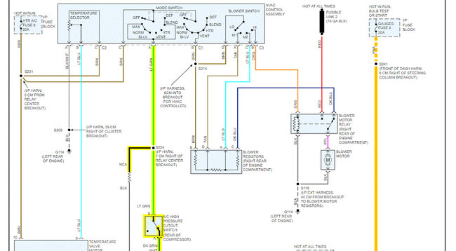

System is full and I have changed the low pressure switch and the relays. I need to know how to change the high pressure switch on the back of the compressor?
Sep 11, 2020 at 11:53 PM
Good morning,
The compressor will have to be removed to change the switch.
How do you know it is bad? It is a normally closed switch. Remove the wires and jump the connector. If the problem continues, then that is not the issue.
What are the Freon pressures? Low Freon pressure will cause this issue.

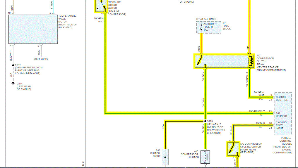

I attached a wiring diagram for you of the system.

Because I have replaced everything but the switch on the back of the compressor and the reason why I haven't changed it yet is because I don't want to mess anything up on the compressor. it will cost me $200.00 + to replace it.
Sep 13, 2020 at 8:15 AM
That is a normally closed switch. There should be power on both wires when the key is on.
What about the Freon pressures?

Okay, I understand.
If the pressure on the high side is too high, the high pressure switch will open and shut down the compressor until the pressure lowers.

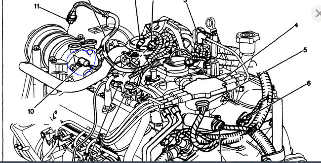

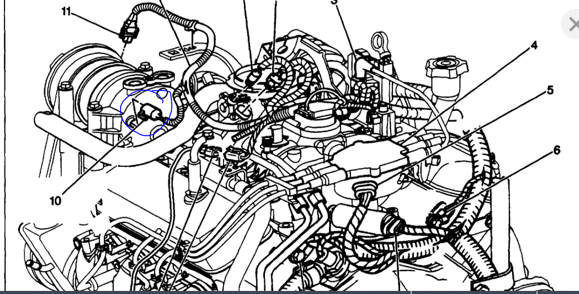

Okay, thank you for your response. but all i want to know is how do i change the pressure switch on the back of my A/C compressor? And to answer your question again the system is full i had the dealership remove and refill my system and everything but the compressor and pressure switch on the compressor has been replaced. The compressor is fine i have had it checked 2 times. all that's left is that switch.
Sep 13, 2020 at 12:45 PM
Okay, got it.
The A/C Freon must be recovered from the system. Then remove the connector for the switch. Then, there is a snap ring that needs to be removed and once it is out, the switch pulls out.
The new one pushes in and install the snap ring and the connector.
Then the system needs to be evacuated for 1 hour and charges with the proper amount of Freon. Hopefully it will solve your issue.
