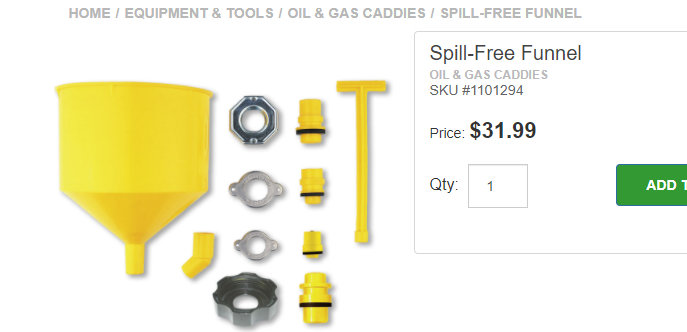

We need to do a couple of things. First, we need to fill the cooling system using this method. Lift the corner of the vehicle closest to the radiator cap. This will force any air out of the system and then use a spill free funnel to prevent any space from being filled with anything but coolant. I attached a picture of this funnel below.
https://www.2carpros.com/articles/coolant-flush-and-refill-all-cars
Next, we need to allow the engine to get hot and the thermostat to open.
Don't worry about if it burps or not, just let it open and get hot and then when there are no bubbles, put the stopper in the funnel and reinstall the cap.
