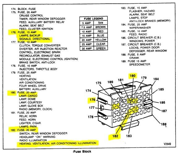

Of course the heater and A/C do not work now. I had an extra module and installed it. No difference. I checked every fuse in the dash fuse box, all good. I seen someone mentioned an LPS fuse. Is it located in the dash fuse box? Any help would be greatly appreciated. TIA
Dec 16, 2019 at 4:52 AM
  • 110,240 POSTS

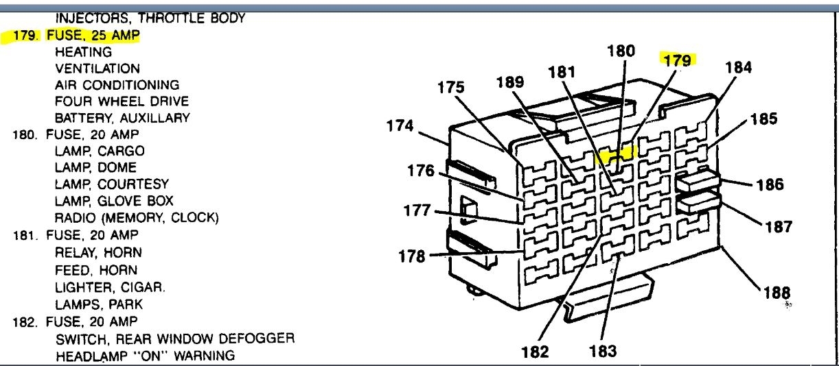

Normally, LPS stands for lamps. I attached two pictures below. The first is specific to the control module and the second indicates anything dealing with lamps. Take a look at it and see if it helps. Also, once you confirm the fuse is good, then you need to confirm there is power to the fuse itself (both in and out).
Let me know what you find.
Dec 16, 2019 at 6:52 AM
JOHNEAST699
I have checked all the fuses in the fuse box. They are all good. Everything that runs off of these fuses is working fine. I am away from my shop, but I will put a test light on each side to be sure. I read some where about moving the main harness under the hood. I did that but seen no changes with the lights. Now the buttons on the module still light up. Just the screen portion that indicates temp variance is not working.

If we have power to the module, I suspect it may have failed.

I checked all through the schematics and there are no inline fuses or fusible links. I checked for a diagnostic flowchart for the module, and found nothing. If it is getting power and won't light but the other things do, then it isn't a ground. The idea that it has power and ground and doesn't light to me indicates it needs replaced.
I wish I had a better answer.
