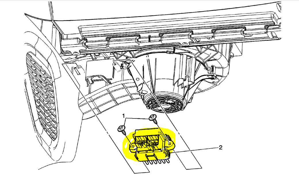

The HVAC blower motor doesn't use a relay. Instead, there is a blower motor control module.
If you look at the pic below, I highlighted the module. This component takes the place of the relay and blower motor resistor.

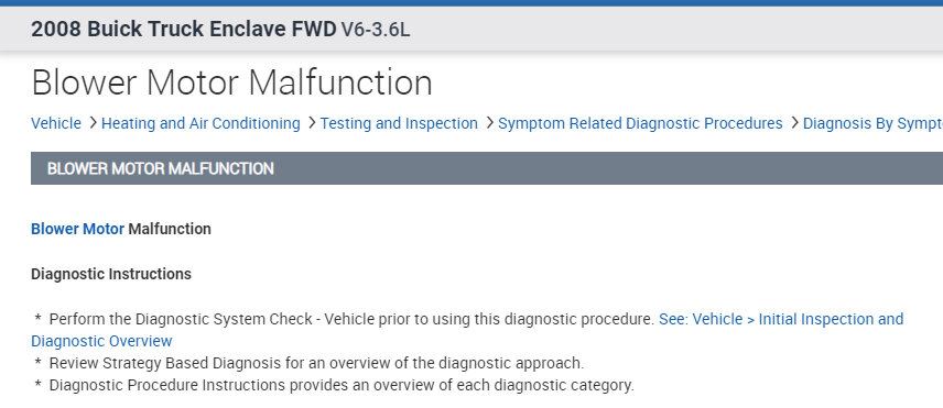

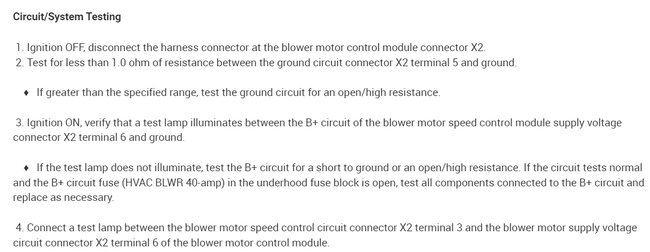

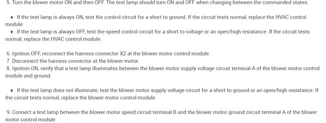

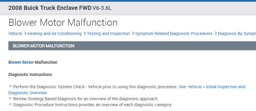

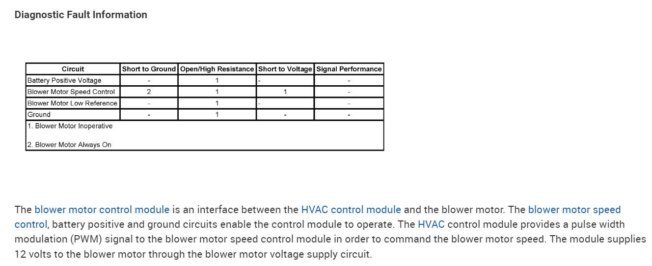

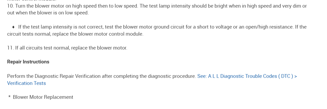

I'm not sure if it isn't working at all, but I attached the diagnostics related to a malfunctioning blower motor. Take a look through them and let me know if they help.

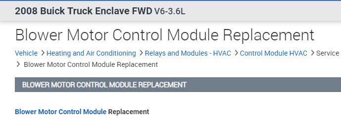

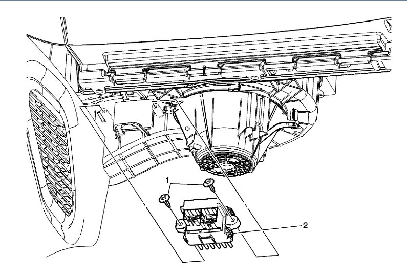

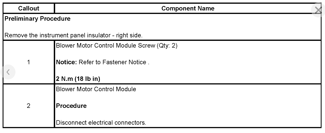

I attached the directions below for replacing the blower motor control module. It is really easy to do. There are two screws that hold it in place and an electrical connector to disconnect.

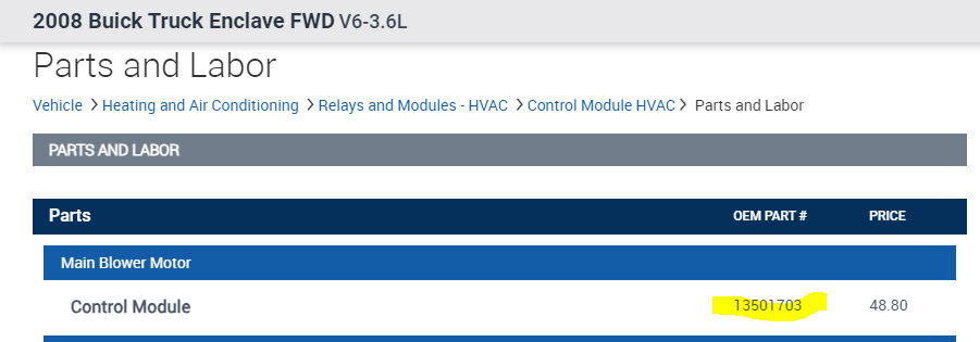

Also, I added the last picture so you can see the OEM part number.
