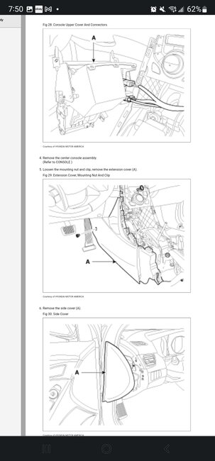

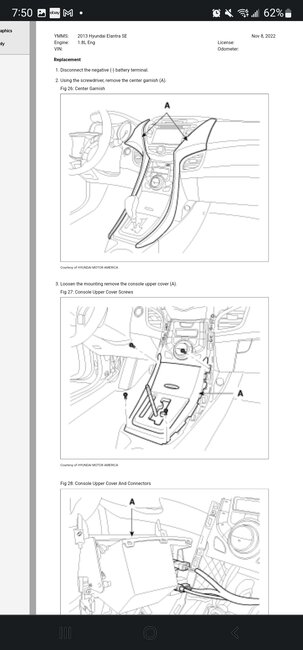

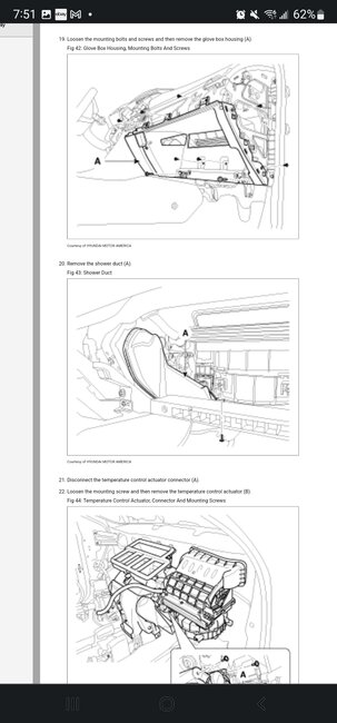

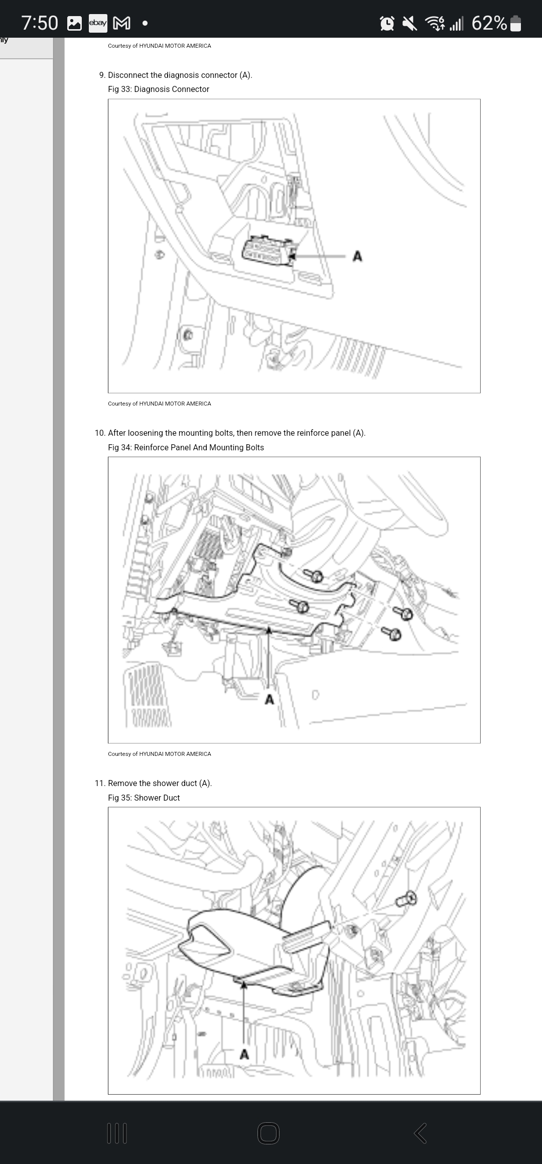

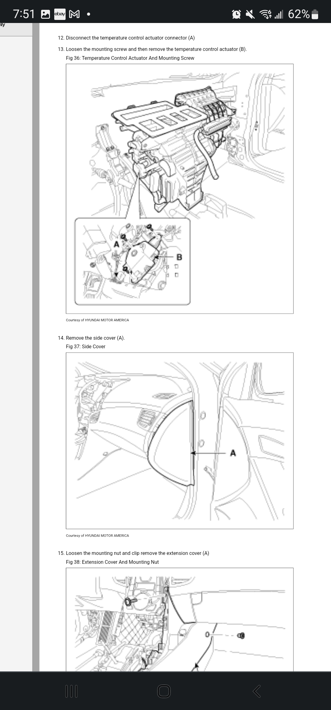

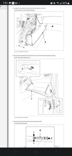

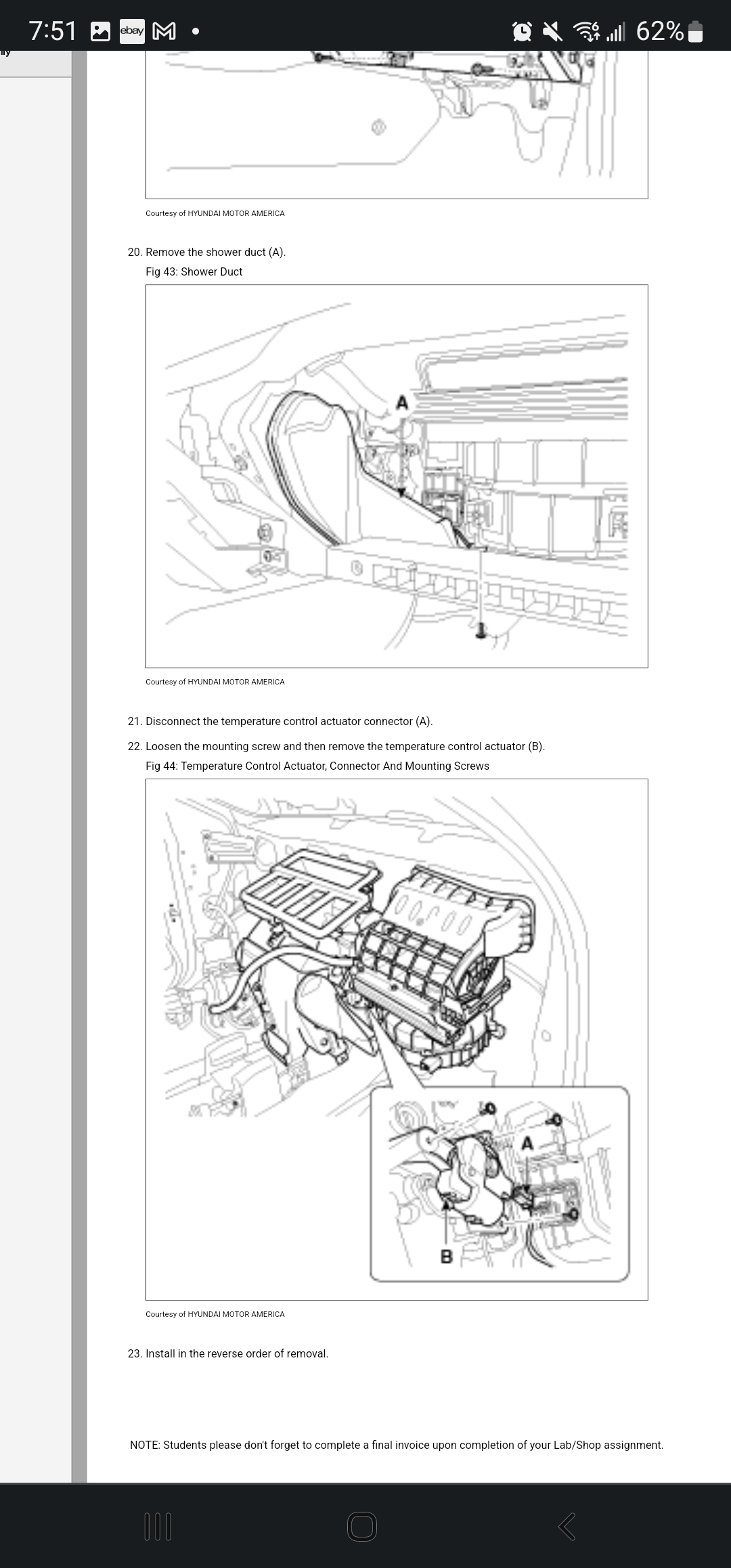

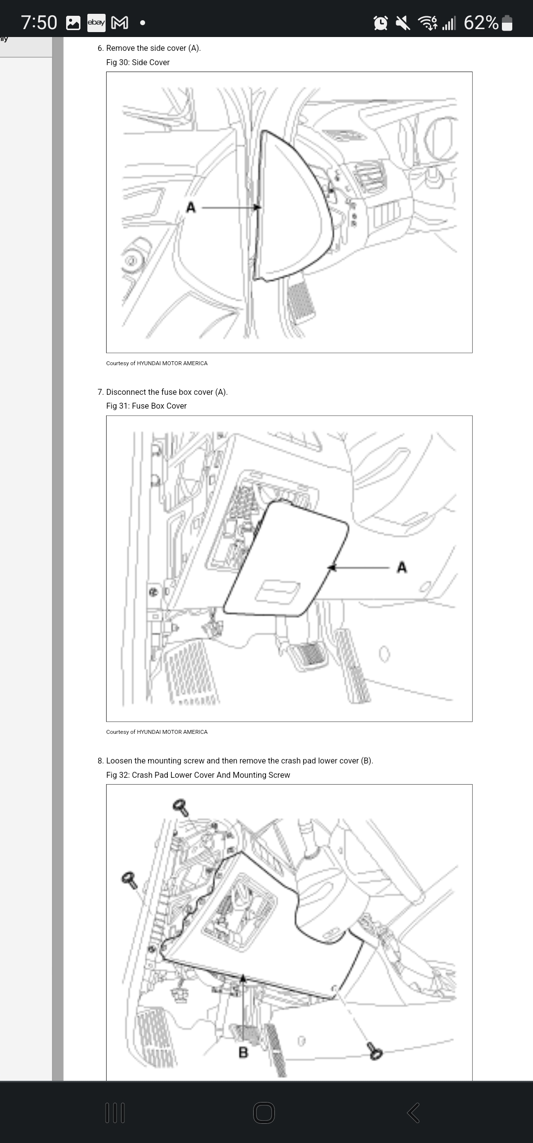

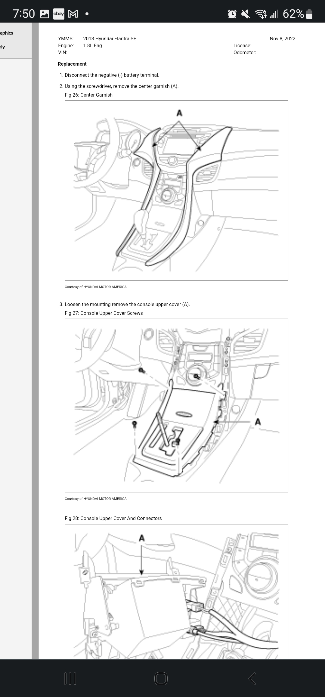

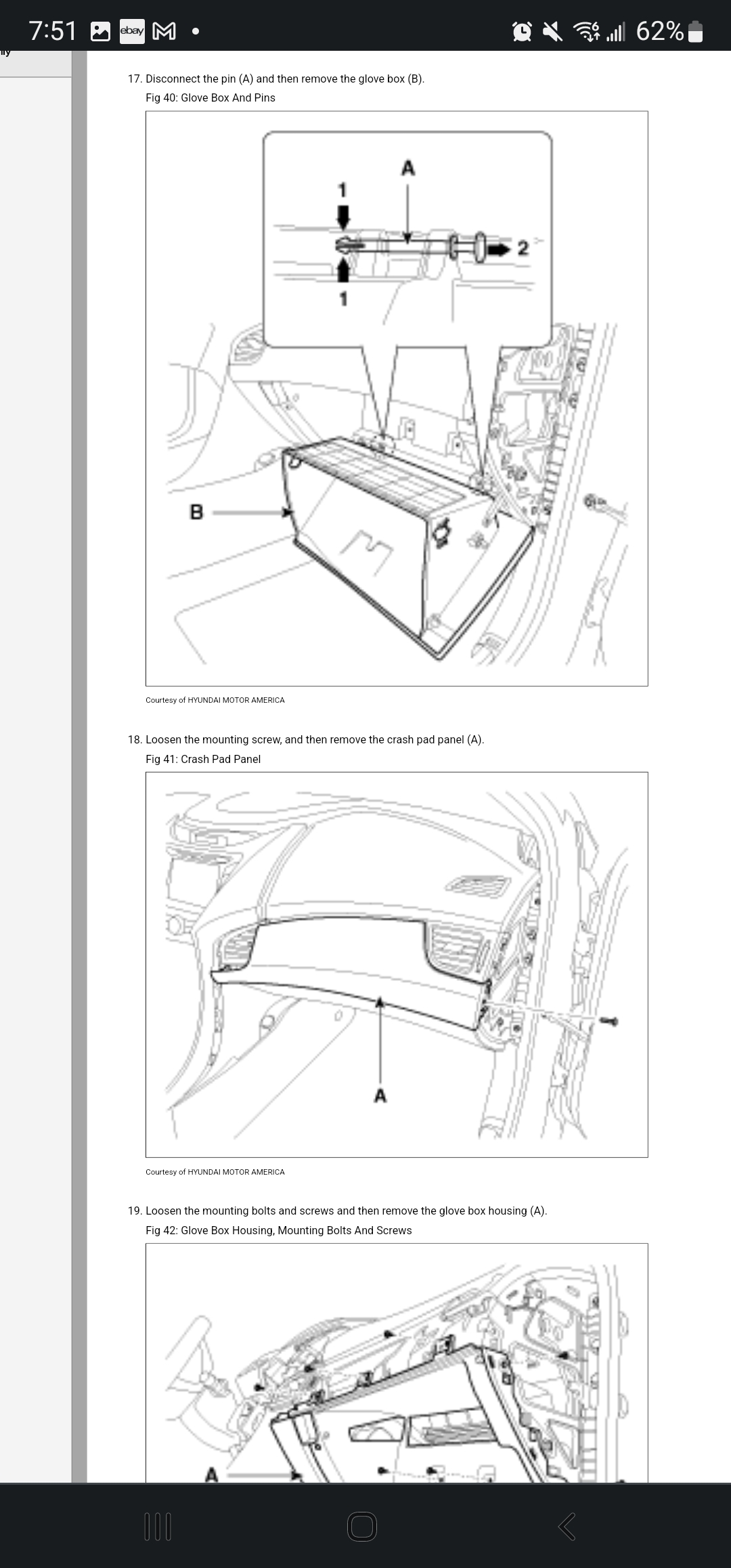

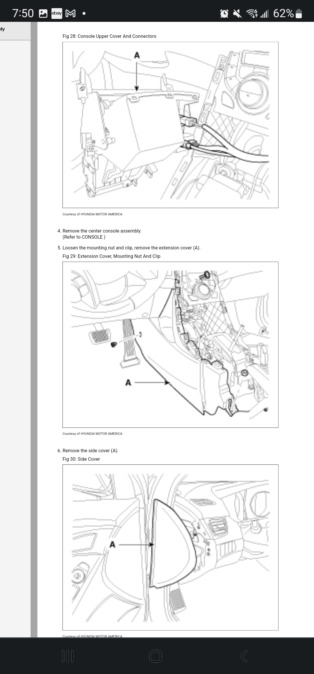

On which side of the dash is the actuator located?
2013 HYUNDAI ELANTRA
98,000 MILES • 1.9L • 4 CYL • 2WD • AUTOMATIC
EDWARD LIBERATORE
MEMBER
1 POST
A/C heater blend door actuator.
Nov 8, 2022 at 8:47 AM
SATURNTECH9
Experienced Mechanic
30,869 POSTS
I gave you the location and how to replace it. Check out the images (below). Please let us know what happens.
