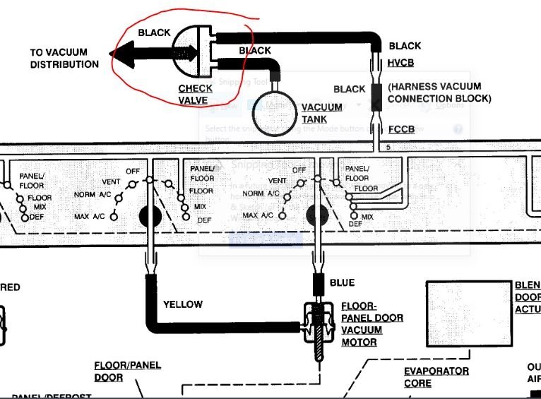

A/C goes to default(defrost) upon high load(acceleration). Seen where it's a vacuum leak or accumulation tank/check valve. Replaced accum tank and no change. Upon further investigation realized that with fan off and AC/heater sector to off, if I change the temperature control from cold to hot doesn't blow but temperature changes (blows lightly). I have checked vacuum under hood and can't find a leak. Blend door doesn't make clicking noise like broken.

Good morning,
I attached a diagram for you.
There is a check valve that prevents the loss of the vacuum on acceleration.
Check that valve.

How do you check it when it's in the accumulation tank?
Jun 16, 2020 at 12:30 AM
With the engine off, there should still be a vacuum in the tank to move the modes in the truck. It should not bleed-off.

How much vacuum am I looking for again Roy?
Jun 16, 2020 at 1:02 AM
At least 18-22 inches of vacuum.
