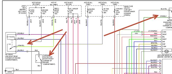

I just got car, I realized that the alt cooling fan was not working, I replaced it then the clutch did the clicking turning off & on like it was low on r134a i had it evacuated, vacuum, recharged and drier replaced . That work except when it gets hot outside or so it seems the ac clutch won't engage, I check to see if getting power through the wires on the clutch that i was able to get bare copper and didn't get a reading with my Volt meter. I live in Phoenix Az and it gets to about 100 degrees in the morning/ evening when cooler ac comes on, but during the day ac quits. What could be happening?

check all your fuses and then check what I've pointed out in drawing. see If voltage is going to both sides of these. Also make sure you rcondensor fan works because it may cause the a/c not to work as well.

feel the smallline going to the heater box and see if it is icing up it may have what is called freeze up if it is it ahs to be reevacuated and recharged again. but you shouldn't have that if the system was charged and evaced and drier replaced. Other than that have a pro look at it. Unfortunately the things that I 've pointed out wilonly screw up when your air quits.

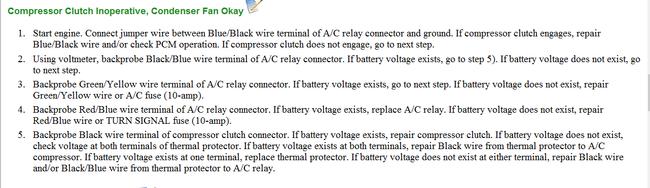

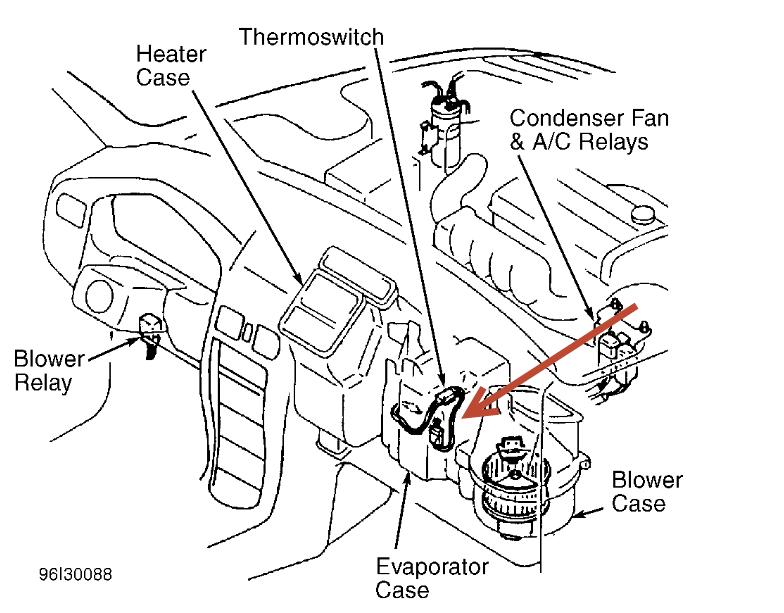

as I said before if the condenser was bad it would have shown up as a blockage during evap and recharge. as your a/c works until it gets hot. As I've explained before in your case it is either freezing up which will shut off the compressor or possibly your termal switch is knocking the system out or the low pressure switch or it can be the heater control unit and or amplifier gone bad. But you'll need to scan that if not cable operated. i'm sending the way to check compressor clutch operation. this can also be a pcm problem or not enough or to much Freon. if you are having trouble with this you should really take it back to where it was repaired in the first place and quit thinking your condenser is bad.if there is a blocakage anywhere in the system it would be at the orficee right in front of the evaporator. It may also be the thermal switch which allows the a/c to kick on and off if bad or not sitting in evaporator right.
