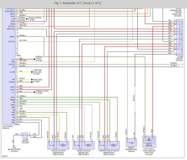

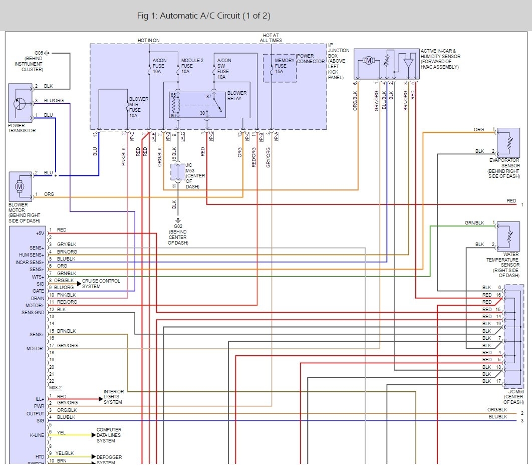

I did some digging and found a wiring diagram for you to look at, it seems like the 10 ac fuse goes to the ac control module. Please try to unplug it and retry the system.
Best, Ken
Mar 14, 2017 at 4:58 AM
MOSHEEN
  • 15 POSTS
Thanks ken the diagram is going to be a great help, when you say "ac control module. Please try to unplug" do you mean the dials on the dash and remove the cables from behind the panel.
Thanks again
Mo

Hi ken I used above wire diagrams but mine looks different, the 10A/C Fuse also controls the alarm and rear wiper. So I need a diagram so I can isolate the issue I have also added the VIN NUMBER thanks again

from your description your car is not in US or Canada as most kia's here have larger engines . We are more than likely not to have the correct diagrams for that car as you have said the fuse controls alarm and rear wiper in US those are separate circuits.
