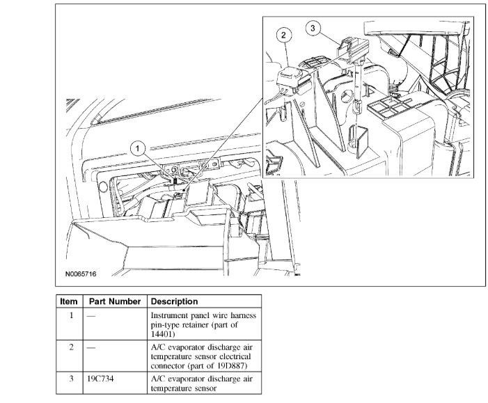

Good day,
Can't find where placed A/C Evaporator Temperature Sensor in vehicle listed above
Thanks in advance.
Oct 23, 2019 at 5:45 AM

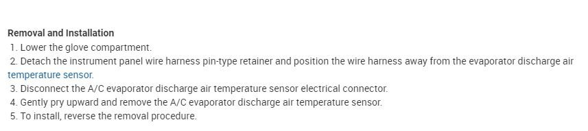

Good morning,
It is behind the glove box inside the car.
I attached a picture and the procedure below.
Oct 23, 2019 at 8:39 PM
