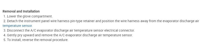

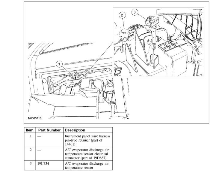

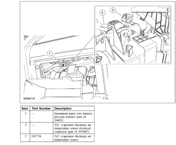

Good day,
Can't find where placed A/C Evaporator Temperature Sensor in vehicle listed above
Thanks in advance.
Oct 23, 2019 at 12:45 PM
Good morning,
It is behind the glove box inside the car.
I attached a picture and the procedure below.
Oct 24, 2019 at 3:39 AM
