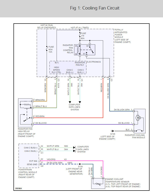

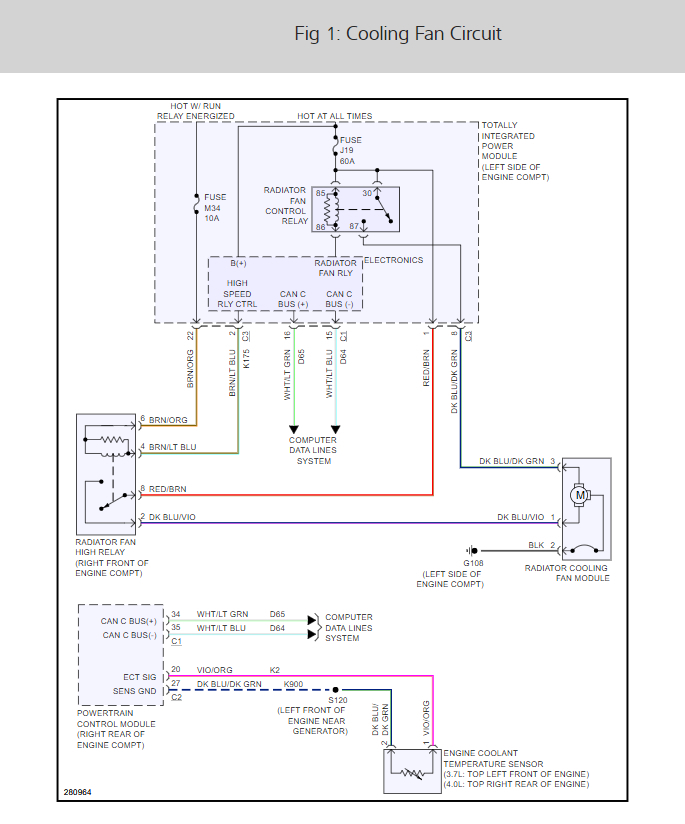

Can the coolant fan be tested through the fan relay on the car listed above? Thanks
Sep 24, 2019 at 3:05 AM
  • 55,399 POSTS

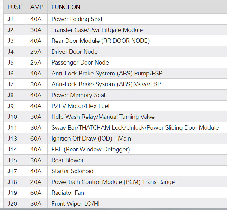

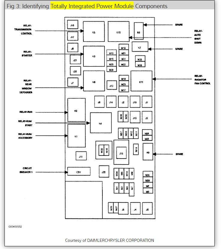

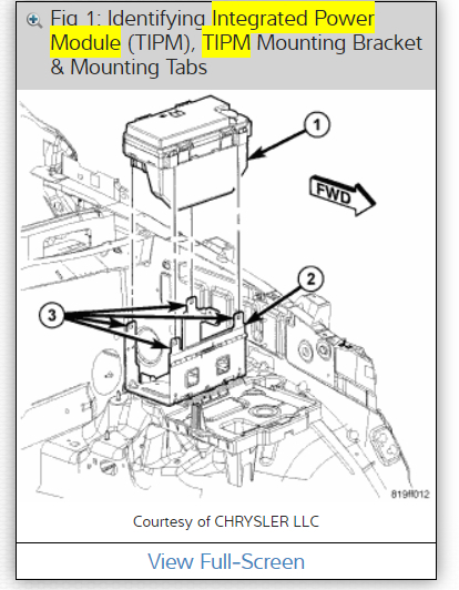

Yep, you must connect the 30 and 87 terminals of the fan relay. here is a wiring diagrams so you can see how the system works and where the relay is in the diagrams below:
https://www.2carpros.com/articles/replace-electric-fan-motor
