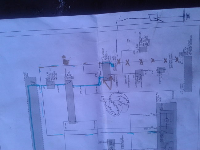

After having a auto shop remove and replace AC compressor dryer and expansion valve power to the clutch relay did not work. Technician diagnosis says Addie relay PCM is not supplying ground to the compressor so they used a jumper wire on the compressor relay. Before the remove and replace everything work, but not very well. The clutch was going out in the compressor was going bad also. That is why I changed it out. I am going to supply the schematic that he is giving me see if you can make heads or tails out of this.

I looked at the schematic and yes, what he says makes sense. However, since the compressor engaged prior to repairs, I question that the PCM is bad has gone bad. There is an AC pressure switch mounted on the left front (near radiator) to the accumulator. I would ask if that has been checked. Also, do you think they would provide the low and high side pressure readings when the system is engaged? If pressure is too low, the pressure switch will not allow the PCM to provide ground. If you provide power and ground, it does not have a choice but to engage.

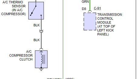

Now, I have looked through my schematics and it shows the compressor ground is through its mount. It does not go to the PCM/ ECM. I have attached my schematic for your review. Basically, what I see is ground is not provided by the PCM/ECM but rather, it comes from the compressor mount which is attached and grounded to the engine.

Thanks again Joe for all your knowledge. As for the hi and low numbers on the receipt, no there was not any. But As I was following the schematic wire colors I came across the pressure switch connector which on my year trooper is attached to the top of the dryer. One of the female leads that plug into the switch was off the switch, funny thing is that they were stand-alone wires all my other connectors that I can see are plug in type. I replace the jumper wire with a brand new compressor relay and so far ice cold air! I am still going to take it to the place that fixed my Trooper in the firsthand. I will keep you posted.
