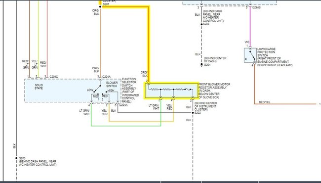

It doesn't blow air.
Aug 1, 2019 at 5:40 PM
Good morning,

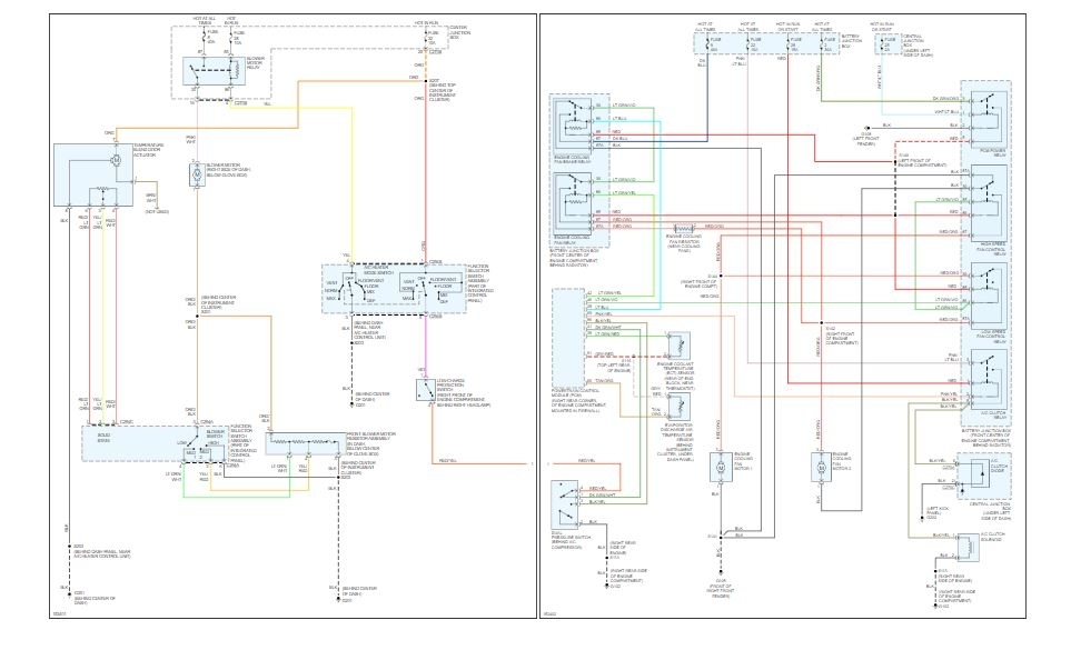

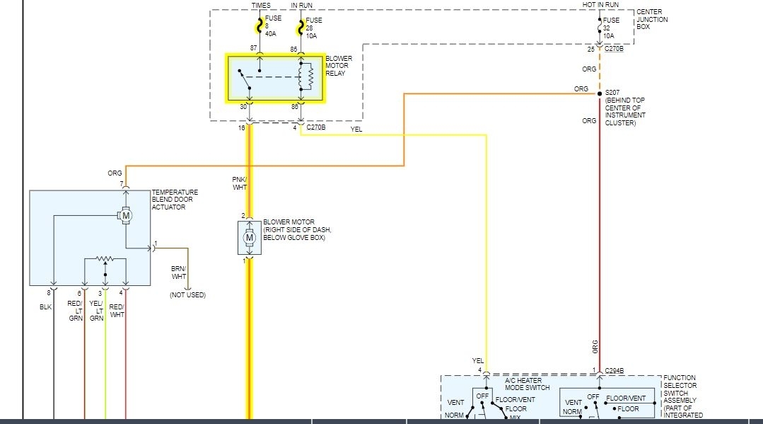

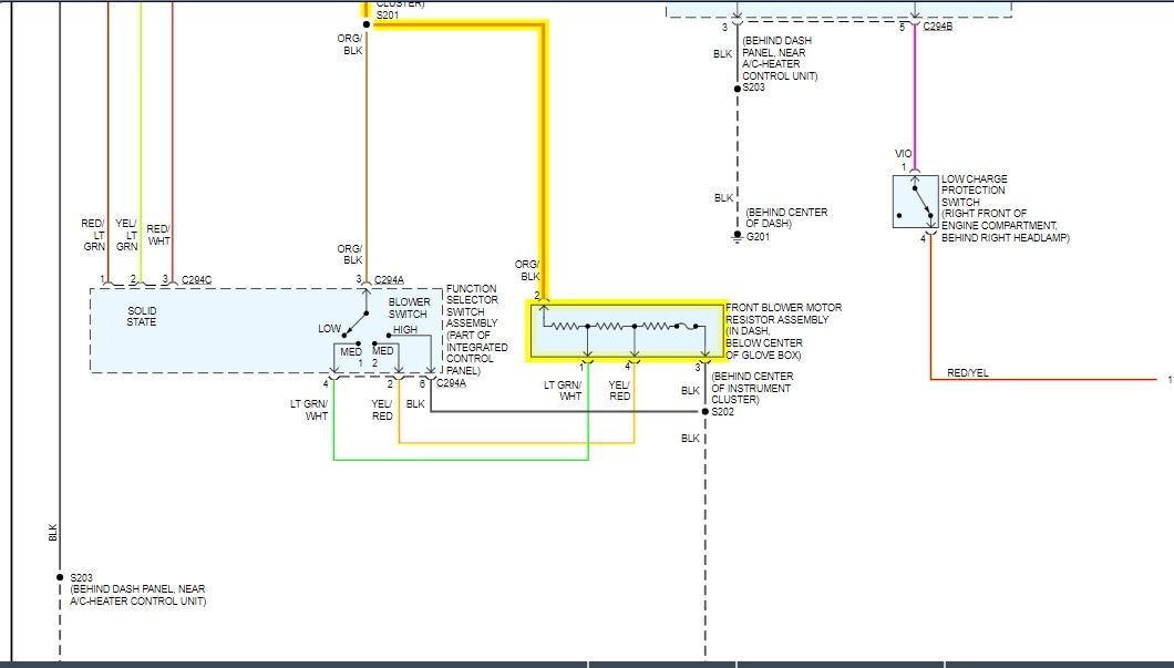

I attached a wiring diagram for you to view. Check both fuses listed for power to the blower relay. Then check for power to the blower motor itself.
In most cases, it is either the blower motor or the resistor that causes this issue.
