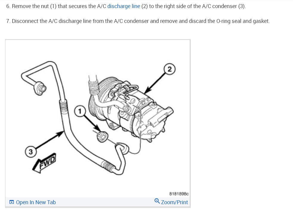

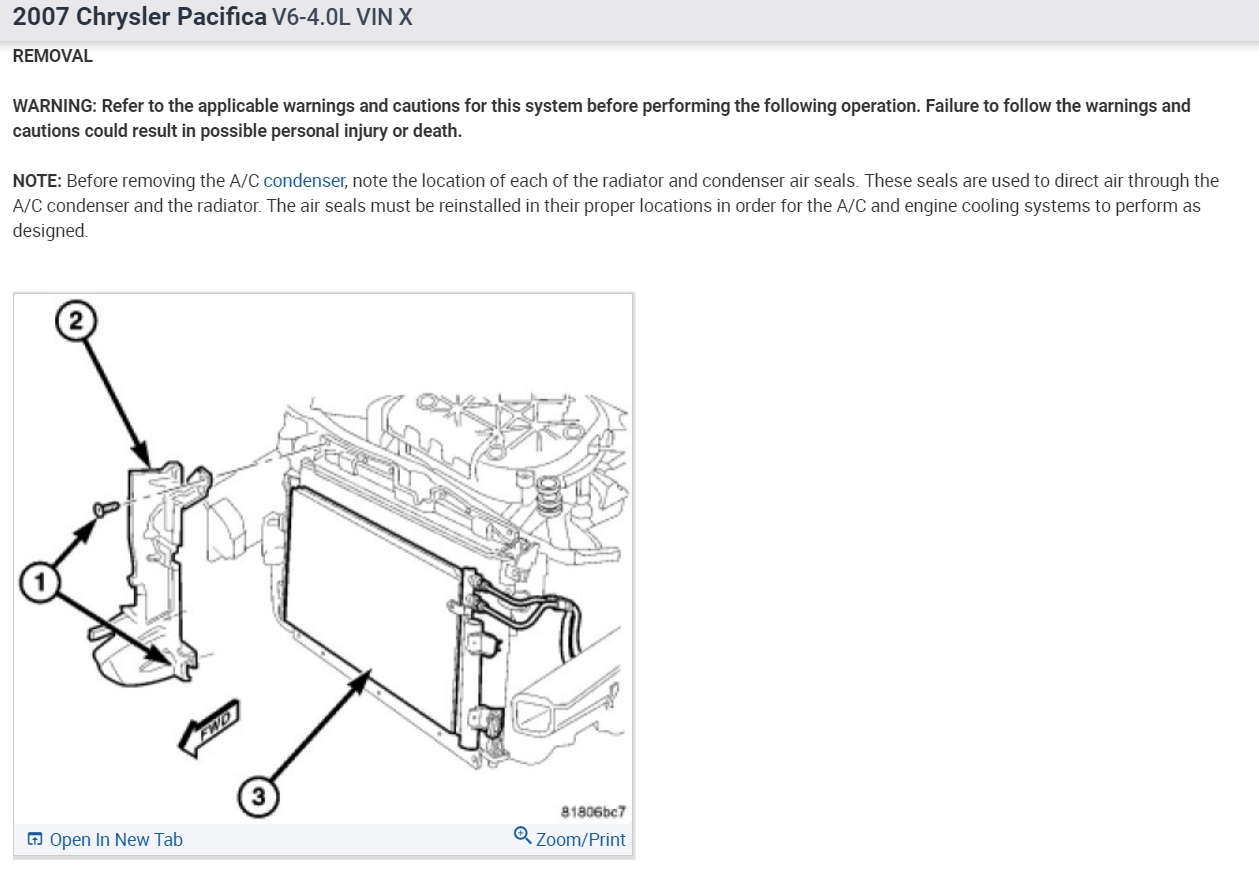

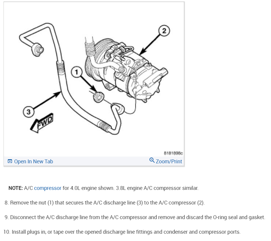

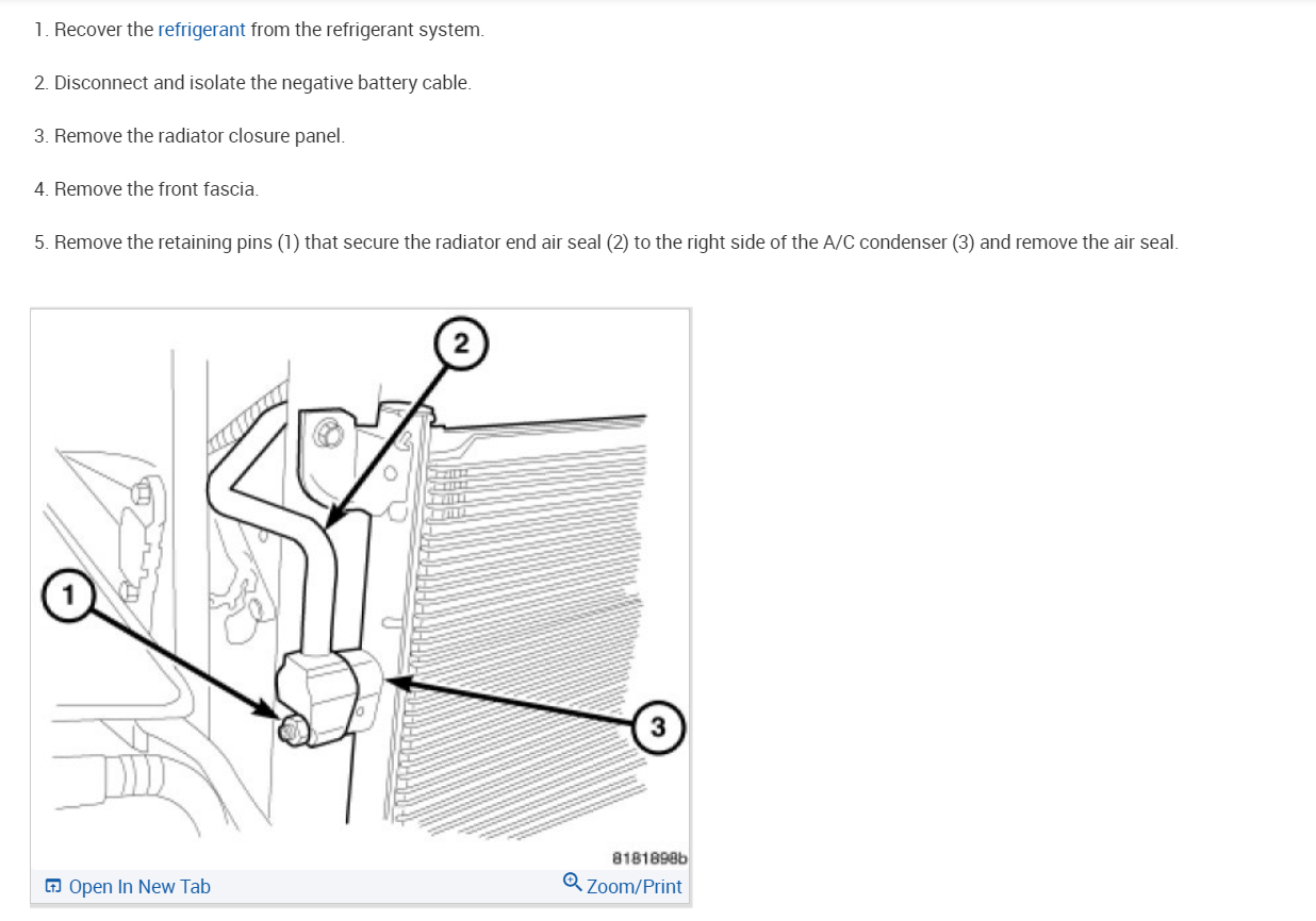

What needs to be removed to change the hose?
Jul 5, 2023 at 2:57 AM
  • 55,399 POSTS
The first thing you need to do is discharge the system. I would check out this video which will show you what to do:
https://youtu.be/4EqdrBVb0sY
here is how to change the low side hose/line out. Check out the images (below). Please let us know if you need anything else to get the problem fixed.
