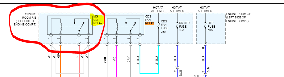

I am trying to find where the A/C cooling system relay is located.
Apr 17, 2023 at 12:03 PM
  • 110,244 POSTS
Looking through my manual, I can find the ac clutch relay in the under-hood fuse box, but when I look further, the manual doesn't provide locations within the box for relays.

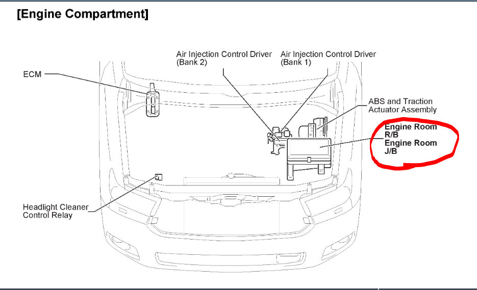

If you look at pic 2, it shows where the box is located. Remove the lid on the fuse/relay box and there should be a legend indicating what each fuse and relay is used for.
Let me know what you find.
