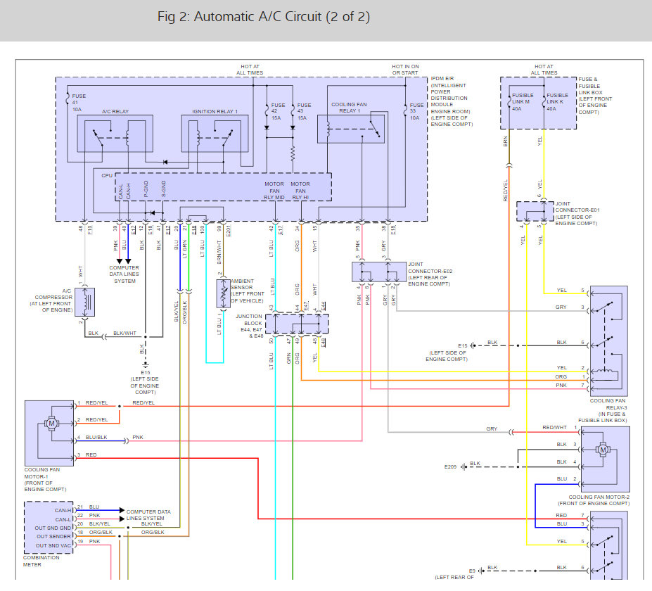

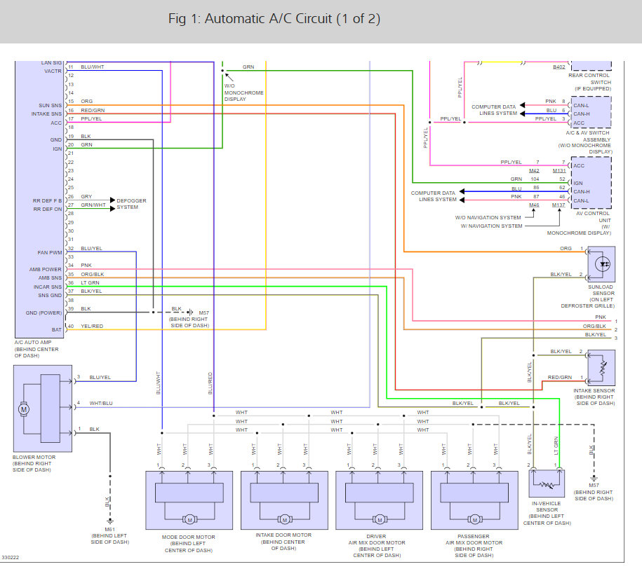

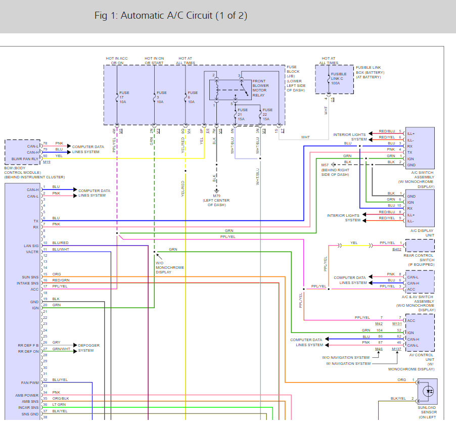

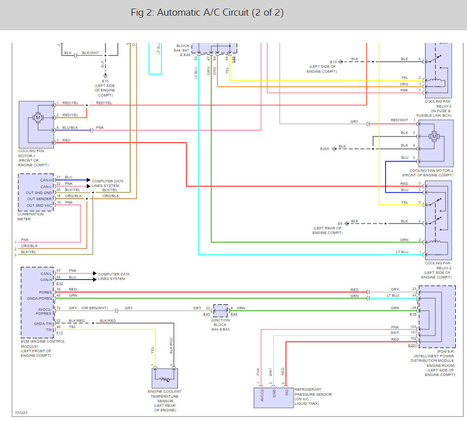

Replaced the A/C evaporator and returned all connections to the proper place. Now no A/C controls although it defaults to auto setting, 75 degrees and medium speed fan and is cooling. Radio does not work, but will beep when pushing eject button.
May 29, 2018 at 6:59 AM
  • 55,423 POSTS
Evaporator, good times. It sounds like you missed a ground wire somewhere. Here is a guide to help you test the grounds and the wiring diagram so you can see how the system works and what wires are the grounds:
Check out the diagrams (below). Please run some tests and get back to us.
