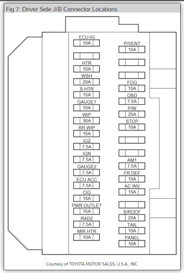

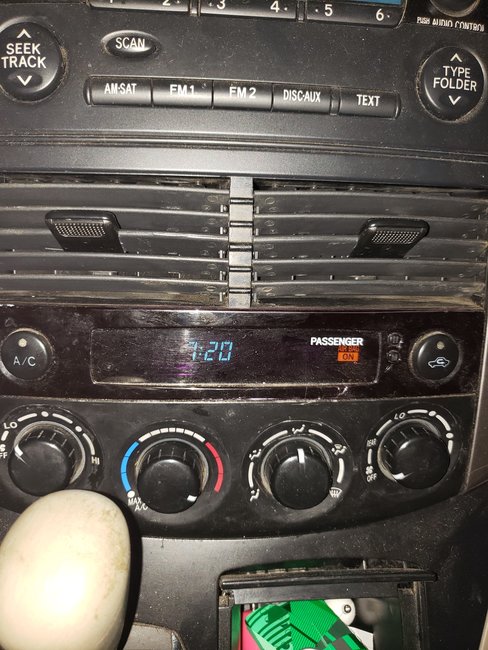

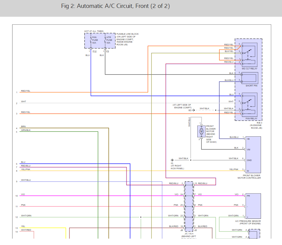

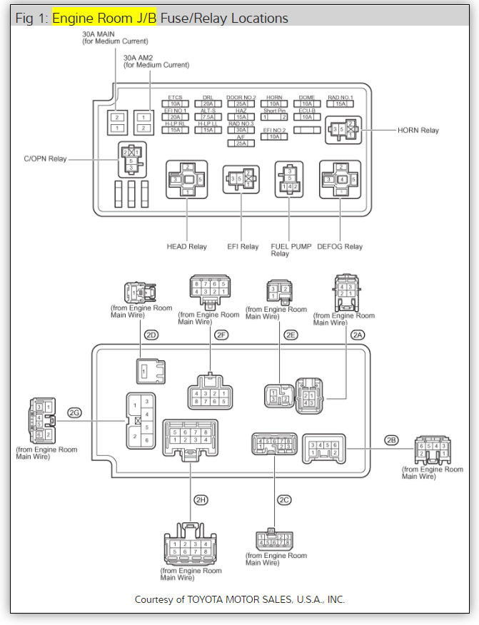

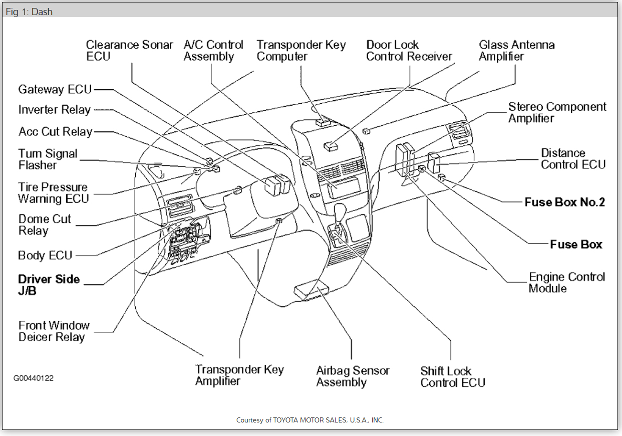

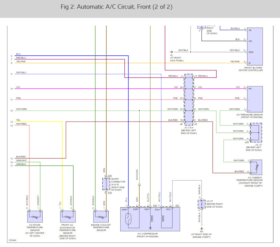

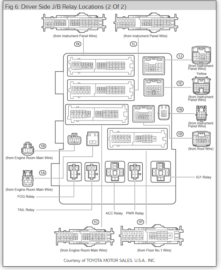

My A/C control panel does not light up and I cannot figure out where the fuse is or how to check the bulb. Help please
Oct 29, 2018 at 9:19 PM
  • 55,402 POSTS

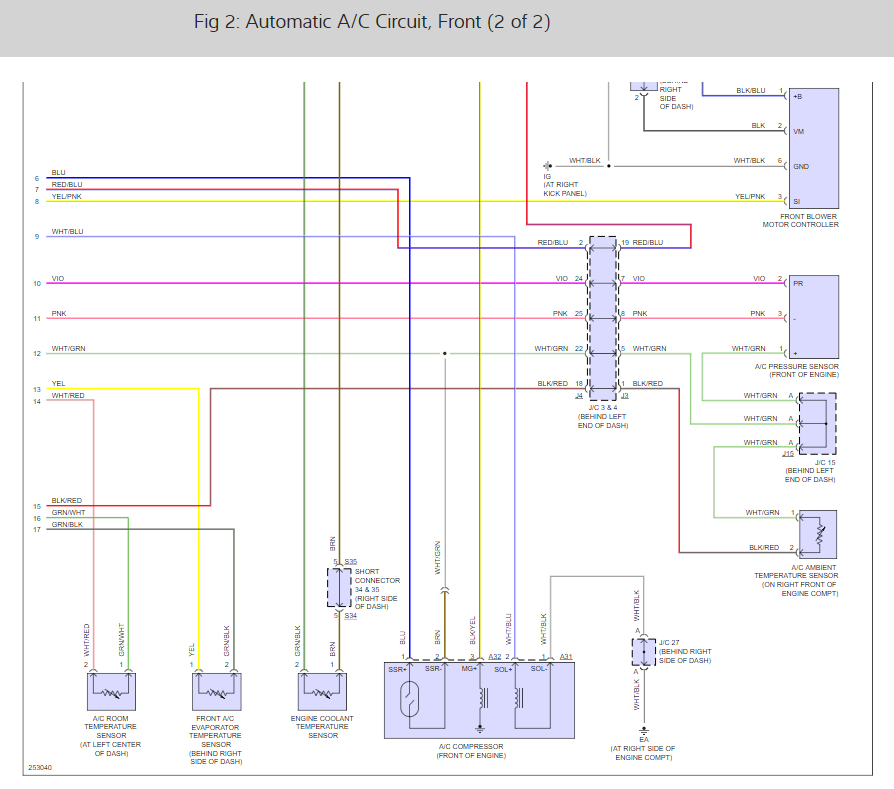

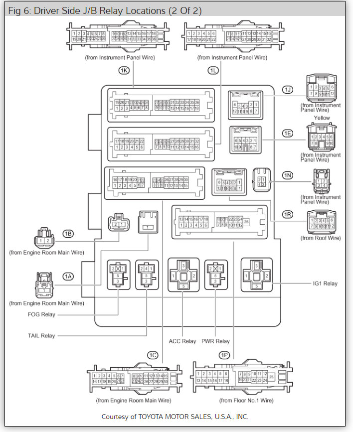

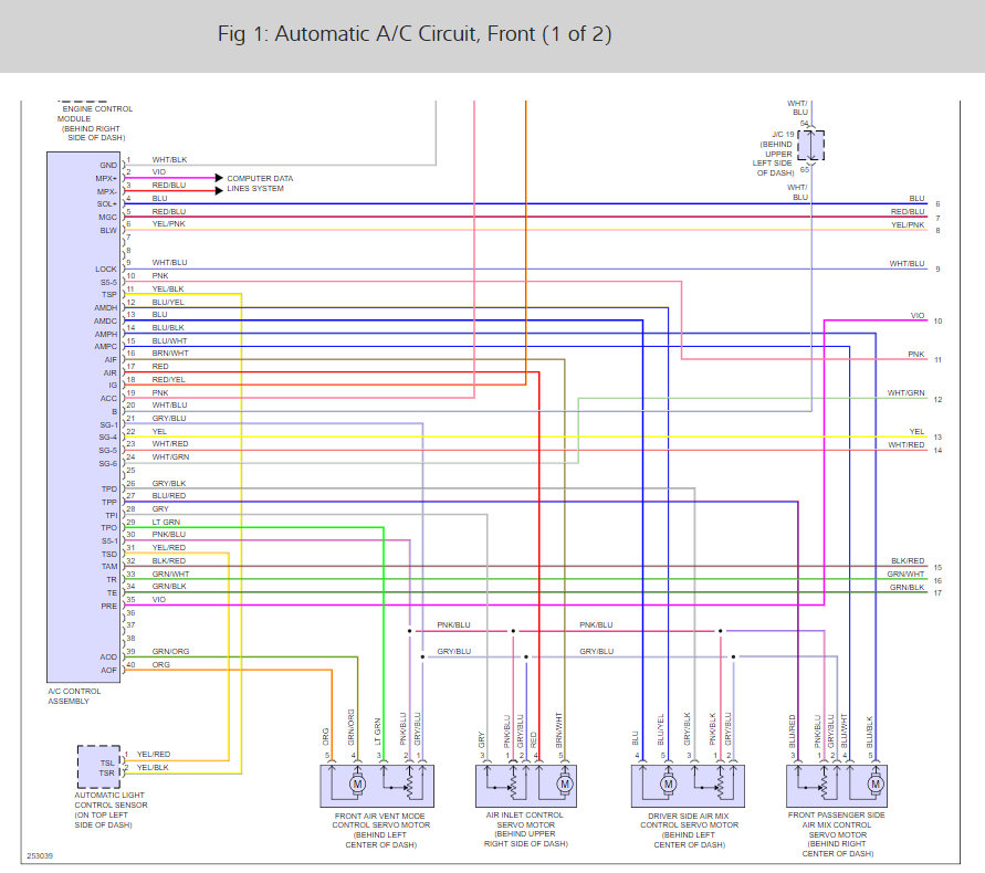

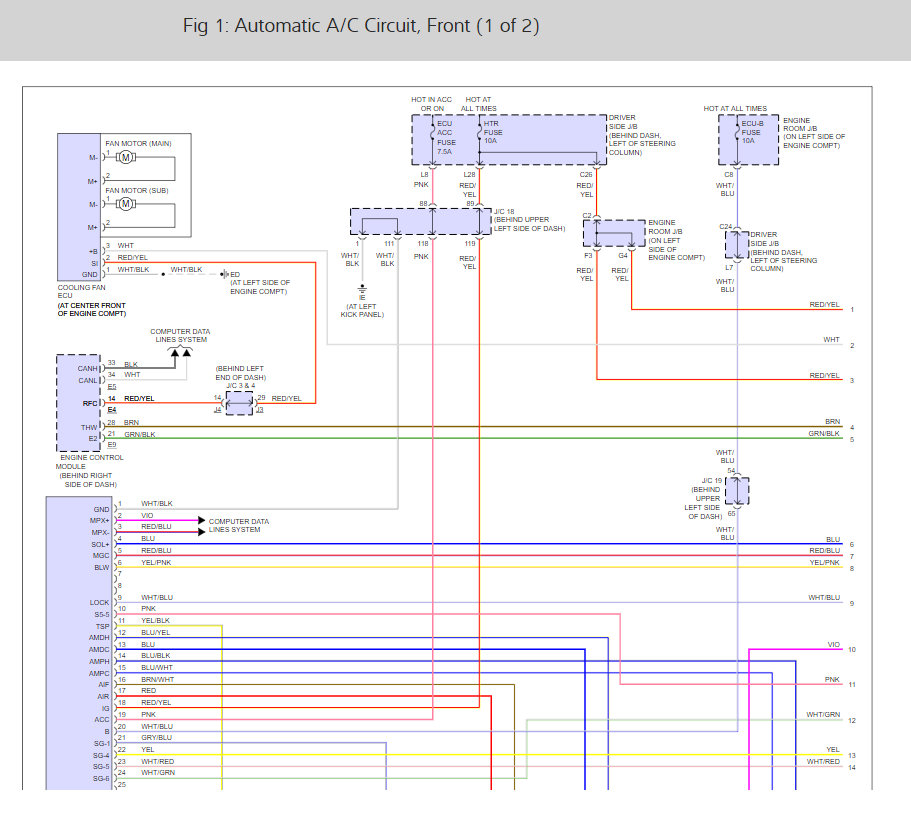

There are three fuses that run the system that we need to check for power. Here is a guide to help us get started with the air conditioner wiring diagrams so you can see how the system works along with the fuse locations below. Checks interior fuses, ECU ACC, HTR and engine compartment fuse ECU-B
