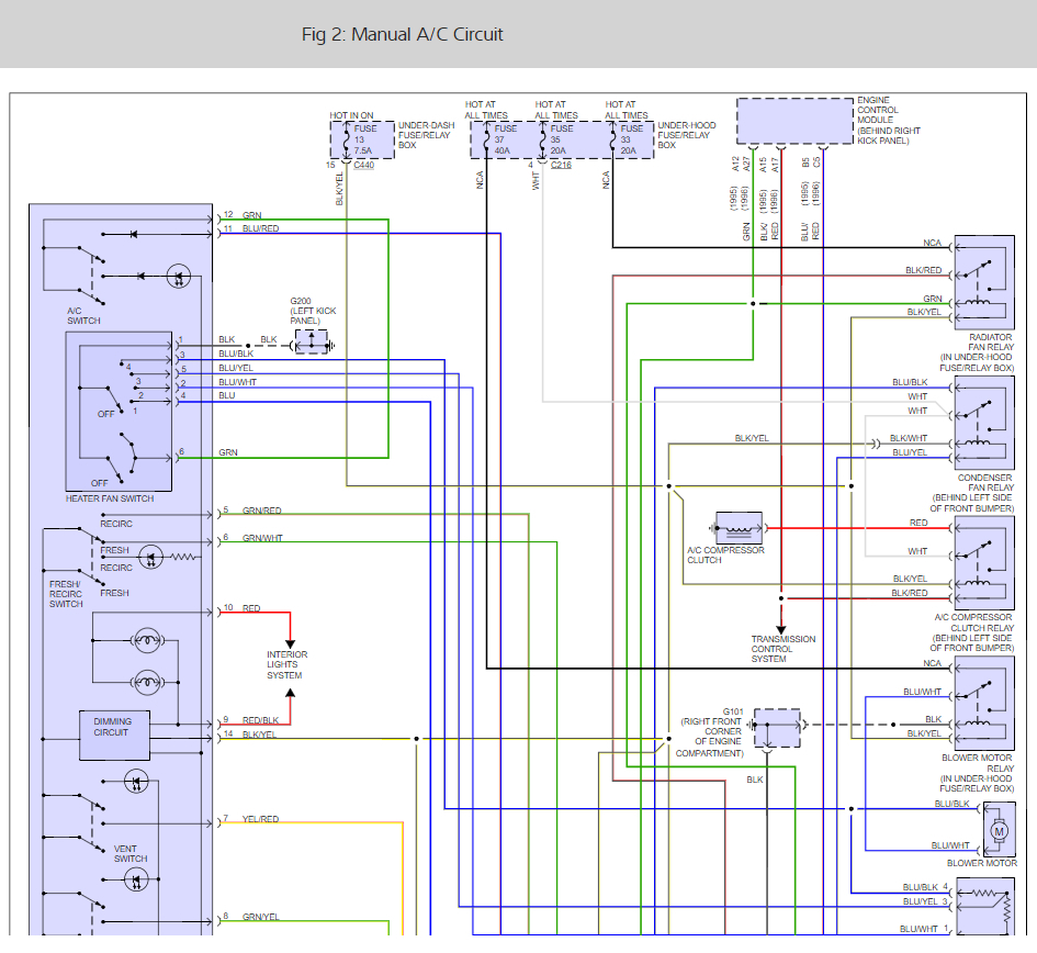

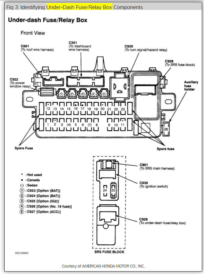

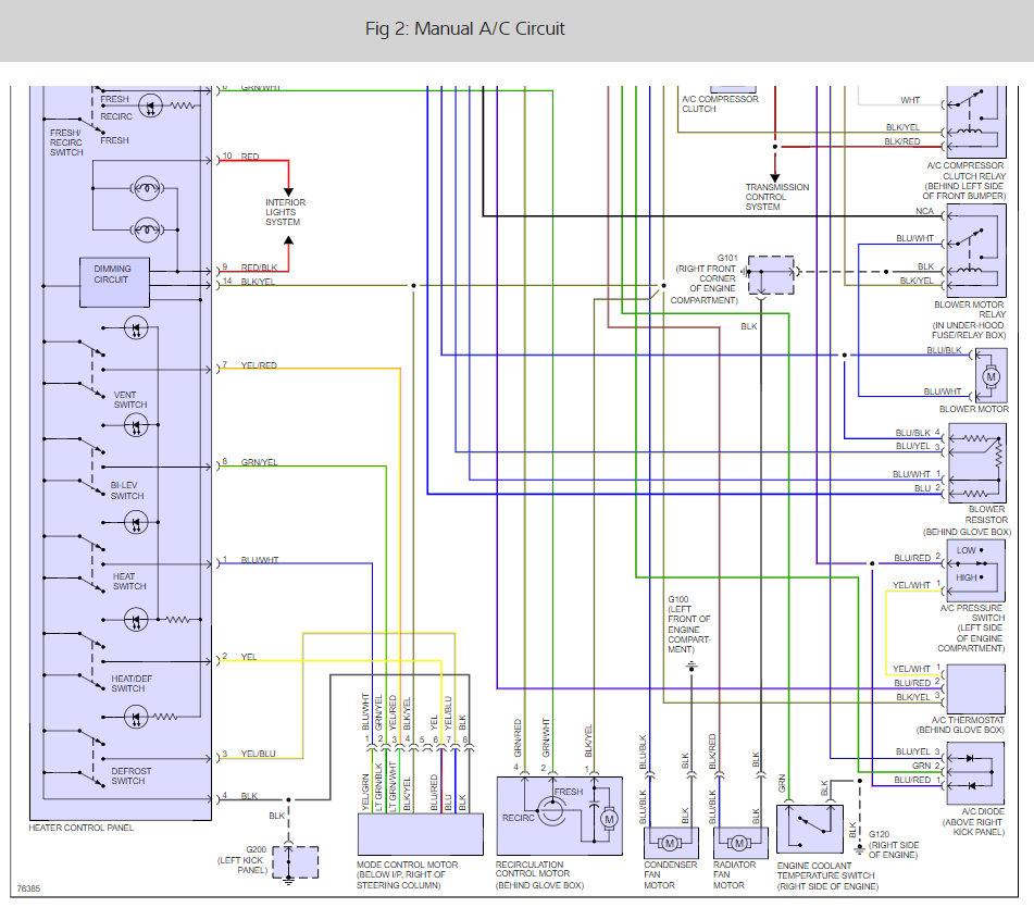

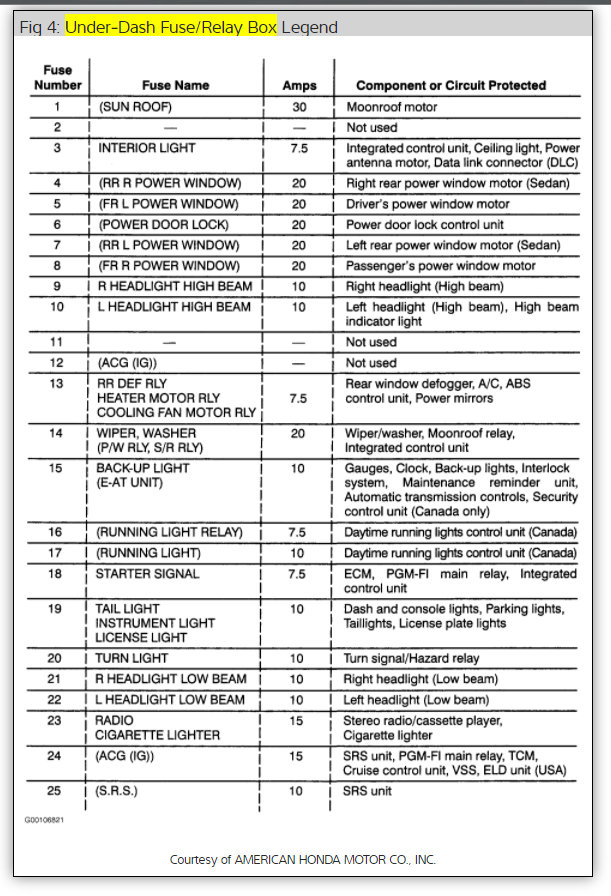

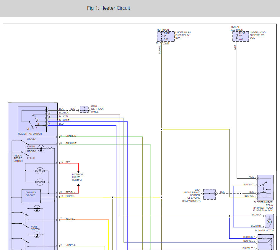

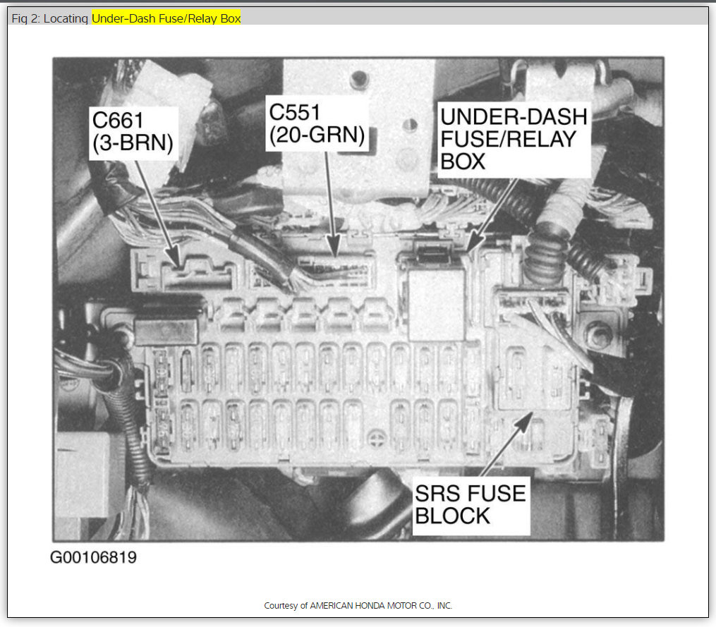

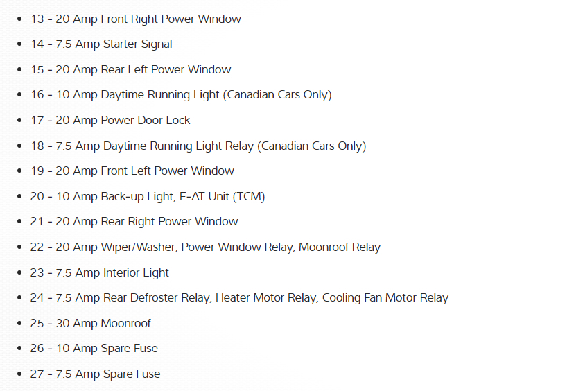

The A/C control button had no power. The fuses are good but no lights on button and no fan running. Any idea?
Sep 19, 2017 at 8:41 PM
  • 55,433 POSTS

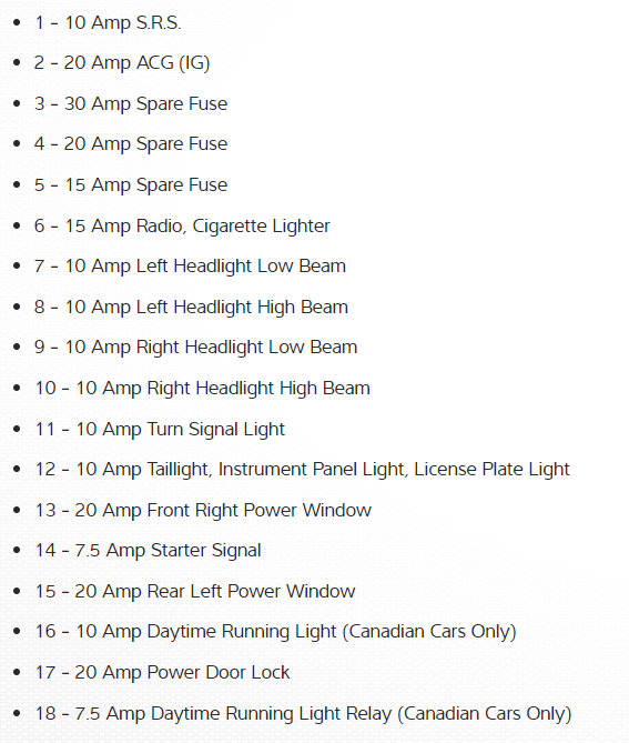

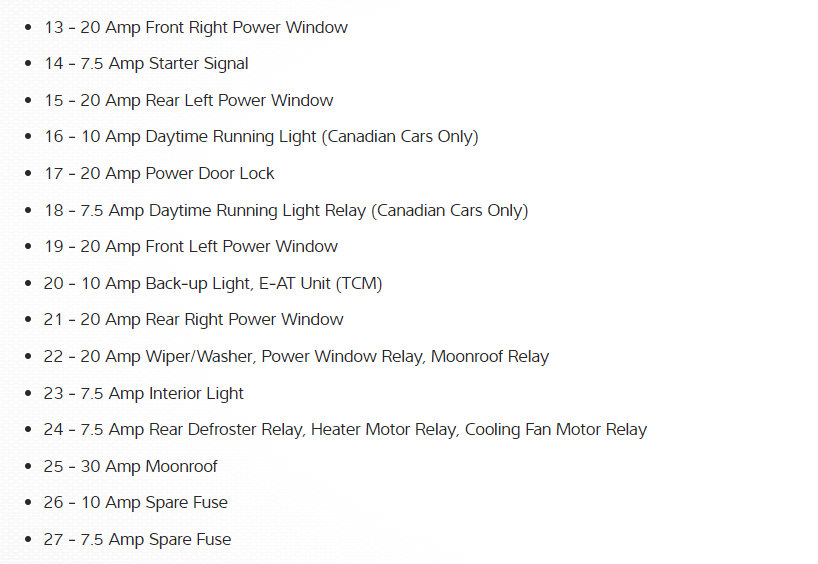

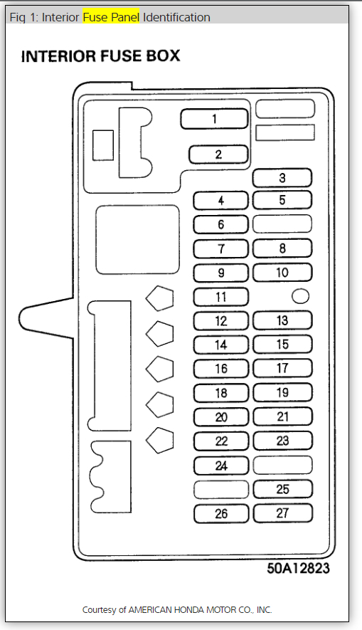

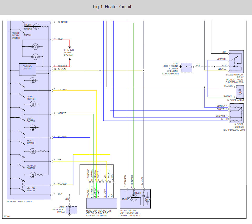

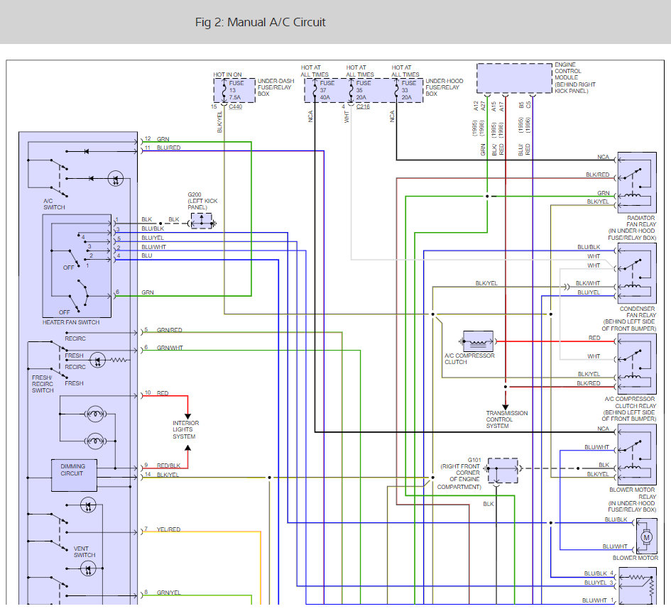

It sounds like you still might have a fuse out because there are several that run the system. If they are okay then there is a control relay that can be out.
Here are some guides and diagrams so we can do some simple testing and get the problem fixed:
and
and
Check to see where you lose the power.
