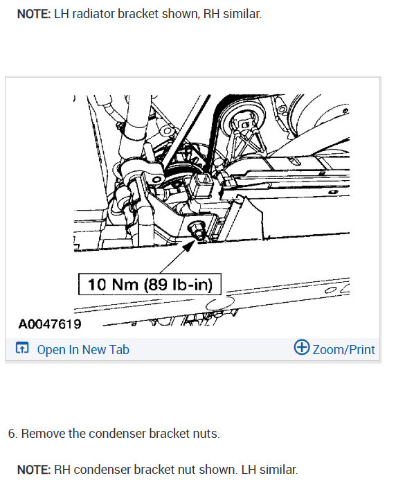

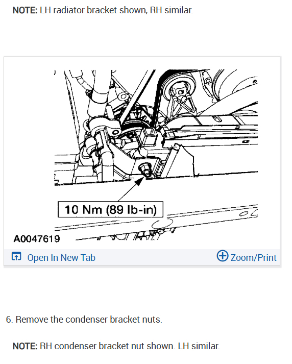

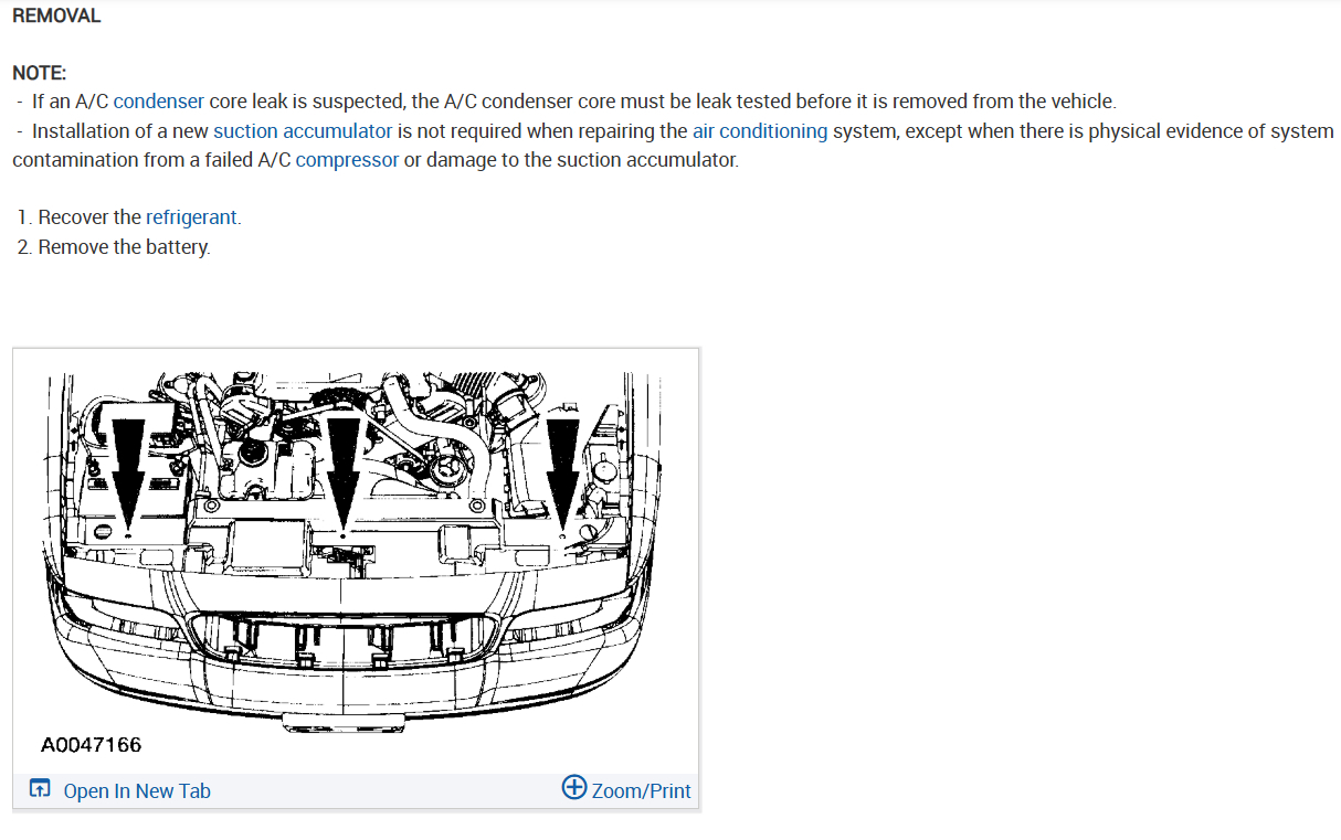

Purchased a replacement Condenser (#NC4011A)
How do I swap it out myself?
Thank you
Jun 9, 2025 at 6:05 AM
  • 55,433 POSTS

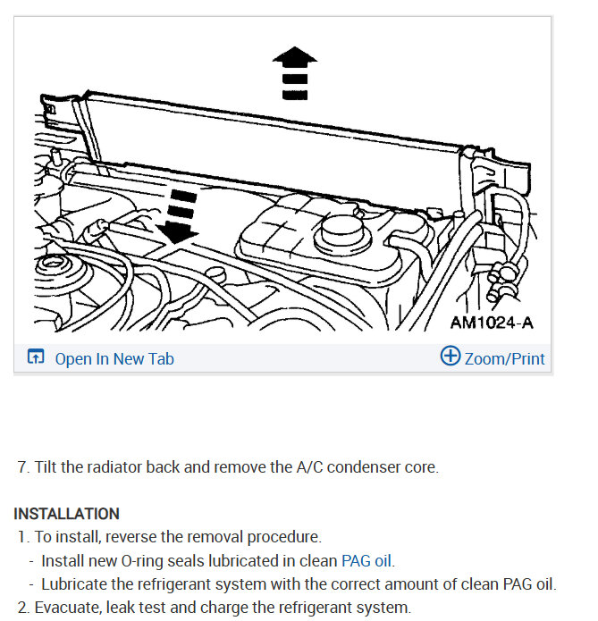

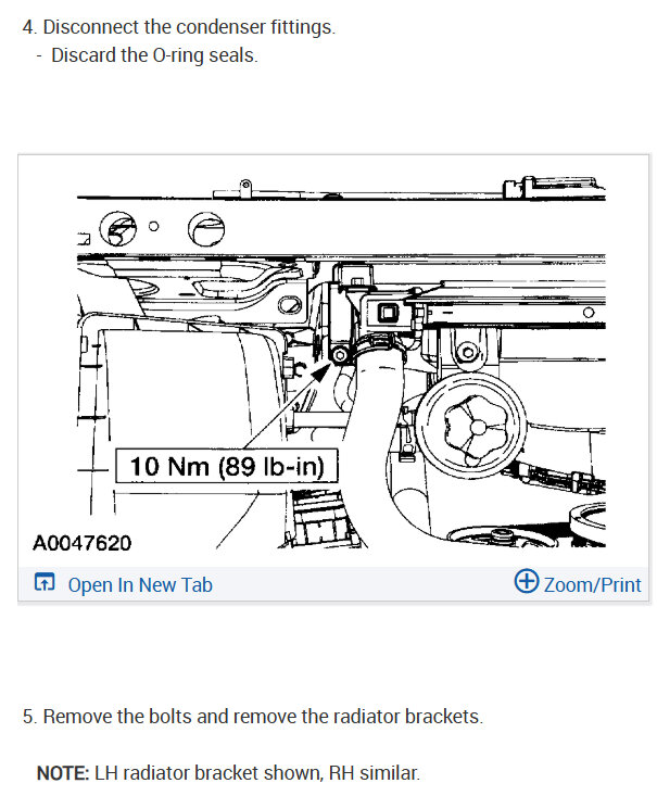

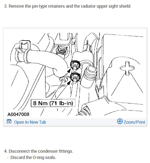

Alright! let do this, first you need to vacuum down the system and disconnect the battery. I would use a garden hose as well the hose off the radiator core which will help will air flow once the condenser is removed. Here is a video to help with the vacuum and recharge part.
https://www.youtube.com/watch?v=4EqdrBVb0sY
Check out the images (below). Let us know if you need anything else.
