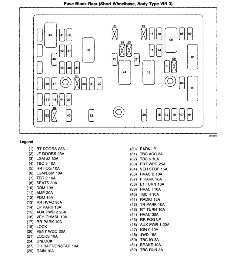

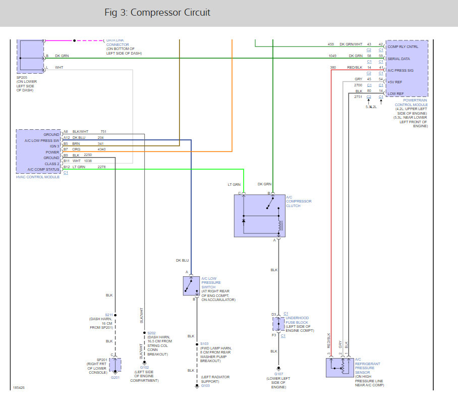

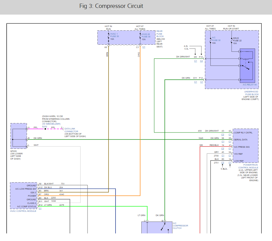

There is a fuse #30 (10 amp) in the under-hood fuse panel let's check it for power. here is a guide to help and the fuse location along with the wiring diagrams for the A/C compressor so you can see how the system works:

Okay, so lets pull the plug on the compressor and measure the voltage to the compressor with the system on it should be 12 volts. One wire will have no voltage. This guide can help you with the test.

Okay, here’s an update: I check the voltage on the plug at the compressor dark green wire has 14 V the light green wire has 1.12 V.
May 17, 2022 at 11:24 PM
CSUNDE1953
  • 13 POSTS
That's with the engine running.
  • 55,616 POSTS
Good job. Now let's check the ground circuit (black wire). It is connected to the body near the fuse panel. You can do an OHMs check. If this is okay, you got a bad compressor. Can I ask which brand the compressor is?
