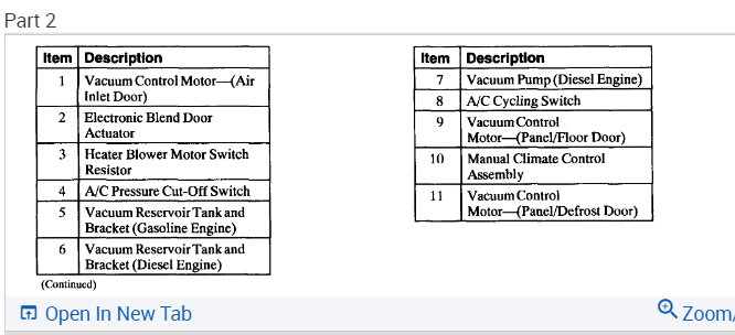

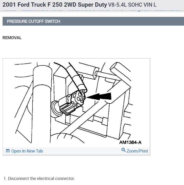

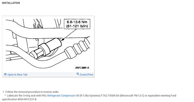

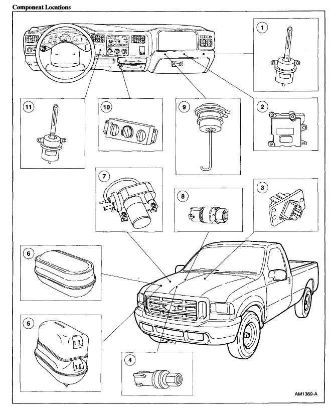

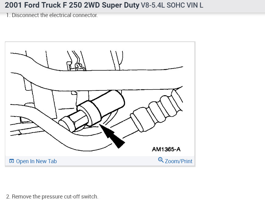

Here is the high side pressure sensor location in case you want to change it out. Check out the images (below). Please let us know how it goes.
