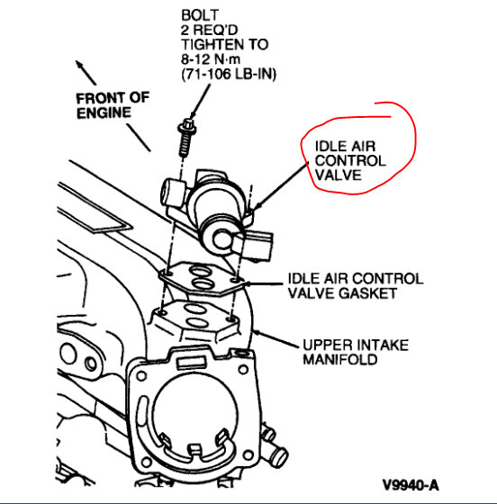

When the A/C is engaged, the condenser fan turns on. The load you feel is likely either the compressor's load or I guess it could be the fans, but that would be unlikely. If the fans are drawing too much amperage, it will cause a fuse to fail.
The correct idle speed should be between 760 and 850. The idea that it drops to 600 may be caused by the idle air control valve (IAC). The IAC is responsible for maintaining idle speed and is controlled by the PCM. When the added load of the compressor is placed on the engine, the IAC should adapt and maintain 760 to 850.
The IAC is mounted to the throttle body (see pic below). You may want to remove it and inspect where it attaches to make sure there isn't any carbon or dirt restricting airflow. If there is, here is a link explaining how to service it.
https://www.2carpros.com/articles/idle-air-control-valve-service
Let me know your thoughts.
See pic below
May 28, 2023 at 1:43 PM

The idle does drop to 600, or at least just above the 500 RPM mark. It's interesting to think it may be the IAC valve, because if I hold the gas where the car is staying at 800 RPMs or so, the compressor will never short cycle, and I've tested this by leaving my foot there for 30 minutes. I'll inspect this and see how it does.

Well, I cleaned the valve, and yes it was dirty, but it changed nothing. I still think it is significant that the fans cause a drop in RPM. Any other ideas?
May 29, 2023 at 4:53 AM
  • 55,433 POSTS
Even though the valve was dirty it could be not working as well, I would try a new valve to see if that fixes it.
May 30, 2023 at 2:30 AM
CANNON1349
  • 861 POSTS
Hello, sorry for the delay, I had to wait for a valve to be delivered. With the new valve, I haven't seen it short cycle yet. When the fan turns on the compressor does shut off strongly, but it doesn't short cycle. Rpms still drop a good bit when the fan turns on. Also notice the same drop when the blower motor is turned too high. But, nonetheless it is doing better than before as it seems to handle the rpm change better.

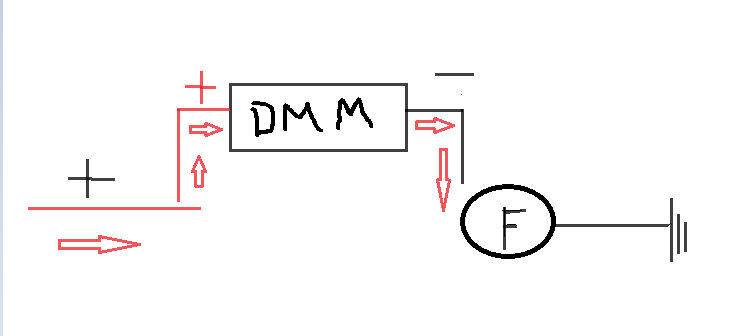

I am curious if there is an electrical test I can do for the fan, if there is a specific amount of resistance or if I can see if it is pulling too much voltage, however this car uses a 40A fuse for the fans so I would find it hard to blow.
Jun 8, 2023 at 12:59 PM
  • 110,244 POSTS
On most digital multimeters (DMM), there is an amperage setting. In this case, you would disconnect the power wire to the fan motor (gray wire with a red tracer) and use the multimeter as a bridge between the power supply and the fan motor. In other words, power would run from the wire into the + terminal of the DMM and then out the - terminal of the DMM to the blower motor. When the motor is commanded on, the meter will provide the amperage draw by the motor.
I drew a sad excuse for a pic below showing how the DMM is tied between the power supply and fan motor. No making fun. I tried. LOL
Let me know if this helps or even makes sense.
See pic below.
Jun 8, 2023 at 1:53 PM

Is it possible to do this with the DMM plugged into the fuse location? I don't have a key to push wire terminals out of the connectors.
Jun 14, 2023 at 12:47 AM
  • 110,244 POSTS
You can do it anywhere that is part of the power supply circuit. As far as pushing pins from the connectors, that isn't needed. Just use the DMM as a bridge.
