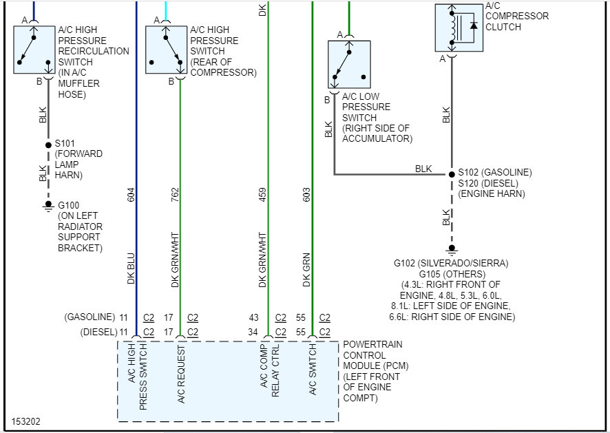

My entire A/C system was replaced last year by a local shop.
A year later i found the compressor running constantly even with the A/C switch off and not in defrost mode.
Also, it no longer cycles.
I read this may have a low Freon charge causing this to run but seems unlikely to me.
Do you have a wiring diagram for this model and some tips?
Thanks!

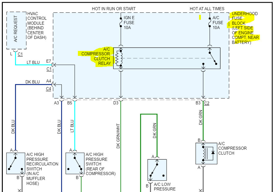

Neil,
Low Freon won't cause this. My first guess would be the compressor relay is stuck and needs to be replaced.
I attached the wiring schematic below. It was one page, but I cut it in half, so you read it. I did overlap the two so you can follow from one to the other.

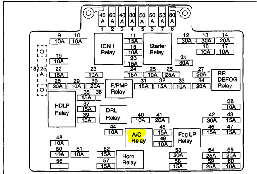

Here is what I need you to do: Pull the A/C relay in the under-hood fuse box. See if the compressor turns off. If it does, I would normally tell you to switch it with a different relay having the same part number. However, if I am correct and the relay failed internally, it will send power to whatever component you switch it with. So, let's just test the relay.
Here is a link that explains how it's done:
See pics below. Pic 3 shows the relay.

Hi Joe,
I swapped the relay with the horn relay - no change. I tested the compressor relay. It tested 89ohms across the coil 85/86 and open from 87/30 - okay.
The female pins inside fuse box with relay removed read:
85/86 had 13Vdc in three scenarios: with A/C button pressed, when in defrost, and when air flow is on recirculate.
The clutch engages and never disengages in those positions. Is this supposed to cycle on and off like newer cars?
I need to get a manifold to see what the pressures are at.
The LP and HP cutouts are working as intended.

When you checked 85 and 86 was the relay installed? If the relay was out, only one side should have had power. You also mentioned that power was there when the A/C or one of the other modes was requested. So, I'm not sure if there was power at any other time.
As far as it running at all times, the system should turn on when the high side pressure sensor signals a drop in pressure, indicating the compressor needs to run. So, in theory, you could be low on Freon.
Also, if the compressor clutch overheated, it could simply be stuck. If you remove the accessory drive belt, see if the pulley spins freely. Obviously, everything needs to be turned off for this.
You indicated the high-side pressure sensor is good. If neither the high side pressure nor the A/C clutch are an issue, chances are you have a short to power at some point before the relay which is causing the relay to stay energized.
Let me know if you are able to check the things I suggested.
