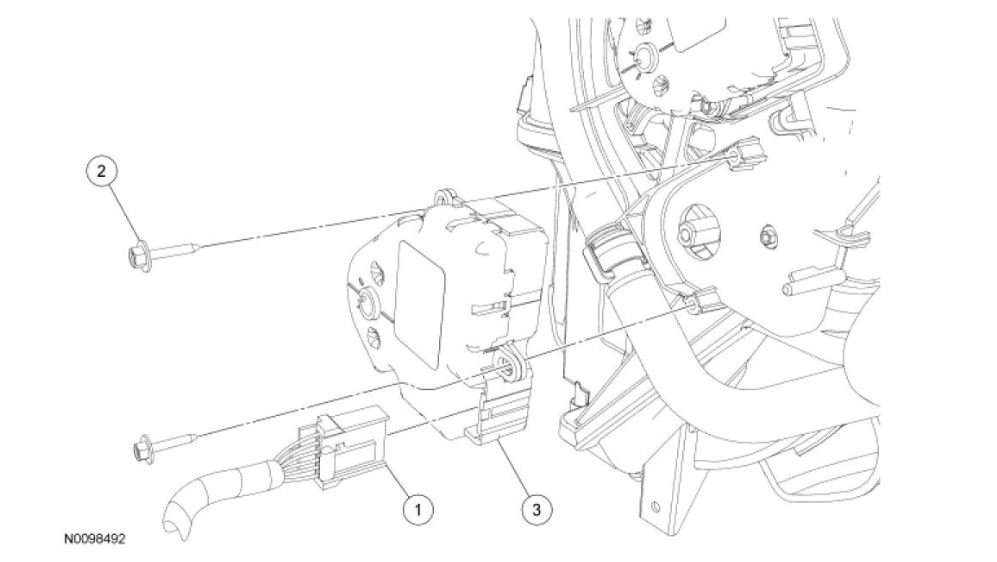

Good afternoon,
Yes, it sounds like a blend door motor.
I attached the procedure and some pictures for you to view.
Removal and Installation
NOTE: The LH temperature blend door actuator can be accessed from below the LH side of the instrument panel to the right of the accelerator pedal.
1. Disconnect the LH temperature blend door actuator.
2. Remove the 2 LH temperature blend door actuator screws.
3. Remove the LH temperature blend door actuator.
4. To install, reverse the removal procedure.

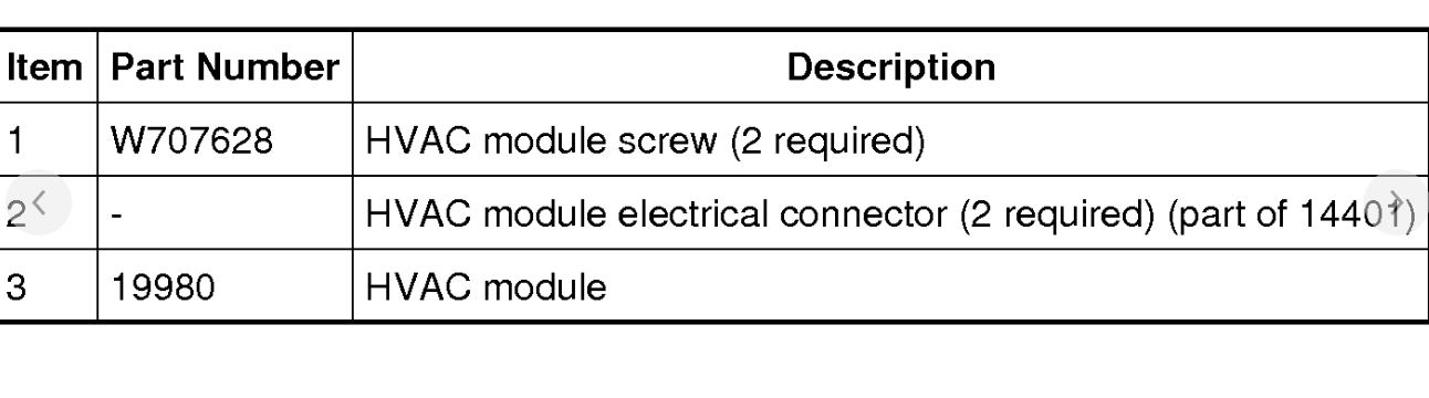

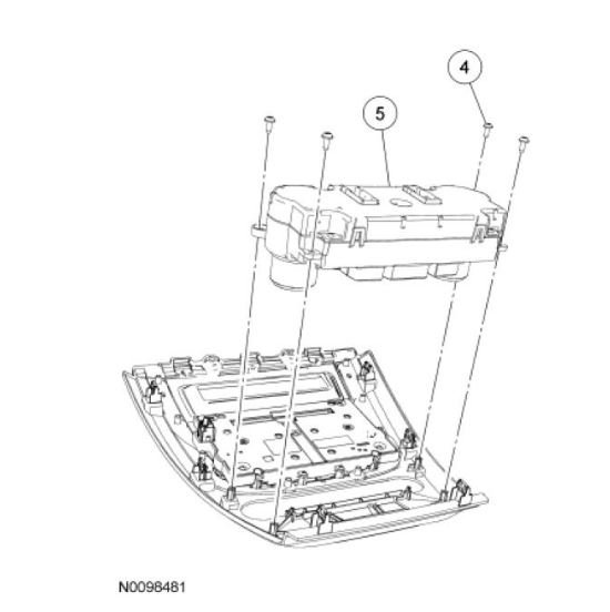

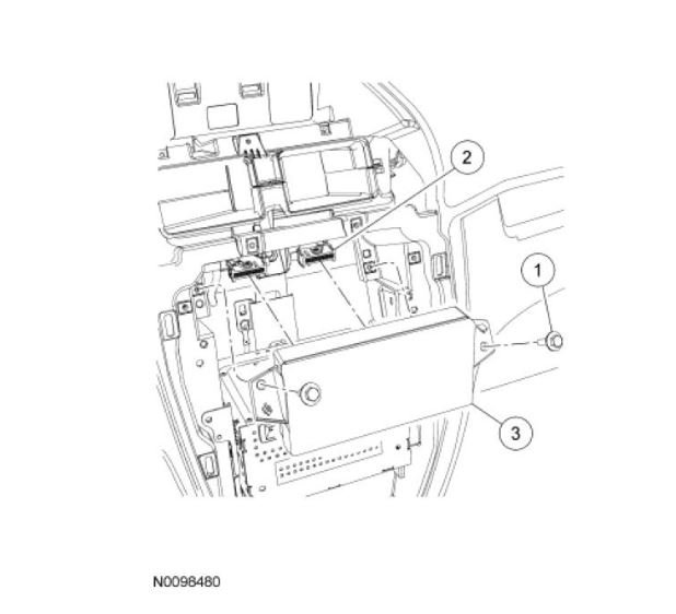

Okay, if the calibration did not work, it only leaves the control head.
Vehicles equipped with navigation system
1. Remove the Front Display Interface Module (FDIM). For additional information, refer to Accessories and Optional Equipment.
2. Remove the 2 HVAC module screws.
3. Disconnect the 2 HVAC module electrical connectors and remove the HVAC module.

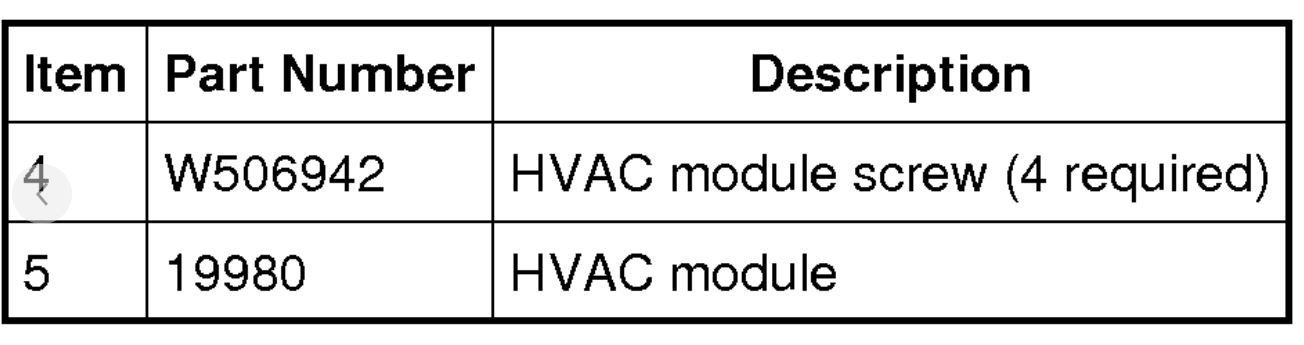

Vehicles without navigation system
4. Remove the center instrument panel finish panel. For additional information, refer to Instrument Cluster / Carrier &/or Interior Moulding / Trim.
5. Remove the 4 HVAC module screws and remove the HVAC module.
All vehicles
6. To install, reverse the removal procedure.
