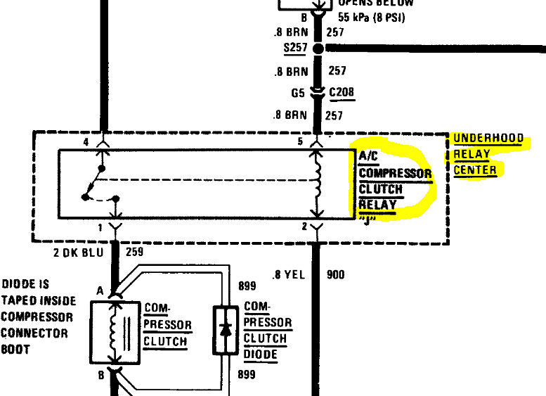

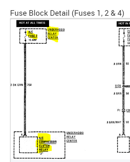

Where is the A/C Compressor Relay located?
1988 CADILLAC SEVILLE
106,000 MILES • 4.5L • V8 • 2WD • AUTOMATIC
EGGBEETER
I just replaced my A/C system and there are no F codes popping up. I need to know where the relay is for the A/C compressor. Preferably a picture.
Jul 4, 2023 at 5:21 AM
  • 110,244 POSTS
It is in the under-hood relay box. See pics 1 and 2 below.
For some reason, I'm not showing the fuse box itself. Take a look at the two pics I attached and let me know if they help.
