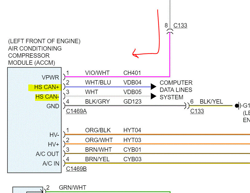

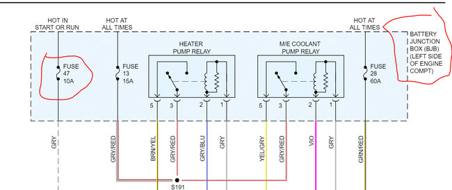

First, I attached a couple pics below. The first one shows a fuse that powers the AC compressor module. Check to make sure it is good. Also, make sure there is power to the fuse.
Next, I attached a pic that is from the wiring schematic related to the module I mentioned. I highlighted a couple wires that are high speed CAN. What I recommend is to have the vehicles CAN bus system be scanned. CAN stands for computer area network. The modules are all tied together. If you scan it, it should indicate where there is a problem.

Let me know about the fuse and if the scan is something you can do or have done.
Aug 7, 2020 at 2:36 PM
LUAI AL FANATSAH
I already check that fuse and i checked again and found okay. also i checked the car using computer and i did not get any fault or error.
