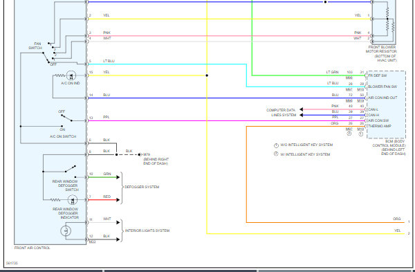

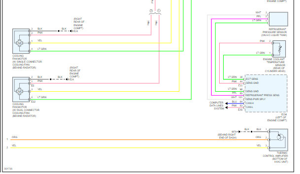

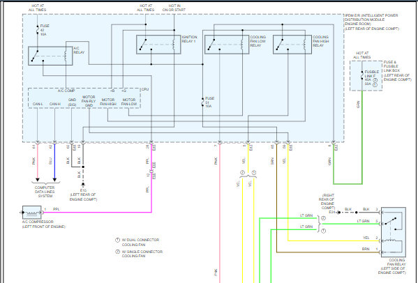

Compressor is not kicking on. Checked the fuse and it is good. I couldn't find a relay for it. I jumped the low pressure sensor to see if that was the problem but still no voltage. I wired the compressor directly to the battery and it kicks on. Maybe a wire diagram could help me pint point the issue?

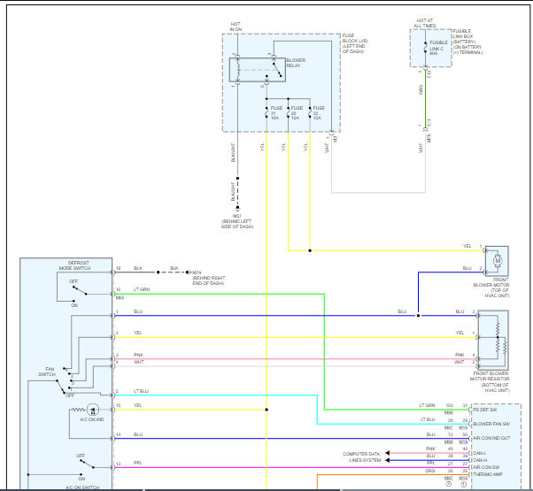

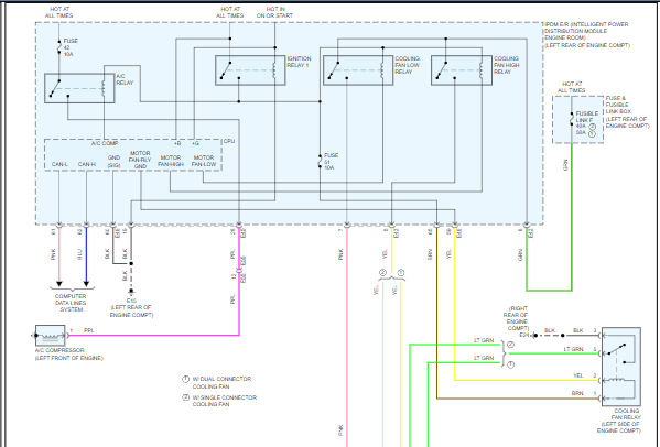

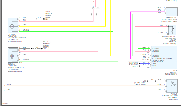

I've attached the A/C system wiring diagram below that you requested. I've cut both pictures in half so you can view larger.Hope this helps and thanks for using 2CarPros.

Thank you. Turns out the the low pressure senor is getting voltage but only 5v. is that enough for it to operate properly?

Just curious.Has the A/C system been worked on previously? There is a cut-out switch within the system to shut off the A/C compressor if low refrigerant is detected to prevent damage to the system until proper level is restored.Just wondering if you might have a leak in the system.I'll get the low pressure sensor voltage value for you.Hope this helps and thanks again for using 2CarPros.
