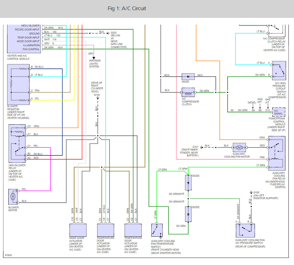

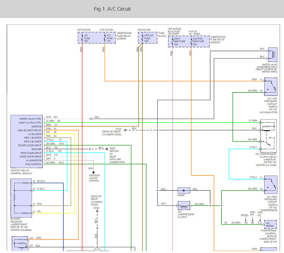

It sounds like you have some wiring that is crossed or something.
Here is a wiring diagram (below) that will help you get the problem fixed:
Friday, April 30th, 2021 AT 12:37 PM (Merged)

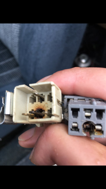

DANIEL HOLLAND
  • 7 POSTS
This clip or plug that was in the dash right above the ashtray area what's the problem for the short is the reason I was not getting power replaced connected heat air module and now the lights are flashing like it's in the default mode so I cannot tell if the AC works or not I disconnect the battery reconnect the battery and everything is fine till I push a button I research this and a lot of people say that it was low low pressure on the compressor so I buy refrigerant put refrigerant in and I'm still seeing no difference any help would be appreciated thank you
KEN L
  • MASTER CERTIFIED MECHANIC
  • 48,363 POSTS
O man, that is burnt up which is caused by the blower motor or relay pulling to many amps, try connected the wiring directly and disconnected the blower motor to see if the system powers up.
Thanks for the pic, it really helps.
