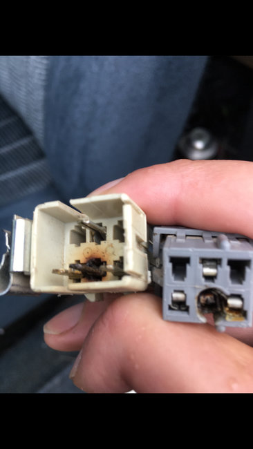

DANIEL HOLLAND
  • 7 POSTS
This clip or plug that was in the dash right above the ashtray area what's the problem for the short is the reason I was not getting power replaced connected heat air module and now the lights are flashing like it's in the default mode so I cannot tell if the AC works or not I disconnect the battery reconnect the battery and everything is fine till I push a button I research this and a lot of people say that it was low low pressure on the compressor so I buy refrigerant put refrigerant in and I'm still seeing no difference any help would be appreciated thank you
Apr 30, 2021 at 5:37 AM (Merged)
  • 55,402 POSTS
O man, that is burnt up which is caused by the blower motor or relay pulling to many amps, try connected the wiring directly and disconnected the blower motor to see if the system powers up.
Thanks for the pic, it really helps.
DANIEL HOLLAND
  • 7 POSTS
I checked the relays and all make the clicking noise and have resistance of 76 on them all have power I pulled the heat AC fuse while the truck was turned on and replaced it to reset the AC heat control module and it still doing the same thing I will pull the blower motor connector tomorrow and see if that has anything to do with it I can hear The blower motor kick in on high-speed but it seems like it's on very low I cannot test my AC because of the flashing but I can hear my compressor kick in and out every five seconds
  • 55,402 POSTS
Disconnect the compressor as well to see if the system starts working.
DANIEL HOLLAND
  • 7 POSTS
Ok I unplugged ac and blower motor and still same thing. the blinking it can't be the control unit cause I have 2 of them and they both blink not sure what the deal is this on is gonna be for the vintage Record books once we figure this out
  • 55,402 POSTS
Yep this is a good one for sure lol. Can you check the black wire to the controller to make sure it is grounded?
