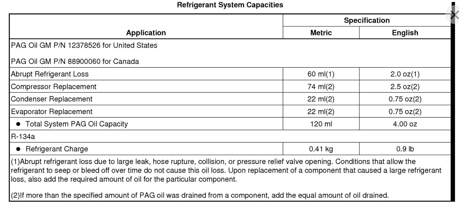

You need to test both the high and low side pressure for the static test.
With 110 degrees, the 100-pound reading was spot on. When you bled off pressure, the system is now low in freon. You need to recover the rest and evacuate and charge the system to the exact spec. I attached the spec for you below.

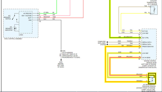

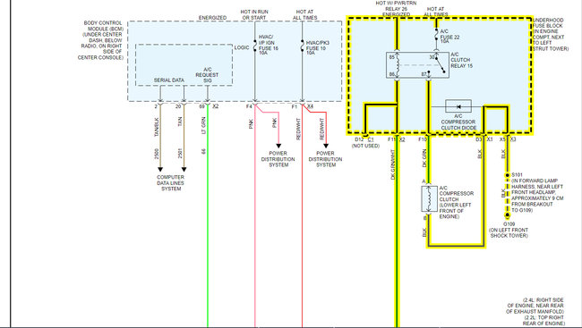

As far as the compressor not coming on, I attached a wiring diagram for you to view. This could be the relay, the compressor, or the pressure switch causing this issue.
Check the relay for 2 powers with the key on. The relay will close when it gets the correct signal from the pressure switch.

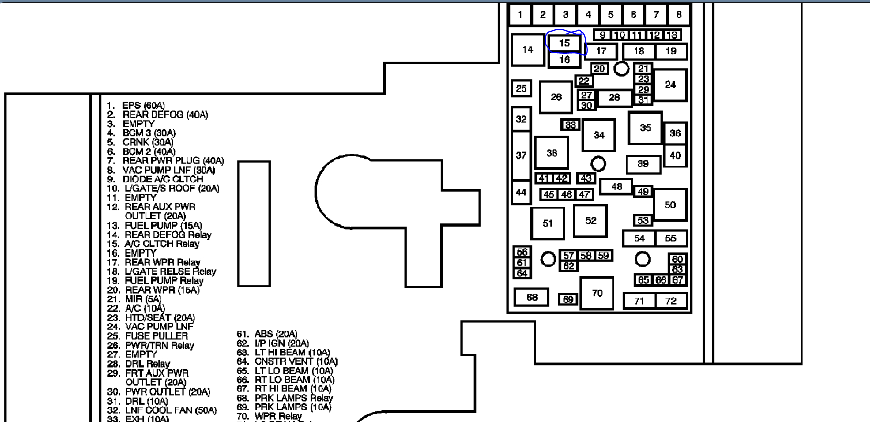

Ended up being a relay under the hood. just swapped it with another relay that was the same (in this case it was the DRL relay) when I started it the lights didn't come on , but the A/C compressor did. problem solved.
Was surprised the underhood fuse box was completely labeled , I think there were 60 all total ... So many cars I run into just have numbers , without telling you what they are.
