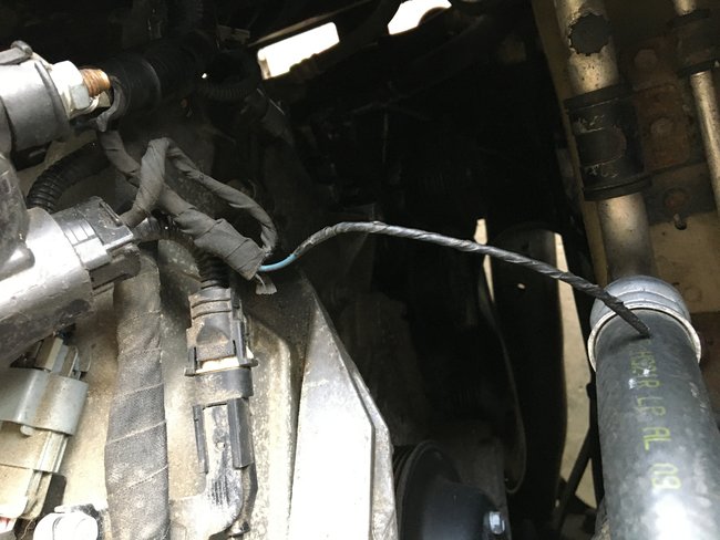

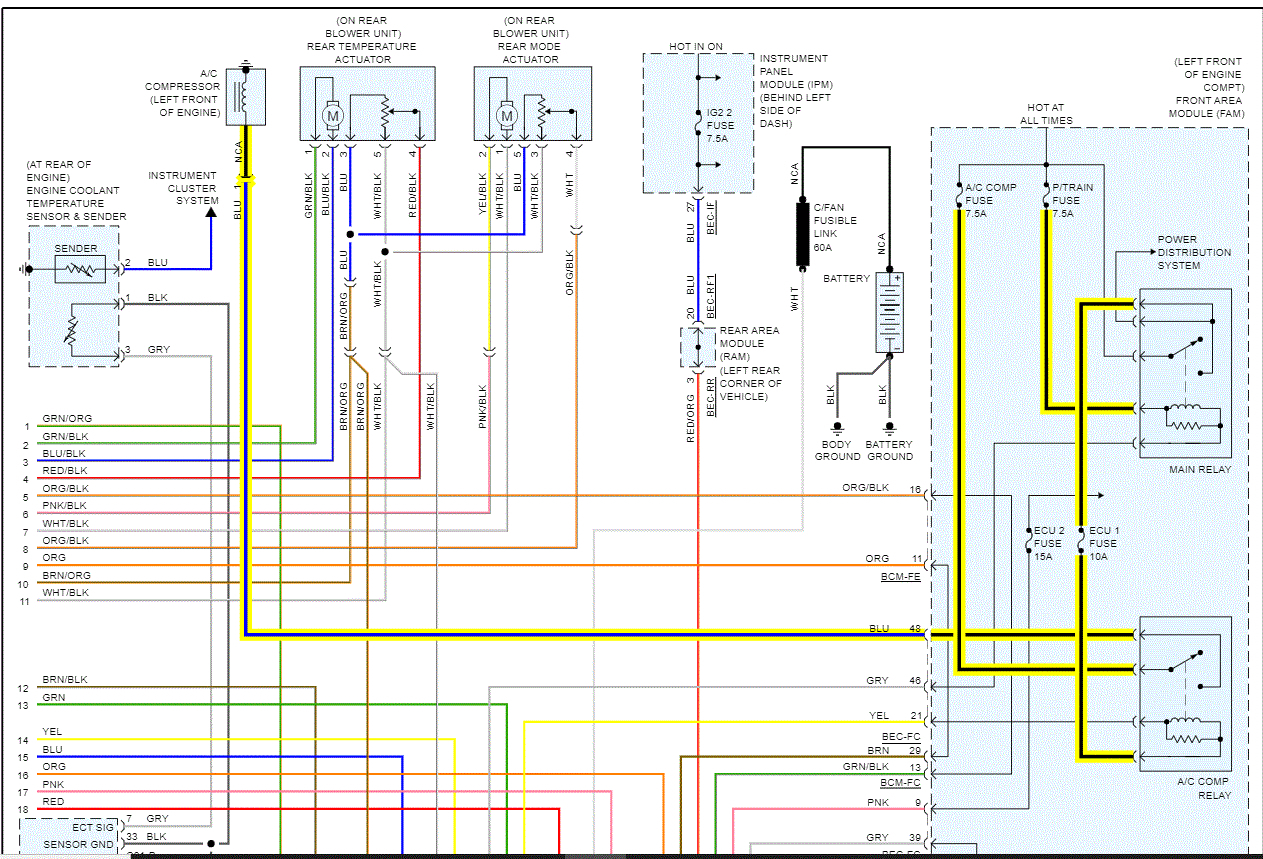

I broke the compressor connection wire. It is attached to the alternator wiring harness and connects to the compressor. This part is really expensive, $79.95. Do you have a diagram of this to make sure I am ordering the correct part? Thank you

The A/C compressor gets its power from the compressor relay. Take a look at the pic below. What has been cut?
Let me know. If possible, take a pic of what has been damaged and upload it for me to see. Additionally, identify the wire colors in the harness.

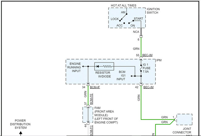

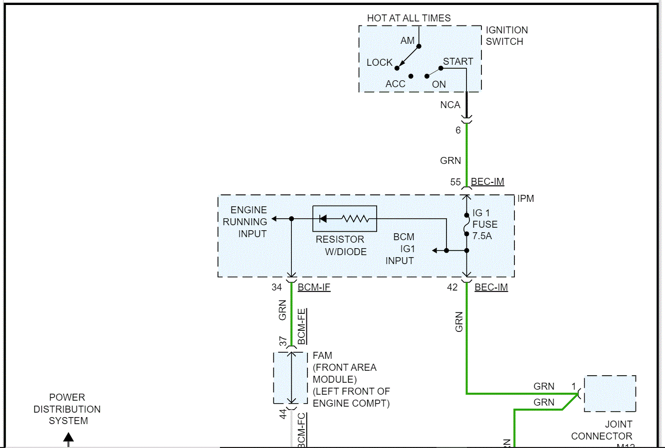

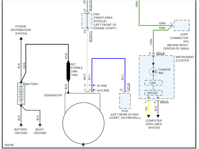

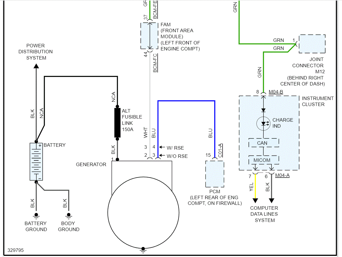

Pics 2 and 3 are of the charging system. See if you notice anything that you are seeing on your vehicle. Note: I had to cut the pic in half to make it readable. I did overlap them so you can follow from one to the next. I don't see anything related to the compressor.

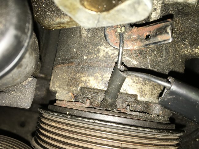

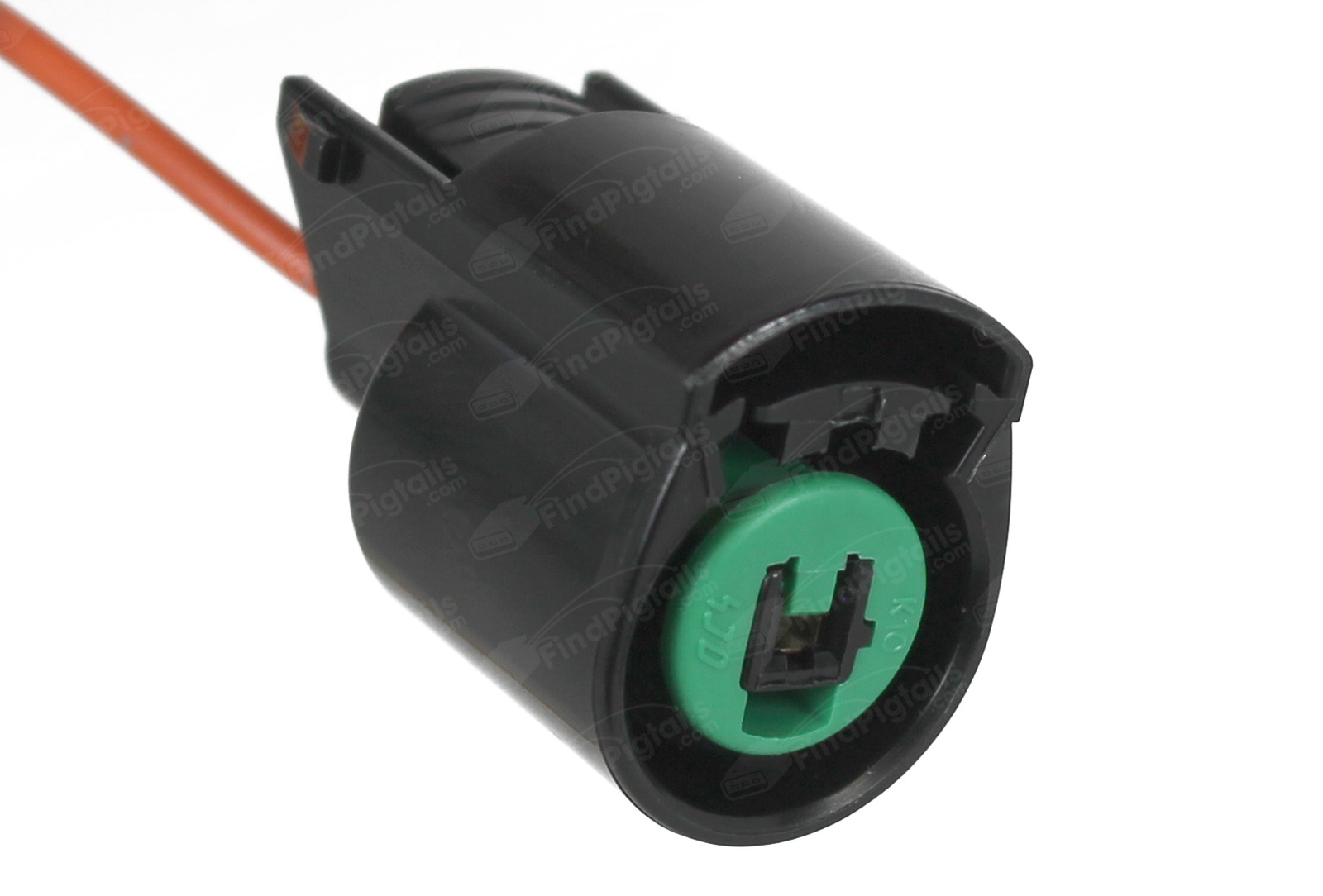

Pics.
Thursday, April 14th, 2022 AT 3:31 AM
MARK CAVINEE
  • 36 POSTS

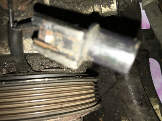

Pic.
Thursday, April 14th, 2022 AT 3:42 AM
  • 109,885 POSTS
That is the single-pin connector at the compressor. It appears you have the correct part. You may be able to just purchase the connector and then rewire it. That would be less expensive than replacing the harness.
