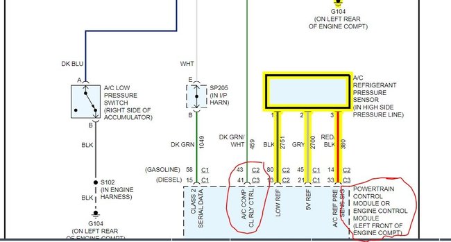

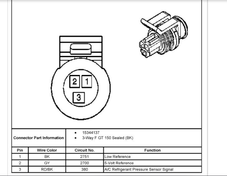

Looking at what I believe to be a wiring diagram for this truck, it indicates that there is a diode in the mix. Mechanic kept referencing a "module" that may be the culprit.
I haven't done a continuity test between the compressor and the relay yet but need to find this diode and two, what module is this being referenced and where is it?

I attached a wiring diagram for you of the A/C system. You need to go to the relay and test for 2 powers with the key on. The control side will ground and energize the relay when it sees the correct signal from the pressure sensor. The engine ECM controls that operation.
The diode is part of the clutch in the compressor.
It looks like you may need to replace the compressor if you power there when the command from the control head.

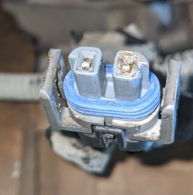

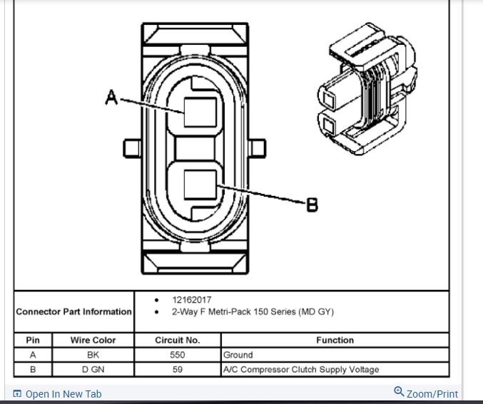

Not sure how this happened but may have been the result of using the thermal fuse. I'm picking one up today on the way home, hope to get it replaced and then I'll be checking the lines with the diagrams you provided. Photo attached of the plug on the compressor.
I also updated my description to give you a bit of background as well.
John
May 3, 2021 at 11:28 PM
That is one corroded connector. Clean up the terminals.

The picture of the connector, while there may be some corrosion there, the biggest damage is, it's melted and may not allow for proper mating but I'll get to that after I confirm the wiring diagram first.

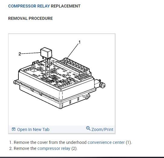

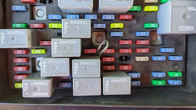

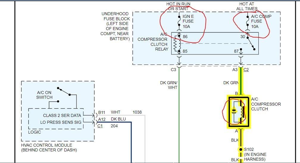

On the diagram, A/C Compressor Clutch Relay, IGN E fuse 10A, not finding it. I see the relay and the A/C compressor fuse but not the IGN E fuse. I'm attaching a diagram from under the cover and maybe I'm overlooking it?
On the A/C compressor fuse, I do have 12 .5 VDC on the one side. I just need to find the other fuse, unless it's labeled different?

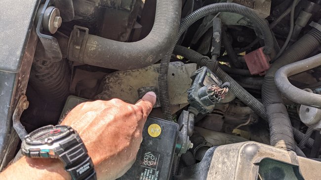

I'm also attaching a picture with me pointing at what I think is the under hood engine control module, on the left front side of the engine compartment, next to the battery and fuse box?

Never mind, found the fuse. I'll let you know...

Okay, tested for the 12~14 volts on the two fuses. Present. I'll have to check next if the voltage is getting to the plug at the clutch.
Am I to understand that when the ECM detects the signal that the A/C in the cab has been turned on, it supplies the ground to the relay so that it will engage the clutch?

Yes, once the ECM sees the correct signal from the pressure sensor, it will ground the control side of the relay and energize the relay sending power to the compressor.

Got under the truck and disconnected the plug at the compressor. Had my wife crank the truck and turn the AC on. I put a meter on the green wire and to ground, reading was 0 vdc. Both fuses were still intact. I even replace the relay to no avail. I haven't tested the slots on the relay yet. Working on getting test clips and use something like a paler clip to make sure the voltage is there when the AC is turned on so it should energize the relay like it should. I'd the voltage is there to energize the relay then the control module is doing it's job. My other thought is, if the switch in the cab isn't working to send the proper signal to the ECM, then it (the fan or AC engage switch. Not sure of the exact name but the snowflake switch) could be the culprit.
I'm going to create a wire long enough to reach my meter and perform a continuity check between the plug on the compressor (green wire) to pin 87 on the relay and make sure that wire hasn't melted somewhere along the mix.

Go to the relay and with the key on there should be 2 powers, one at 86 and one at 30.
If there is then it sounds like the control side is not being grounded.

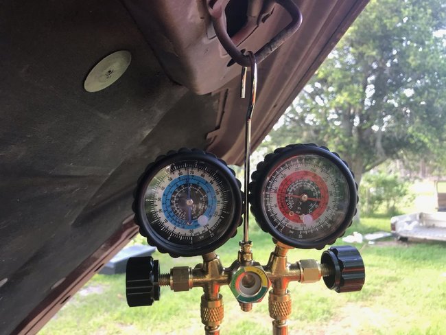

I put the gauge on there but not sure what is a good reading. Photo attached.
I also checked to see if the relay was engaging when the air was turned on in the cab. The relay did click when I turned on the air.
John
May 7, 2021 at 9:53 PM

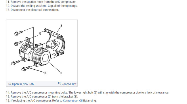

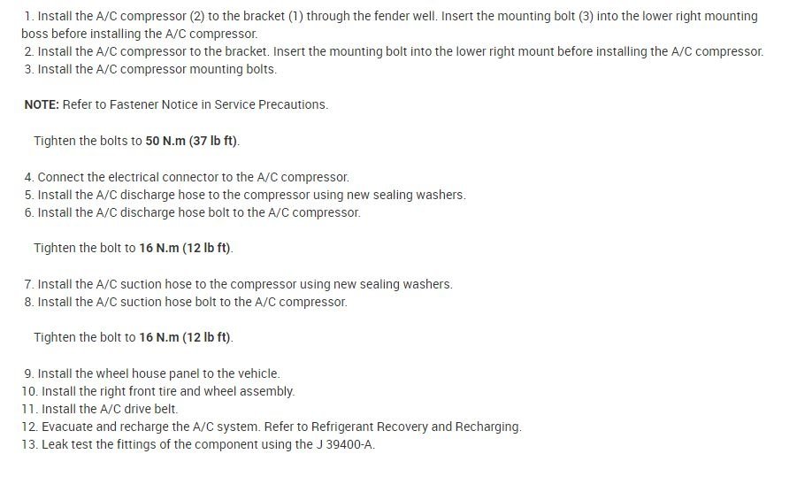

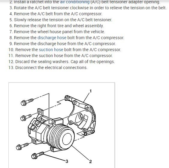

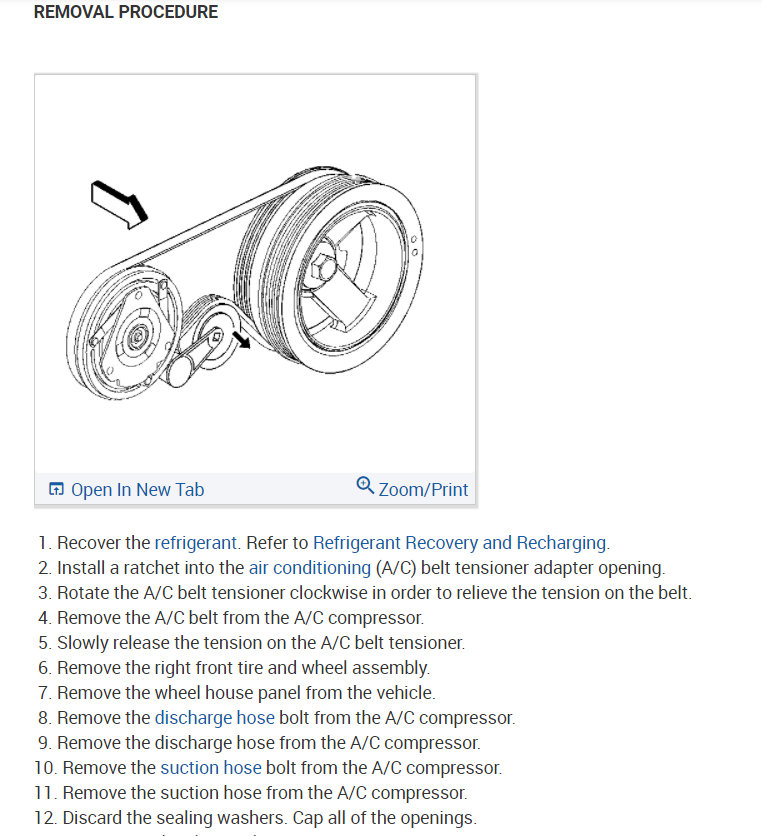

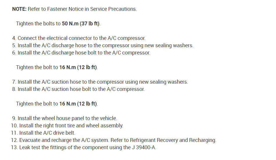

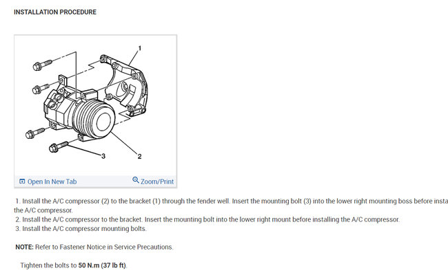

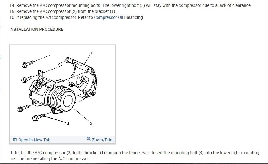

Okay, did the compressor come on? Those readings with the compressor on indicate a bad compressor. It is not producing any pressure.

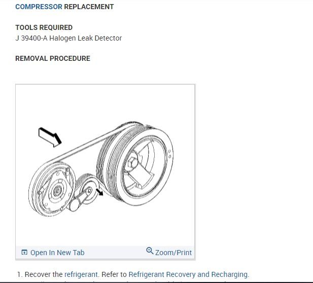

https://www.2carpros.com/articles/replace-air-conditioner-compressor
I attached the procedure for you for the compressor below.

Finally got back under the hood. I tested for continuity from the compressor to relay contact 87. 0 ohms.

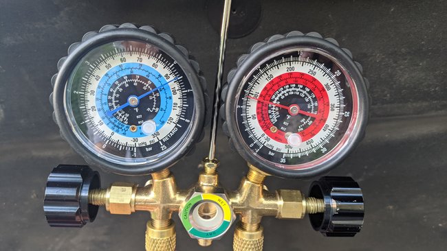

From the 10 amp A/C compressor fuse to pin 30. Infinity. That explains why the compressor wasn't kicking in. So, instead of replacing the fuse box or trying to dismantle the fuse box, I ran a 16 gauge jumper from the fuse to pin 30. Picture attached.

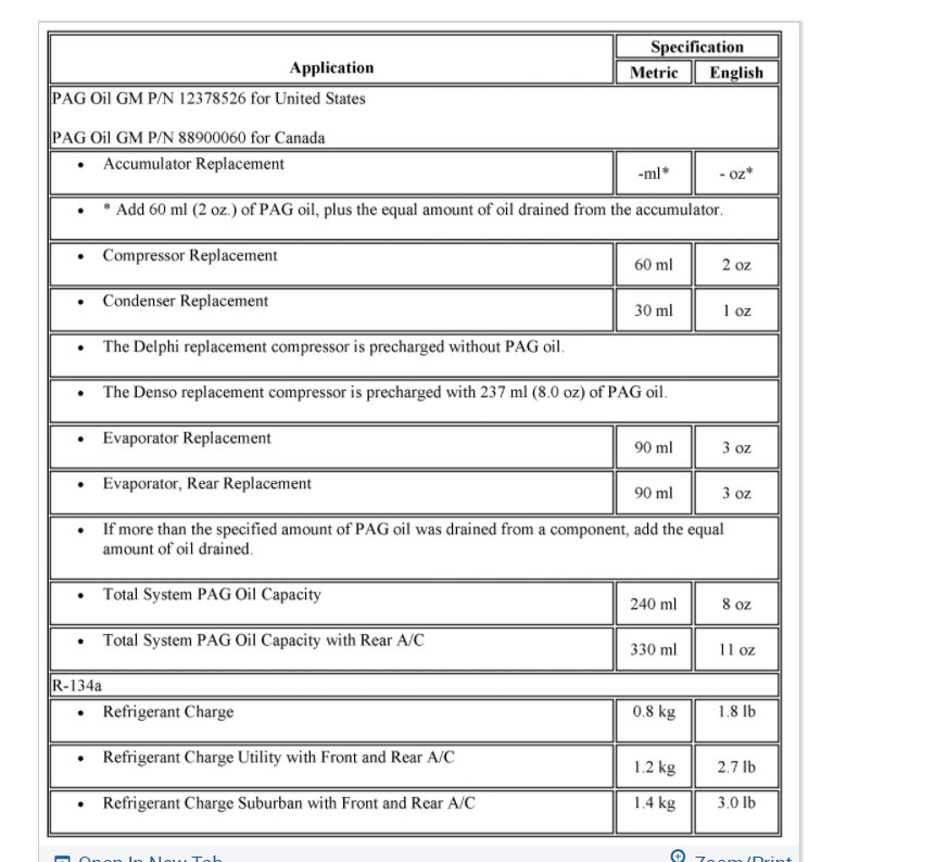

Compressor kicked in, cycled twice and then nothing. Checked the fuse, still good. Snapped a picture of the gauges while the clutch was engaged but that doesn't look like it's right. That picture attached as well.
John
May 15, 2021 at 8:27 AM
The static pressure is not bad. What happened to the low side pressure when the compressor kicked on?

It initially went down but looking at that gauge, it looks like it krept back up by the time the picture was taken.
May 15, 2021 at 9:10 AM

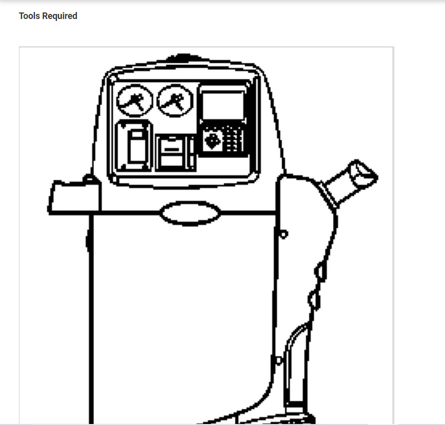

Just adding some freon and see if the compressor stays on. Below 20 pounds on the low side, it will not stay engaged.
https://www.2carpros.com/articles/air-conditioner-how-to-add-freon
