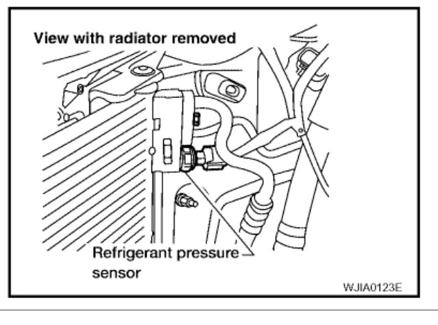

Where is the compressor cut-off switch located?
A/C compressor clutch does not engage after engine warms up.
Apr 5, 2018 at 2:31 AM
  • 55,399 POSTS

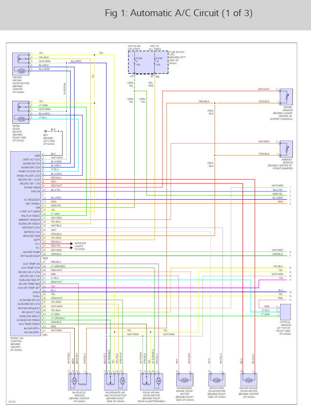

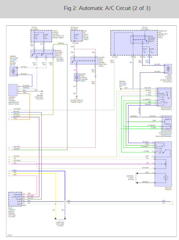

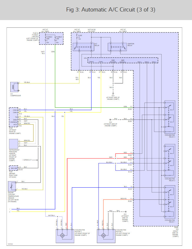

Please make sure the engine is not overheating or the system is not overcharged which will cut off the AC.
Below is the location of the pressure sensor and air conditioner wiring diagrams.
