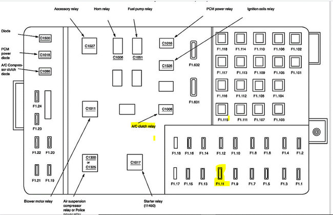

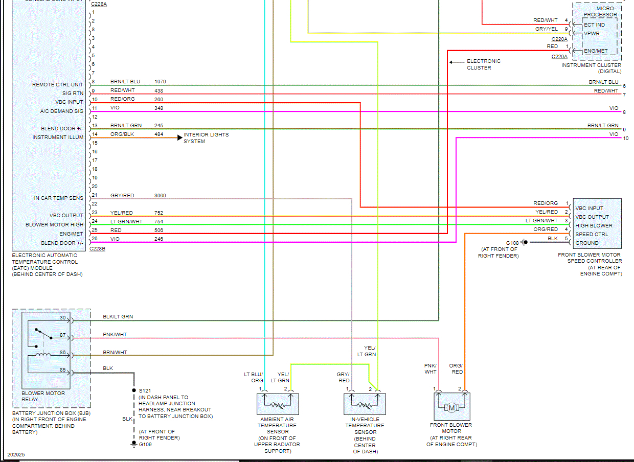

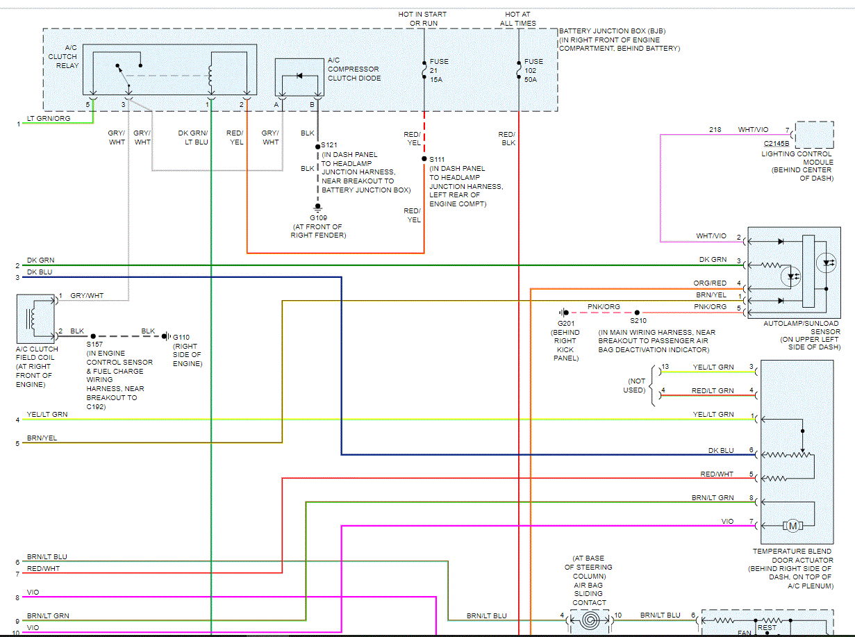

Have you checked the fuses and the relay? If you look at pic 1 below, I circled the two of them. These are located in the battery junction box on the right side of the vehicle under the hood.

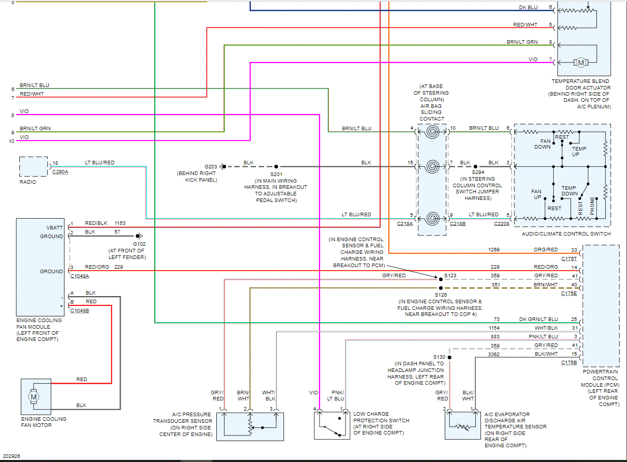

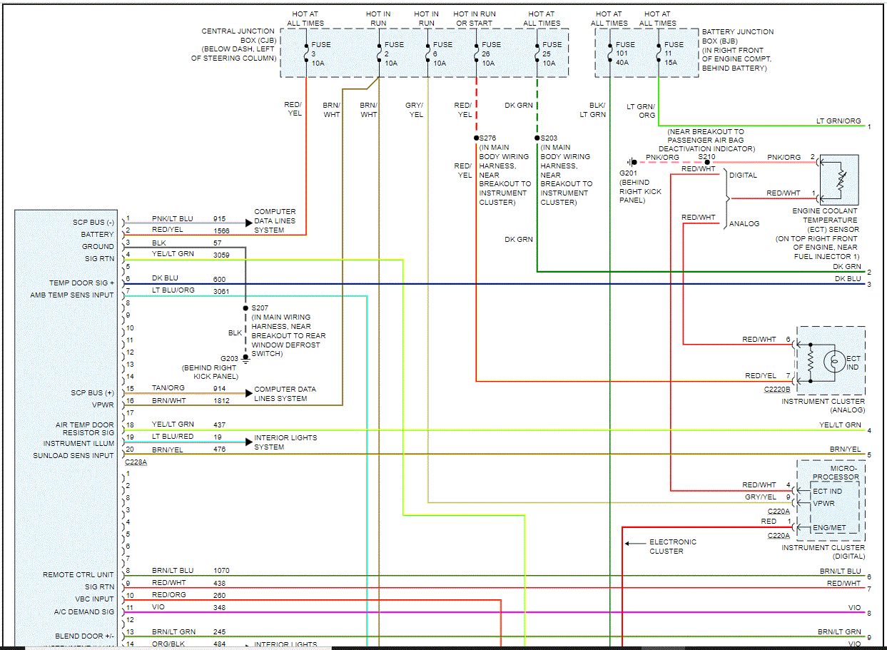

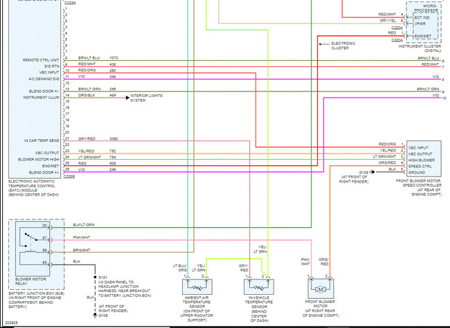

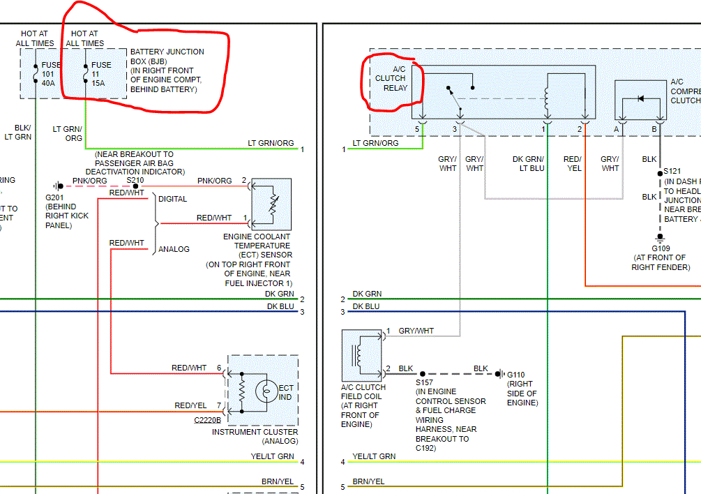

Pics 2 - 5 are the entire wiring schematic for the AC system. I added them so you can reference them if needed. I had to cut each pic in half to make them readable. However, I did overlap them so you can easily follow from one to the next.

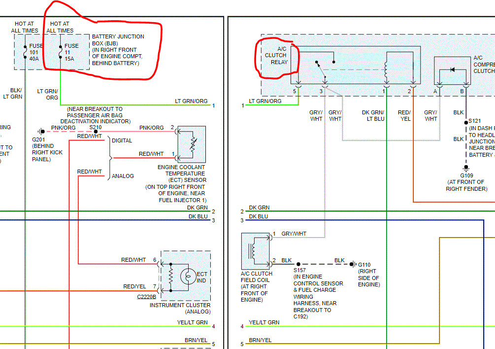

Pic 6 shows the battery junction box. I highlighted the relay and fuse. Confirm there is power to and from the fuse in addition to just checking it. If there is a relay with the same part number, switch them. If there isn't, here is a link that explains how to test one:
If you haven't already, confirm there is no power to the clutch. If there is, you may just have a bad unit.
