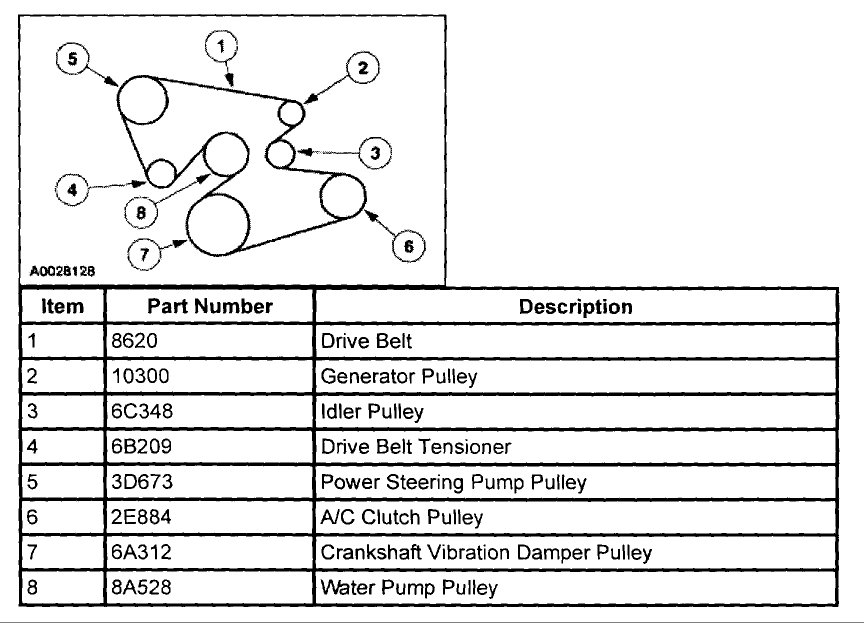

We are replacing the water pump in my van. It took longer than expected and i do not recall where the bracket goes and i cannot find any information on it.

This may get you in the ball park.
2001-2003 VIN 4
Click on diagram below.
