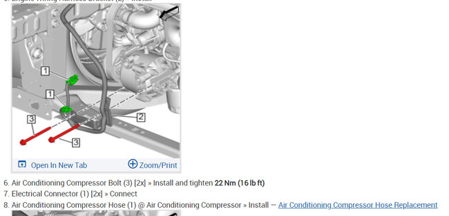

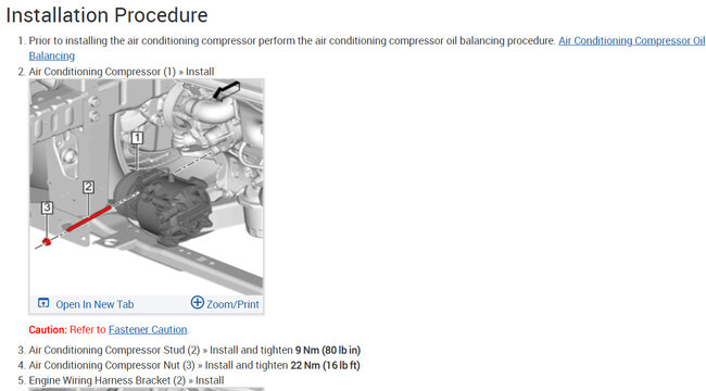

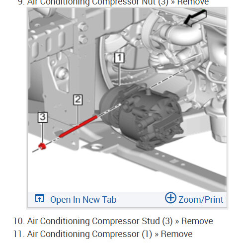

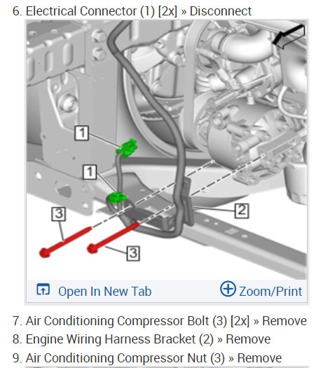

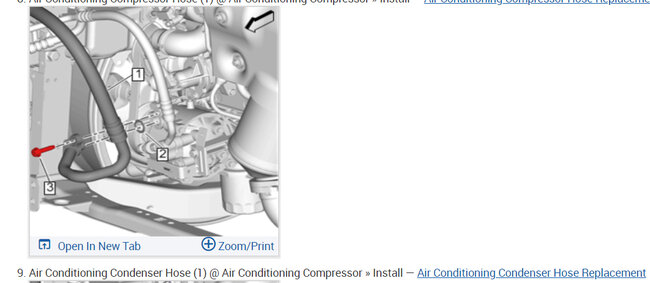

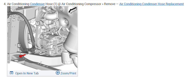

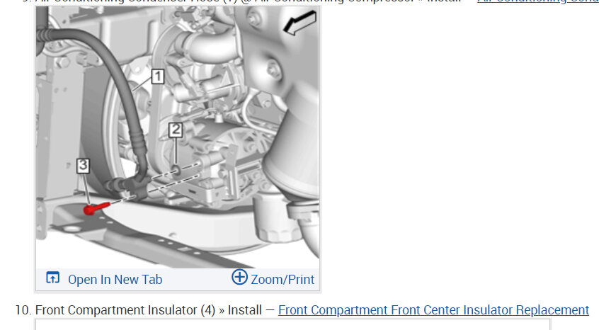

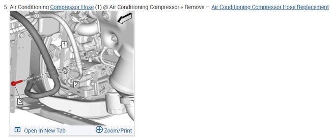

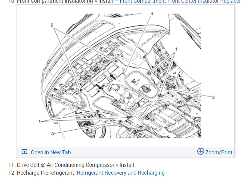

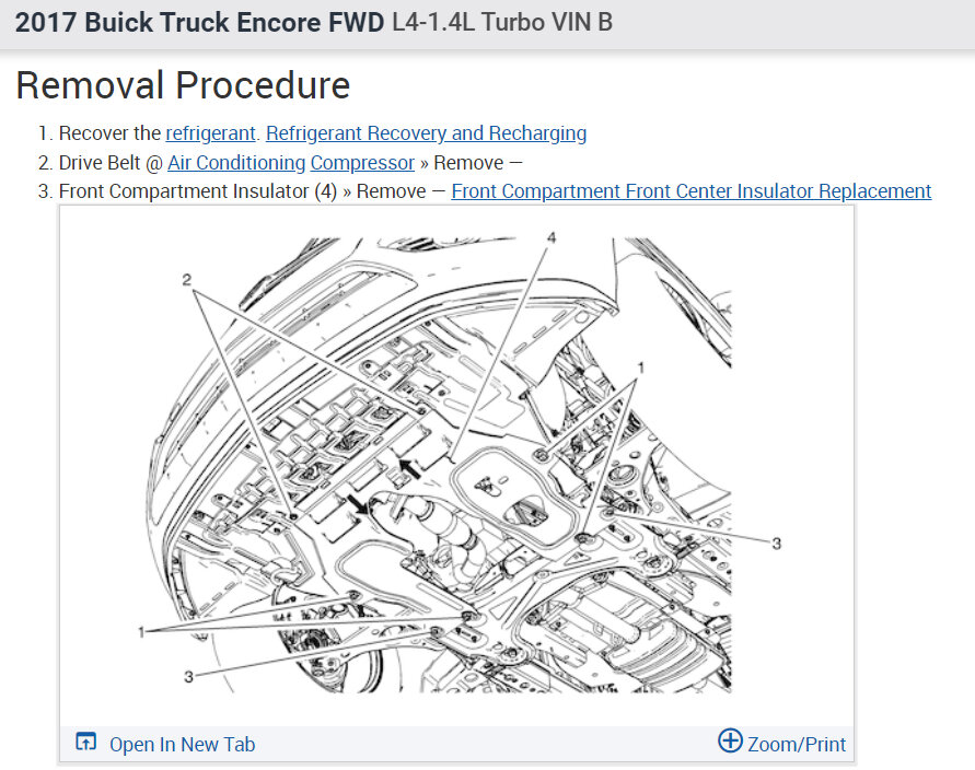

If the compressor is bad they should unplug the compressor because it comes on with the defroster and if the compressor locks up which is probably what you are smelling and feeling in the steering wheel it can cause the serpentine belt to break and cause the engine is overheat. Here is a guide to help walk you through the steps and see what needs to be done to fix the problem, also I have included how the job is done on your car in the images below.
https://www.2carpros.com/articles/replace-air-conditioner-compressor
Check out the images (below). Let us know how it goes
