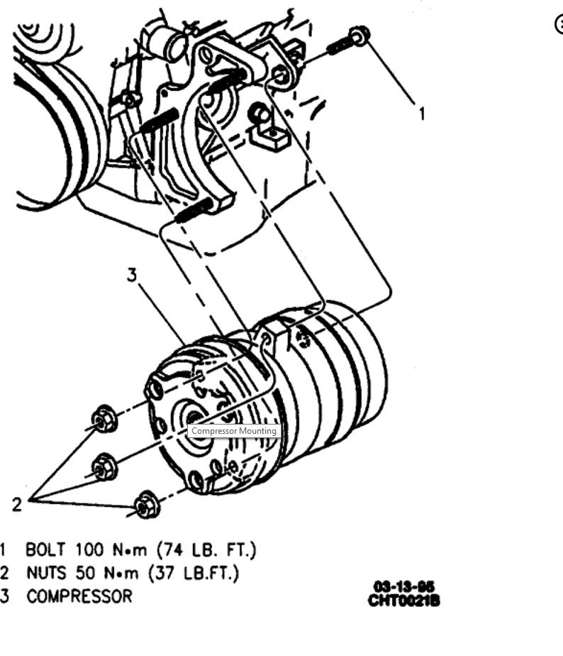

You guys are great! I am going to try to replace the A/C compressor on my wife's car any help or video would be greatly appreciated. God bless.
Jul 6, 2017 at 11:24 AM
Experienced Mechanic
55,865 POSTS
Thanks for using the site. Here are some great guides that will help you get the job done with a diagram (below).
https://www.2carpros.com/articles/replace-air-conditioner-compressor
