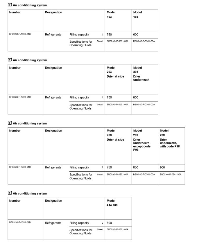

Refrigerant Oil - Check out the diagram below.
Type PAG
Capacity
Refrigerant compressor filling quantity 120 cc
Additional oil filling capacity
when system suddenly looses charge 40 cc
when replacing condenser 20 cc
when replacing evaporator 40 cc
when replacing suction line 20 cc
when replacing pressure line 20 cc
when replacing refrigerant compressor 20 cc
in case of detectable leakage 20 cc
when replacing drier cartridge 20 cc
Refrigerant Oil
Type PAG / Part No. 001 989 0803 Check out the diagrams (Below). Please let us know if you need anything else to get the problem fixed.

Hi everyone, i will be doing an AC compressor job in a couple of days and i need to know how much compressor oil i need to add to the new compressor and how much refrigerant does my car take after a full vacuum?
I cannot find consistent information on the web so i thought i would check with you.

Yes that is the compressor, I just did one of these in my wife's car, here is the video, the compressor will come with oil in it but you can add 1/2 once to feel safe.
Here is the video
https://youtu.be/_pBoAA87gHI
and guide on how to vacuum it down and recharge it
Please let us know what you find so it will help others.
Best, Ken
