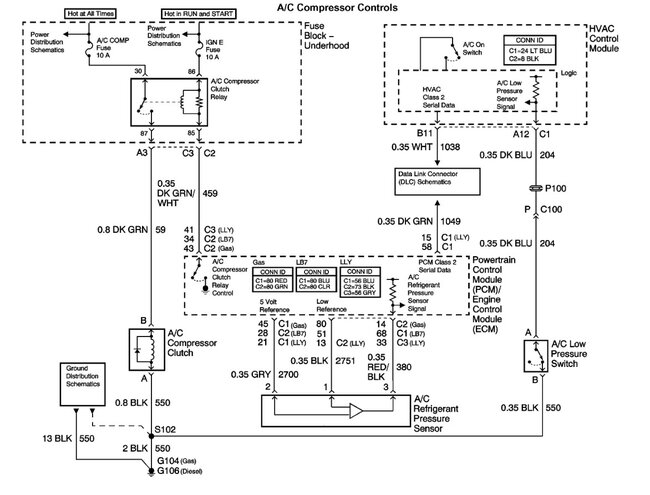

I've replaced: compressor, high- and low-pressure switches, both high- and low-pressure switch pig tails, accumulator/drier and the orifice tube and filter. Gassed the system up with 26 oz of 134-a. (crew cab truck with front A/C only.) When I press the ac button on the control panel the compressor clutch will engage for 1-2 seconds and then kick out. It will engage and run continuously if I jump the pins in the relay. So, I checked the voltage to the pressure switches, low side has 12V to one terminal and 0 on the other. Does polarity matter on the low side switch? And on the high side (3 wire) I have 4.9v on the green wire and neither of the other two (red and black) have continuity to ground. I'm looking to see if there is a wiring diagram for these pressure switches or if I've missed something else.

Where are you getting them? What is the pressure if you just connect the gauges with the engine not running? About the only other thing that could cause it would be if the orifice tube is the wrong one. If it was too large it wouldn't restrict the 134A enough and you would get a narrow pressure window like you have. As for the pressure switches, the low pressure is a simple switch, If the system has any pressure in it that switch should be closed. It opens when the pressure drops. It simply grounds the circuit so if you unplug it and use a jumper to ground on the A (blue) wire that would be the normal position of the switch. The high side is a true pressure sender. You should have a ground through the computer on terminal 1 (black wire) then 5 volts on terminal 2 (gray - your green wire) and terminal 3 (red with black) is a variable voltage that tells the ECM the system pressure. It controls the clutch cycling by adjusting the pressures in the system based on exterior temperature and A/C demand.

Hmm, those pressures are low. 82 ambient temperature I would expect the low side to be around 45 and a high up around 200. Then with the engine off in 82 degrees you would see about 82-85 psi on both once it equalizes.
What was the reason for compressor replacement? 18-20 psi won't even close the low side switch. Try this, unplug the low side switch and jump the two terminals in the socket. Does the system now come on? If yes, then it might actually be low on charge.

The reason for replacement was because of the pressures being the same on high and low, guess that was my fault for not knowing to close the gages lol. Oh well, just have an extra one now! I went to jump the low-pressure switch and heard a hiss, looked all around and found that the high-pressure switch (3 wire) is leaking where the metal meets the plastic. So now I’ve got to see if I can find one locally. (I unscrewed the switch from the line so I didn’t lose all my Freon) I can still jump the low pressure but without the other in place it won’t work I’m assuming.

Sorry for the delay in responding, I was waiting on parts to come in. I went ahead and ordered a condenser I figured might as well being this far into it. So after replacing everything in the system and double checking my wiring on the switches I started the truck, turned the air on high and recirculate, started putting Freon in (after pulling a vacuum for 30 minutes at -30 and letting it sit for 30 to ensure no leaks) and the compressor kicked on and let me fill the system!! (25.6 oz) gave me 45 psi on the low and 145 on the high side blowing out 52 degree air inside! While I had the whole system apart I took an air hose and blew out all the lines. Good thing I did bc I had metal flakes in there I’m assuming from the old compressor. I can’t thank you enough for the help and I hope someone else finds all this information helpful! Thanks again!
