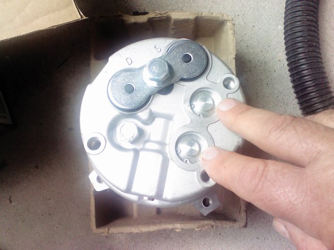

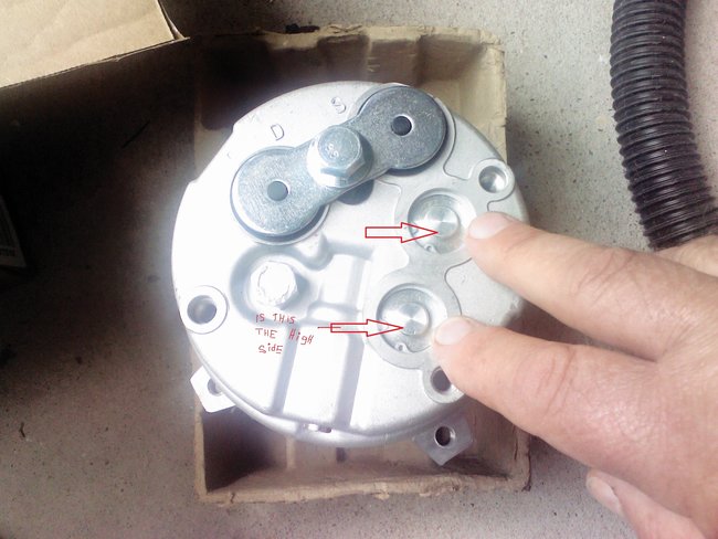

I would like to know which ports hole are the high and low side for the pressure switches? looking from the back side of the compressor is the top one low side and the bottom one high side? Thank you, Craig

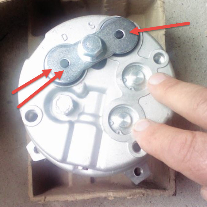

See picture, single arrow is low side or suction and double arrow is high side or discharge.

Do you see were my fingers are? thought plugs come out to install the pressure switch's cut on and cut out. need to know which. I think the one on top is low and the bottom one is the high side. Thank you, Craig

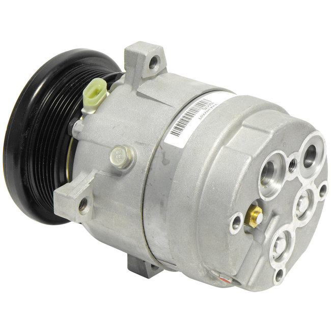

The port closest to the suction port is the low side port.
Here is a guide to help you with the job:
