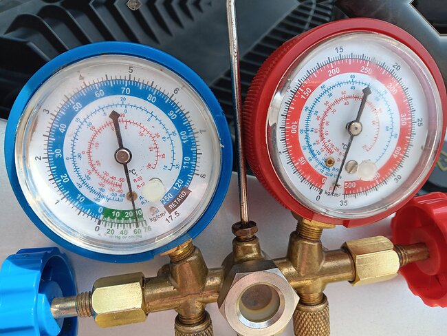

air conditioning compressor won't start. There is freon in the system. maybe an electrical short or loose connection? Compressor will turn by hand.
Any ideas?
Thanks,
Charlie
Apr 9, 2025 at 12:30 PM
  • 55,103 POSTS
When you say there is refrigerant in the system can you tell me the low side pressure when the system is off? Please go over this guide to help us see what's going on.

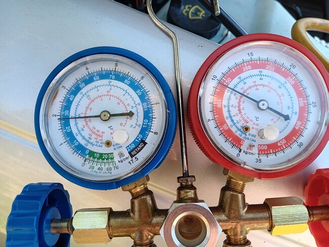

Low side pressure is 62 with outside temperature of 70.

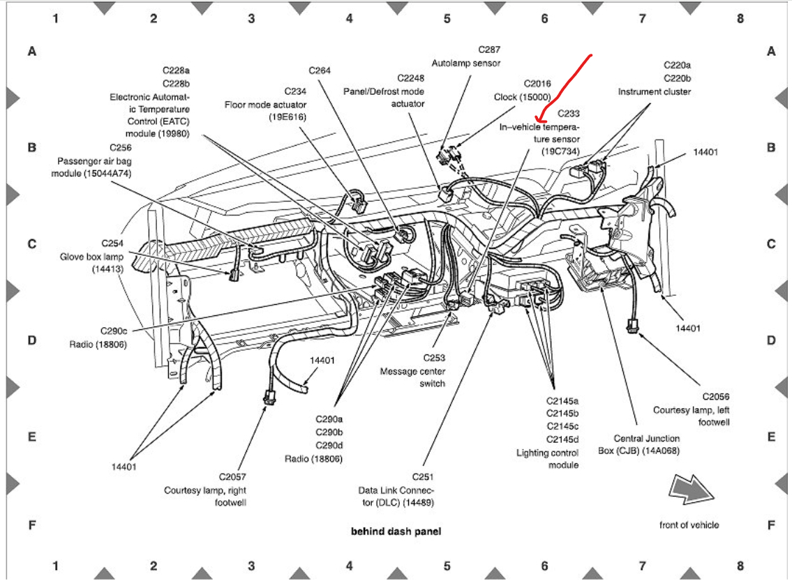

So either of these codes can cause the problem you are having.
B1259 - Air Temperature Internal Sensor Circuit Failure
B1263 - Solar Radiation Sensor Circuit Failure
But I would turn the system on and check to see if you are getting power to the compressor first. Did you go over the guide above? This guide can help test the gry/wht wire at the compressor. Let me know.

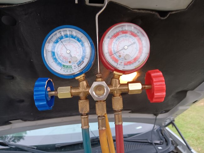

Hi Ken,
I read the guide you sent and watched video
Low side pressure is 90 psi and clutch won't "kick in" on the compressor.
Blower runs and normal green lights are on the dash.
Swapped clutch and horn relay still no compressor kick in.

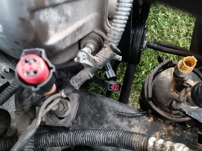

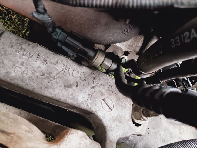

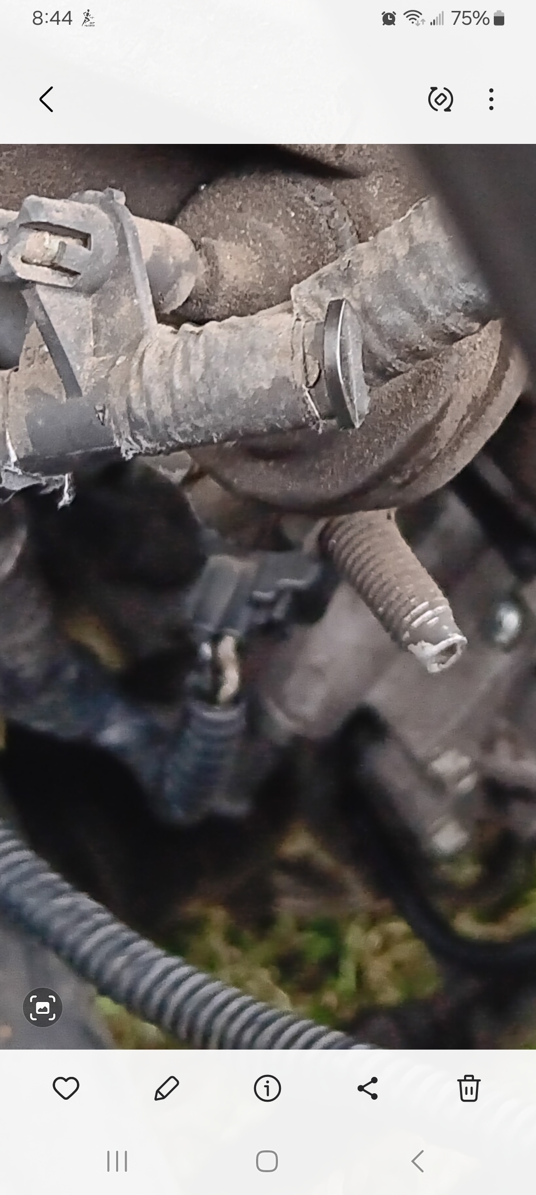

Low side now reads 53 with temp outside of 54,
Got two connectors apart but afraid to break low pressure connector.
Is there a trick to get it loose?
See pics.
Thanks Ken
Apr 14, 2025 at 12:18 AM
  • 55,103 POSTS
I would start the engine and turn the AC on full, then open the refrigerant source and low side valve to see if the system will kick on. It looks like the system is low. Thanks for the images, plug the connector wire back in.

Did you try what I suggested? The code p2267 says you have water in the fuel. If you tried what I suggested I would replace the Air Temperature Internal Sensor. Here is the location.
Apr 17, 2025 at 2:34 AM

Hello Ken,
Got the sysyem vacuumed for 45 minutes,
Added 1 oz pag oil and 32 oz r134a
Low side kicks off at 50 psi and kicks on at 20 psi
Vent temp 44 to 50 degrees

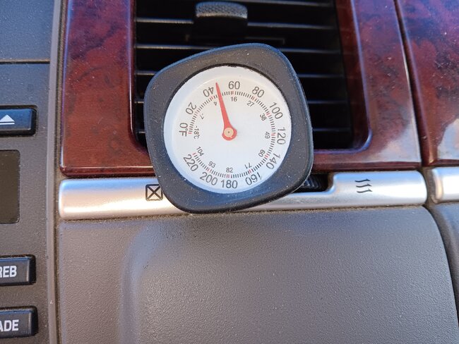

Hi again Ken,
It takes a minute or two for the compressor to kick on after starting. If that is normal, then it works for now.
Latest images just now after running for 10 minutes.

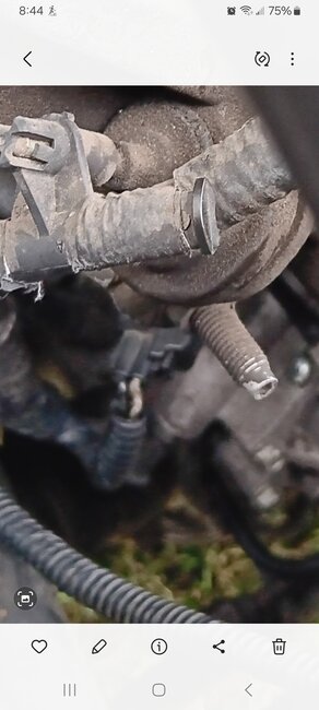

No leaks found and holding pressure. Intermittent power from wiring harness to compressor.
Wire needs to be moved by hand and compressor might come on (see image).
Sometimes I hit it with a stick it kicks on.
Thanks Ken.
Have a good weekend,
Charlie
Apr 26, 2025 at 1:51 AM
  • 55,103 POSTS
Yep, you can see at the electrical connector the wires look like they are broken. I would splice in a new pig tail connector which you should be able to get from Amazon.
