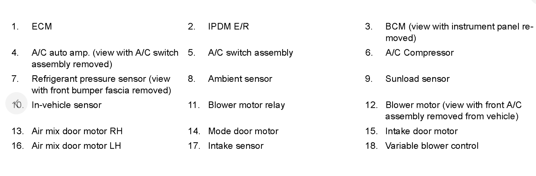

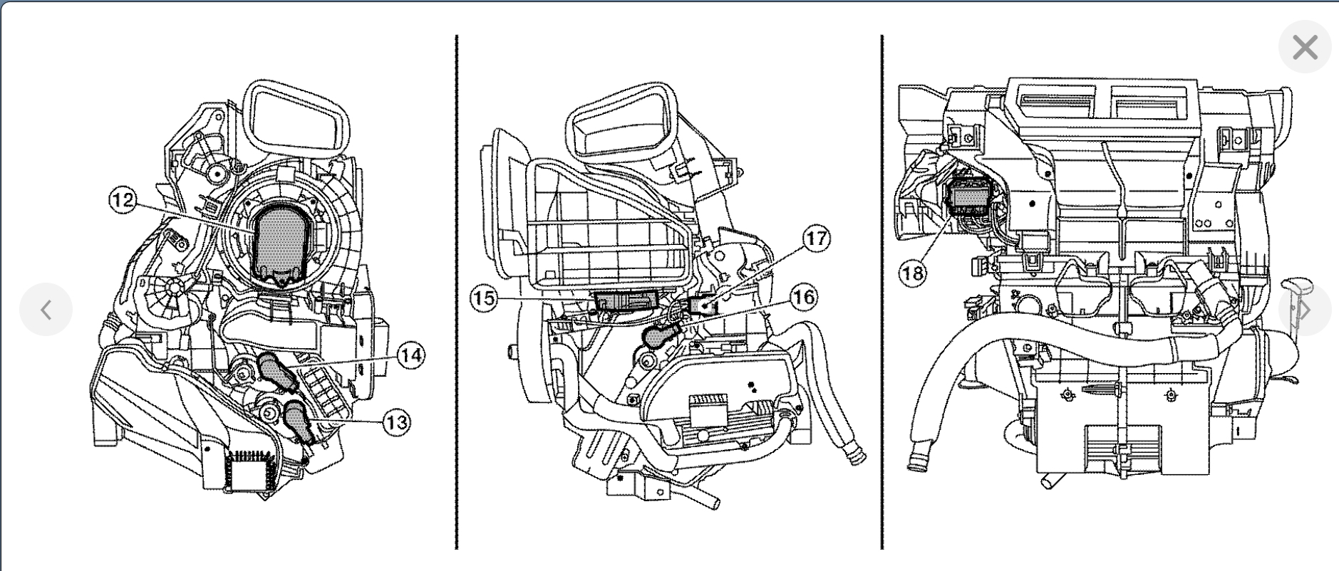

The procedure for the blend door is below and there are pictures as well. Number 16 is the one and is behind the glove box.
