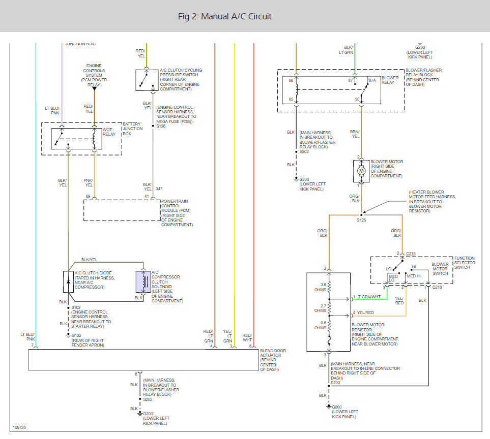

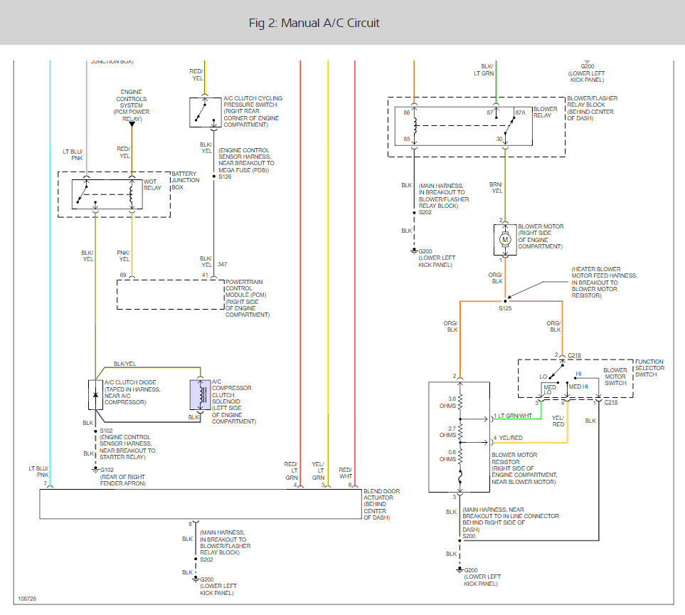

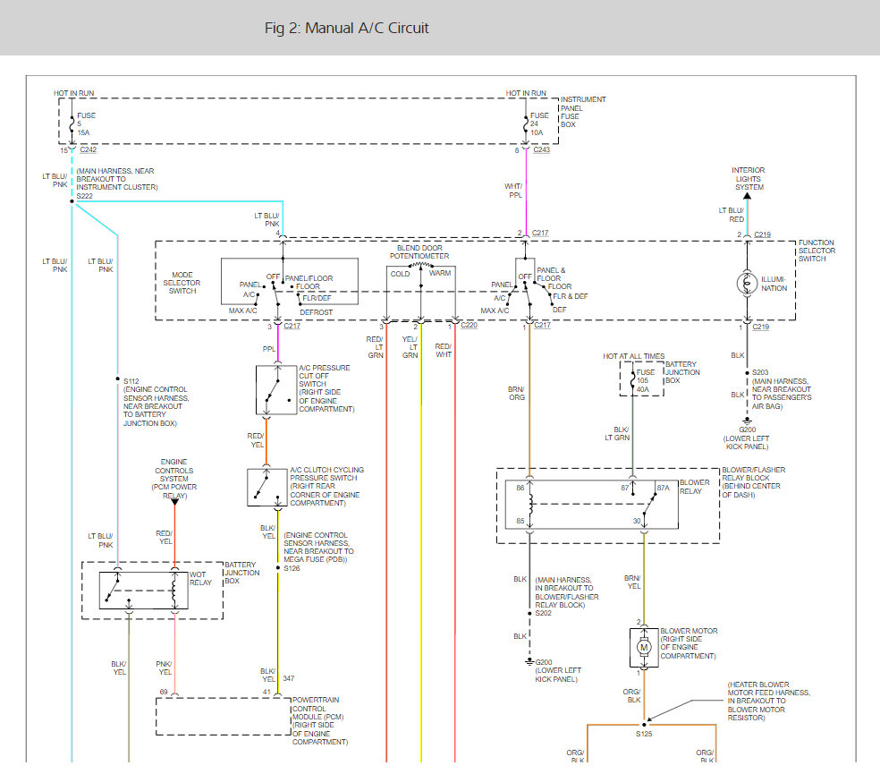

I want to wire the clutch to the correct wires. the present wires are cut off and I do not know where the wires are located that I need to reconnect the compressor.

I have found the air conditioner wiring diagrams for you (below). And a guide to help you test the connections.
