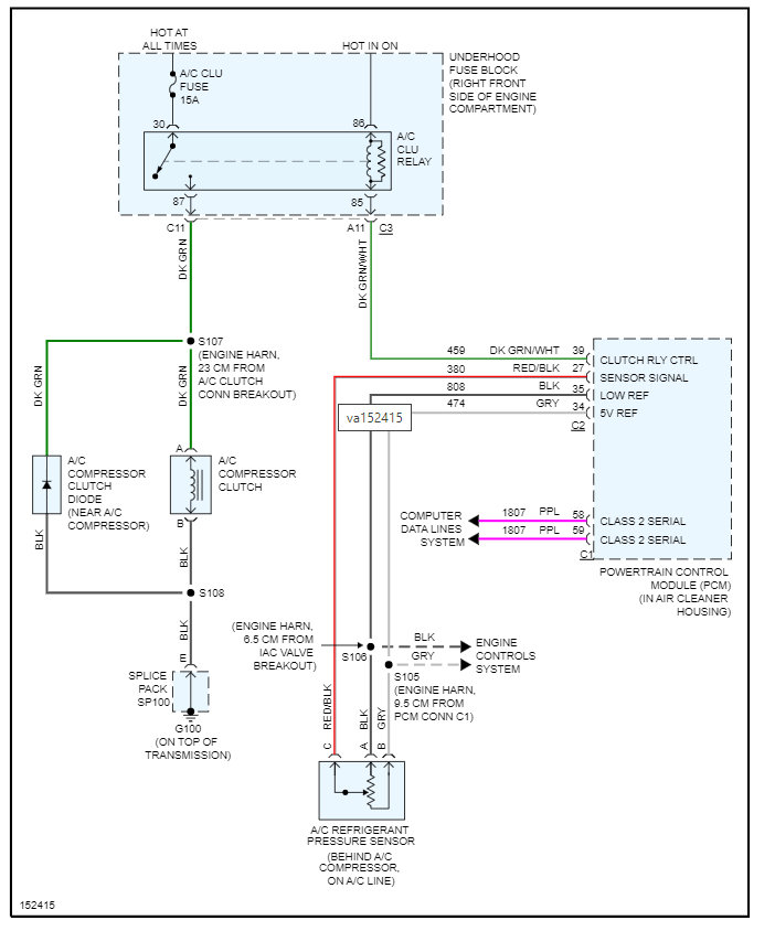

This could be a couple of things but let's start with how it works.
If you look at the wiring diagram, the relay is powered on pin 30 and 86. So we need to make sure you have 12 volts on both wires when you have the key in the on position.
Next when the A/C is supposed to be on, the PCM grounds the relay by applying ground to pin 85 which energizes the relay and closes the contact inside. This will then complete the circuit from pin 30 to 87 which sends power to the compressor.
So, what I would do is check the power on 30 and 86. Then check the ground on pin 85. You do this by putting your red meter lead on a 12-volt source like the battery. Then put the black lead on terminal 85 and turn the key on and AC on. Your meter should read 12 volts.
If it is not, then the PCM is not commanding the relay on.

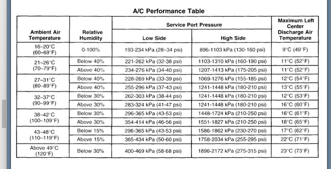

At that point, it could be a PCM issue, but it could also be a pressure issue or a pressure sensor issue. So that means we need to check and see what the actual pressure is in the system.
If the pressure is not correct when you jump the relay to get the compressor to come on, then we need to set the pressure correctly and see if the compressor will come on.
If it still does not, then we have a sensor or PCM issue.
So, let's start with all this info and then if we get there, we can figure out if we have a sensor or PCM issue.

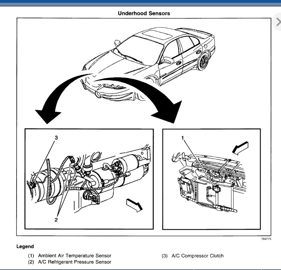

Hey Kenny, okay so, I'm getting perfect voltage on 30 and 86 just like I'm supposed to. Unfortunately, I'm getting absolutely nothing on 85. I was going to check the plug pins on the high-pressure sensor, but I can't find it. The only place I couldn't see was the back of the compressor itself. My car has the 3800series 2. Now, on the 3800 series 3, the sensor is right below the air intake box, but it certainly is not on the series 2. By the way, I very much appreciate all the help/tips/tricks!!
Jun 18, 2022 at 1:25 PM
Okay. Just want to make sure you checked 85 the opposite way you checked 30 and 86. Meaning you check 85 for a ground so you put your meter on 12 volts and then the black lead on 85 and turned the AC on? If you did and have nothing, then the PCM is not grounding it.

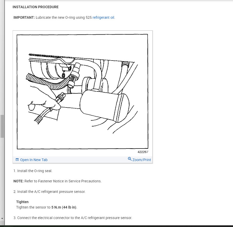

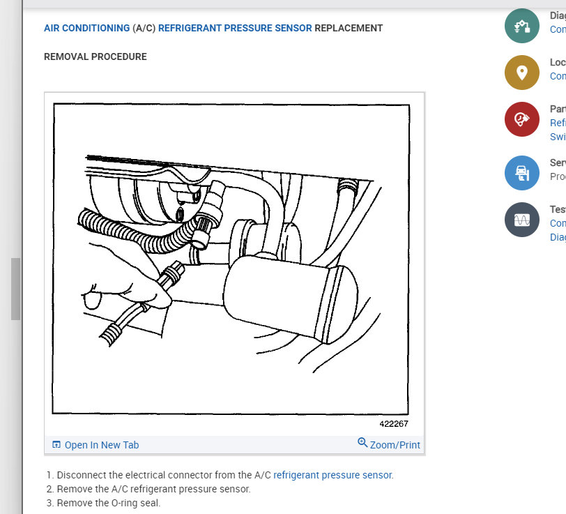

I am attaching the location and replacement for the sensor. It is located behind the compressor on an A/C line.
This is a 3-wire sensor so we are not able to jump it to see if the compressor will come on. So, we need to check the pressure and see if the pressure is correct. If it is, then the sensor would be the likely cause.

Yes, I checked the 85 opposite the way I checked 30 and 86. I was also able to get my hands on a PCM pinout as well, just in case. Oh, and I have already checked the pressure while I had the compressor jumped and clutch running. It was perfect. I'll get the sensor replaced and let you know what happens. Again, and as always, thank you very much Kenny!!
