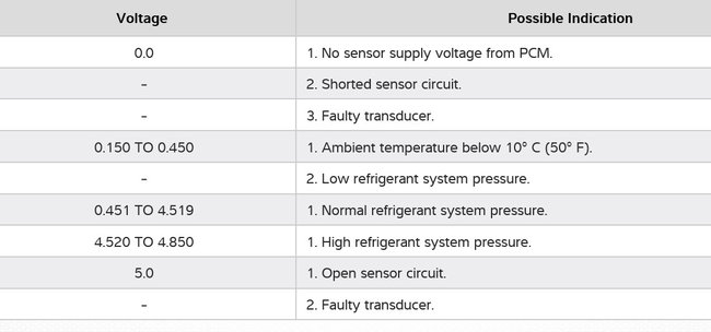

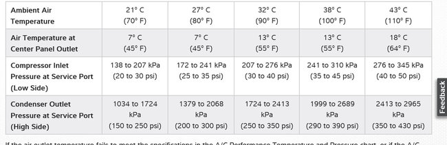

around 45 psi on low side isn't to bad for 90 -100 ambient temp what I gave you was what was in our manual for clutch.have you tested pressure transducer by compressor? I've got the figures here to check also your high side is low for the ambient you have stated. see chart which leaves me to believe it's something like the orfice . see pics other than that i'll have to leave this open if you recontact me with same problem i'll pass it on.

I will check the pressure sensors - haven't done that yet. I will also record some more accurate manifold pressures and get back to you here.
