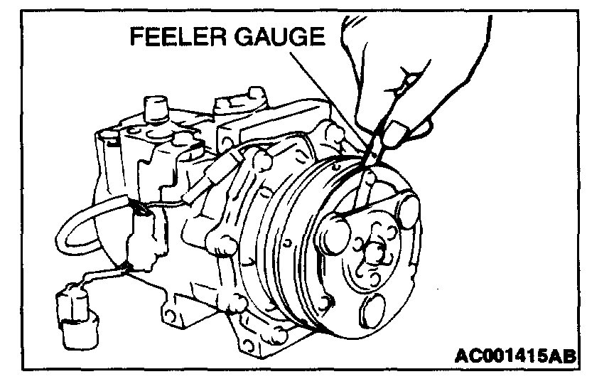

Hi 2CarPros,
Last year my A/C clutch cable kept breaking at the plug on the A/C clutch. We resoldered it back together very well at one point and even replaced the whole cable with a junk yard part, soldering that much higher up the wire and it ended up breaking in the same place near the plug. When I touched the wire after it broke, it was quite hot. My question is, should I try another new cable and perhaps use some hot melt glue to see if it'll hold better? Or am I just treating the symptom here, which would be a symptom of a failing A/C compressor since it's over 20 years old? If it's vibrating and heating up the wire that badly, perhaps it's time to just replace the whole A/C compressor. What do you think? When I had it all wired together the A/C was working quite well. Also the refrigerant was at a good level, 34 PSI (I had heard various things about what level is fine...at 30 PSI it was not cold at all... I was later told 35 PSI is alright for imports and raised it to 34 PSI).
Thanks in advance for your help.
Adam
Mar 5, 2021 at 7:34 AM
  • 110,244 POSTS

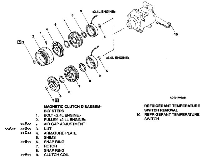

There could be an issue with the compressor clutch drawing too much power. You may want to consider replacing just that. There is an air gap in the clutch that can be too wide causing more of a power draw, so check that as well.
____________________________
Here are the directions for replacing the clutch on the compressor. The directions include the air gap specifications, so check yours first before replacing. That is the only thing I can think of that may cause it to draw more power. The pics below correlate with the directions.
2001 Mitsubishi Eclipse GS L4-2350cc 2.4L SOHC MFI
Procedures
Vehicle Heating and Air Conditioning Compressor Clutch Service and Repair Procedures
PROCEDURES
Note: This article is updated by TSB 03-55-007
pic 1
DISASSEMBLY AND ASSEMBLY

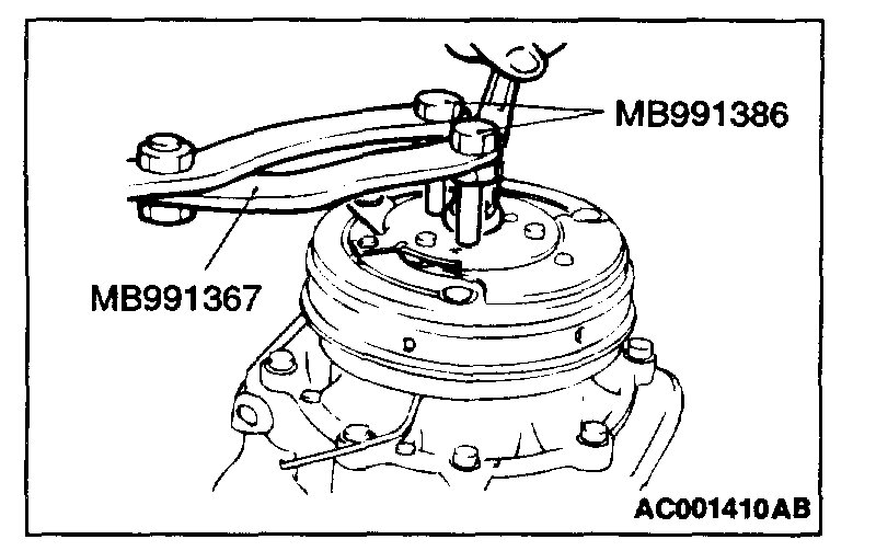

Required Special Tools:
- MB991367: Special Spanner
- MB991386: Pin

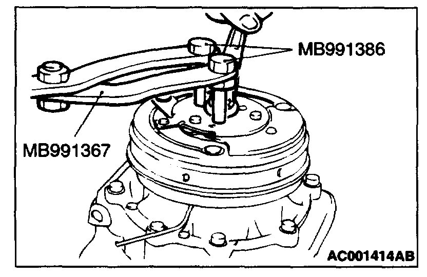

DISASSEMBLY SERVICE POINT
pic 2
NUT REMOVAL
Use special tools MB991367 and MB991386 to hold the magnetic clutch, and remove the nut.

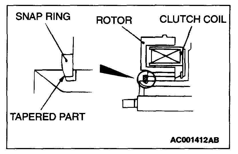

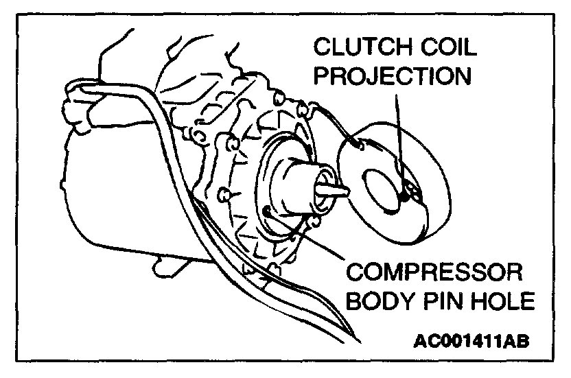

ASSEMBLY SERVICE POINTS
pic 3

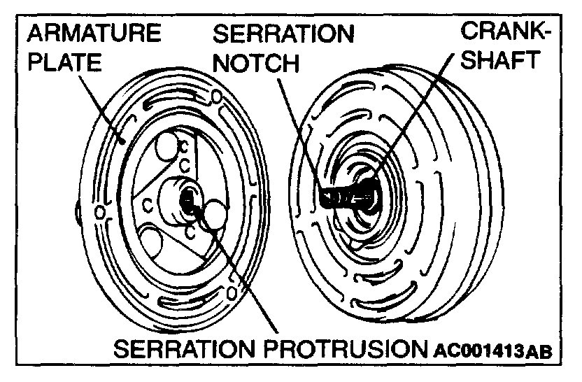

>>ABCDEF

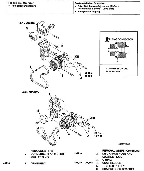

The A/C Compressor is 213,000 miles old too. So I'm just wondering if I am better off replacing that too. Looks like I could get an OEM clutch for $90.00 or an aftermarket A/C Compressor for $96.00. If I replace just the clutch, shouldn't I expect the A/C Compressor itself to go bad sometime in the next 50,000 miles or so too?
Mar 6, 2021 at 4:29 AM
  • 110,244 POSTS
I understand your concerns. At that mileage and the prices you listed, I would replace the entire unit. There is a good chance the old compressor will fail just from age/miles.

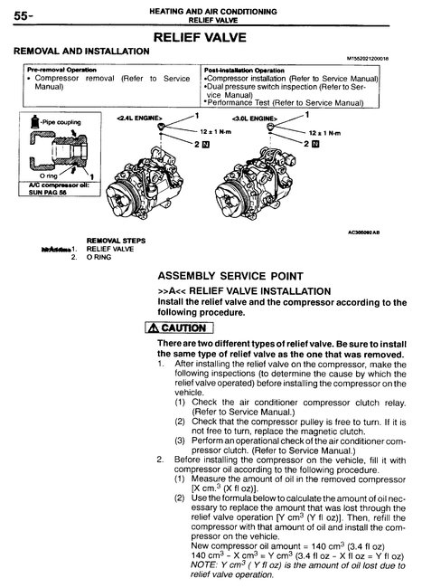

Here is some general info to help with the replacement. The attached pics below correlate with the directions.
Compressor Assembly and Tension Pulley
Vehicle Heating and Air Conditioning Compressor HVAC Service and Repair Procedures Compressor Assembly and Tension Pulley
COMPRESSOR ASSEMBLY AND TENSION PULLEY
Compressor Assembly And Tension Pulley
pic 1

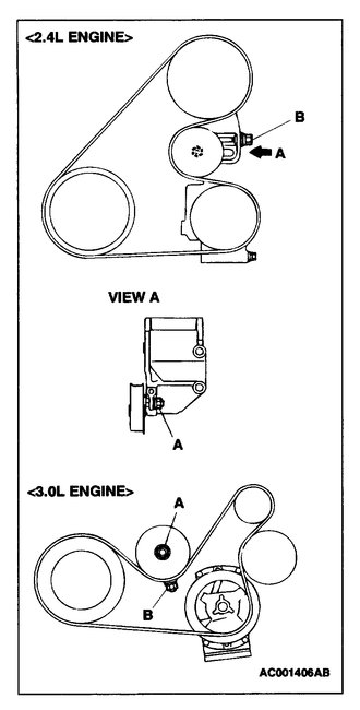

REMOVAL SERVICE POINTS
pic 2
DRIVE BELT REMOVAL
1. Loosen the nut "A" for holding.
2. Loosen the bolt "B" for adjustment.
3. Remove the drive belt.
DISCHARGE HOSE AND SUCTION HOSE DISCONNECTION
CAUTION: Seal the hoses completely, otherwise the compressor oil and receiver will absorb water vapor easily, possibly damaging the compressor and deteriorating performance.
Plug the disconnected hose and compressor nipple to prevent foreign matter from getting into them.
COMPRESSOR REMOVAL
When removing the compressor, be careful not to spill the compressor oil.
INSTALLATION SERVICE POINT
COMPRESSOR INSTALLATION
If a new compressor is installed, first adjust the amount of oil according to the procedures described below, and then install the compressor.
1. Measure the amount [X cu.cm (X fl. oz)] of oil within the removed compressor.
2. Drain (from the new compressor) the amount of oil calculated according to the following formula, and then install the new compressor.
New compressor oil amount
100 cu.cm - X cu.cm = Y cu.cm (3.4 fl. oz - X fl. oz = Y fl. oz)
NOTE: Y cu.cm (Y fl. oz) indicates the amount of oil in the refrigerant line, the condenser, the evaporator, etc.
NOTE: When replacing the following parts at the same times as the compressor, subtract the rated oil amount of the each part from Y cu.cm (Y fl. oz) and discharge from the new compressor.
Quantity:
- Evaporator: 60 cu.cm (2.0 fl. oz)
- Condenser: 15 cu.cm (0.5 fl. oz)
- Suction hose: 10 cu.cm (0.3 fl. oz)
- Receiver: 10 cu.cm (0.3 fl. oz)
Let me know if you have questions.

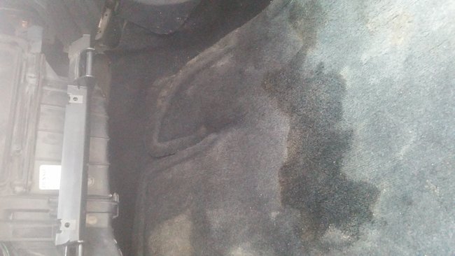

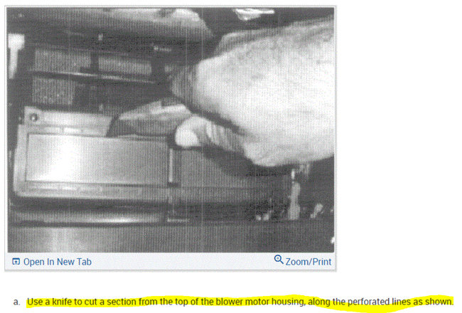

Now after running the A/C for an hour or so twice on a 95 degree day I've got something leaking down from the dashboard onto the passenger side foot mat. When touched it leaves a film on the finger and is oily, it isn't just condensation / water. Is this the Evaporator Core failing? You can see the puddle from the leak in the attached image.
Jun 23, 2021 at 1:27 PM
  • 110,244 POSTS

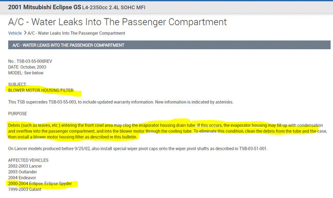

Chances are it is from the evaporator drain being plugged. The only other thing could be coolant from the heater core. Does it have a sweet smell like coolant?
There is a slight chance it is oil from the A/C, but not as much as I'm seeing in the pic. I honestly feel the drain for the evaporator is clogged and it's backing up.
If you open the hood of the vehicle, you should see the drain on the passenger side of the firewall. I believe it somewhat low. It will simply be a black rubber hose. Once you locate it, move it around and take something to clean it out inside. If a bunch of water starts coming out, that's the problem.
There was actually a service bulletin on this years ago. Dirt was getting into the housing and causing the drain to plug. The repair included installing a cabin air filter.
Take a look at the bulletin. I attached it below. This was done under warranty when the vehicle was new. However, the directions are listed below showing how it's done and the part numbers for the new filter.

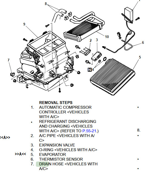

We replaced the condenser as well. We just didn't replace the Evaporator Core because that's a 5 or 6 hour job and it's still functioning.
For anyone else reading, I've attached the service manual diagram of the location of the A/C drain plug. It's actually on the driver's side between the firewall and the battery. There's a video on Youtube titled "ALL WET! - Mitsubishi Eclipse AC Drain" that shows it pretty clearly. It's just a tiny little white plastic tube sticking out. He had to remove the air intake hose to get to it. He used a shop vac to vacuum it out but it didn't really seem to do anything. I've got a little couple foot long drain cleaning snake I can try sticking in there to see if I can move anything loose. Some other mechanics were saying to replace the gasket on the end of the drain pipe. Anyway it's not a removable rubber hose from what I can tell, just a few inch long PVC pipe sticking out just enough to dump the water away from anything important. So should I just try using the snake on it and see if anything comes out? I agree with your initial assessment about the condensation drain being clogged up based on more reading. Very common problem for this car. So it's not coolant from the heater core or oil from the A/C system. Just very nasty water from a clogged drain line.

I haven't gotten to the drain plug yet. I'm thinking maybe if I get the cabin air filter done and use the A/C a lot, that it might force out some of the gunk on its own. This may be what was going on when it was spilling out onto the passenger side floor, although not in the spot I'd want it to.
Anyway the place where the cabin air filter goes is completely sealed up. The pictures you sent made it sound like there are just a few plastic tabs to break. But it appears the cover for my tray for my cabin air filter is completely solid plastic. What am I missing?
Jun 27, 2021 at 10:57 AM
  • 110,244 POSTS
There is no pressure in there other than the specific gravity weight of the water. Chances are, it won't clear itself.

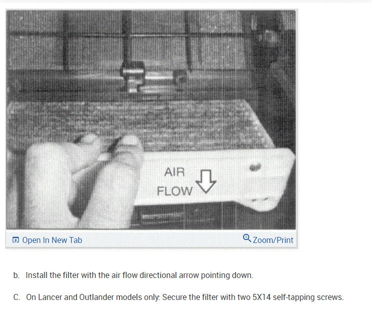

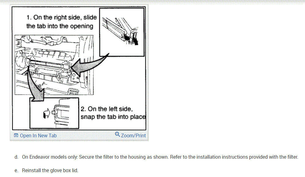

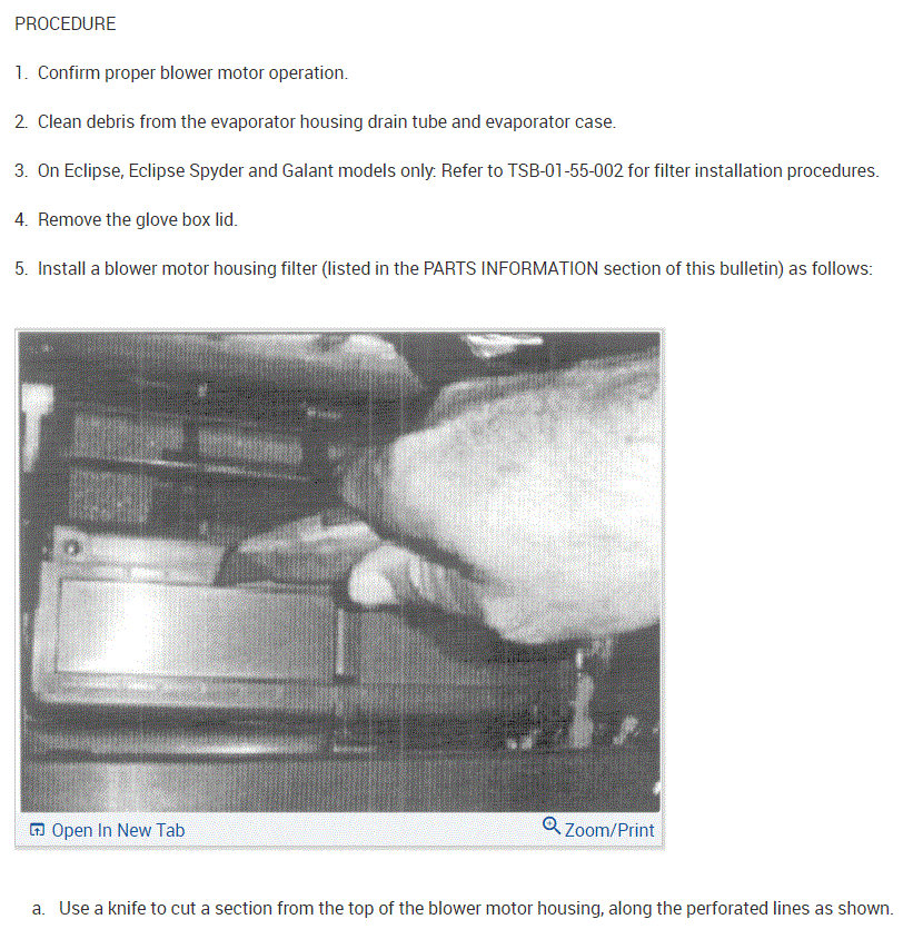

As far as your other question, you are correct. The unit is solid. You need to cut into it. See the pic below.
Let me know if I can help.
See pic.

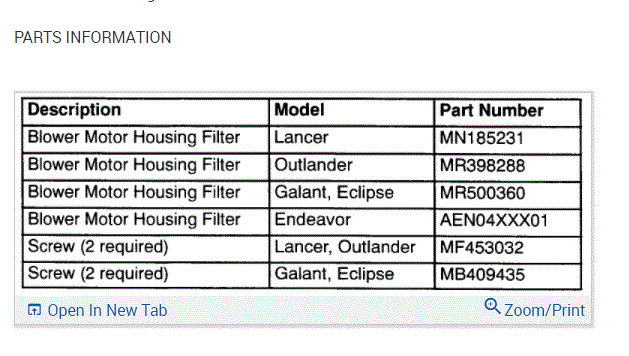

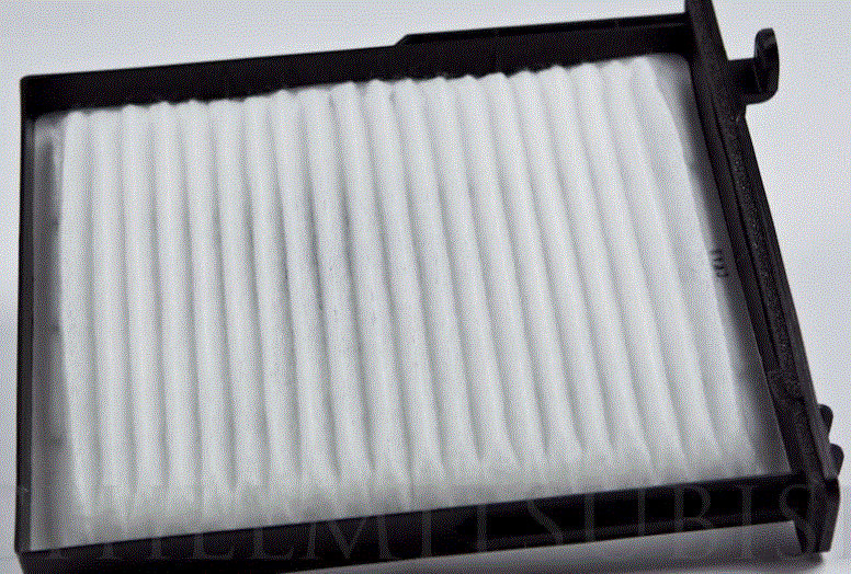

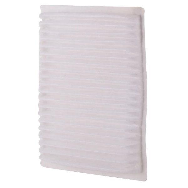

Do I have the correct type of Cabin Air Filter (pic attached)? From videos and articles online it seems like I should have one with some sort of plastic bracket that snaps into the slot. I'm not sure what to do with this flimsy sort of pillow looking one that I got, unless the bracket is already in my car, which I doubt.
Jun 27, 2021 at 2:45 PM
  • 110,244 POSTS
That doesn't look correct. Check this out on Amazon. This is the correct part number for the filter. It comes with a frame.
https://www.amazon.com/Mitsubishi-MR500360-Cabin-Air-Filter/dp/B007XL7TB2
Let me know if that helps.
See pic below from Amazon. The OEM part number is MR500360.
Jun 27, 2021 at 3:00 PM
KIWASABI1
  • 202 POSTS
Thanks, that's the part I need. I ordered it. Looks like the Cabin Air Filter I got is the correct one for when you've already got that plastic tray to put it in. Since my car doesn't have that built in, I do need this OEM Cabin Air Filter with the tray included for the first time I install the filter.
Jun 27, 2021 at 3:35 PM
  • 110,244 POSTS
Yes, that is correct. That is the part number they provided for the bulletin.
