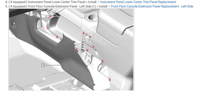

Hello there, we bought this truck this summer with a rebuilt title. Went over the damage report with the mechanic that rebuilt it and he was meticulous. However, we didn’t realize it till it started to get cold that the heat wasn’t working. Not wanting to mess around we brought it to our local GMC dealer to get it repaired. I am guessing by the repair bill they went to town replacing the heat pump and other items assuming it was still under MFG warranty but the items they replaced did not fix the problem. So, $5,300.00 later we have a nice truck with no heat. We are picking it up today after being in the shop for 5 weeks and I will be asking for a detailed list of what the troubleshot as well as the parts they replaced. When we brought it in, we were very clear that we were getting air out of all vents with the A/C on but switching to heat it felt like there was an actuator door that wasn’t moving. They said they ran a test on all actuators and their readings are all good. I’m at a loss. Where should I start?

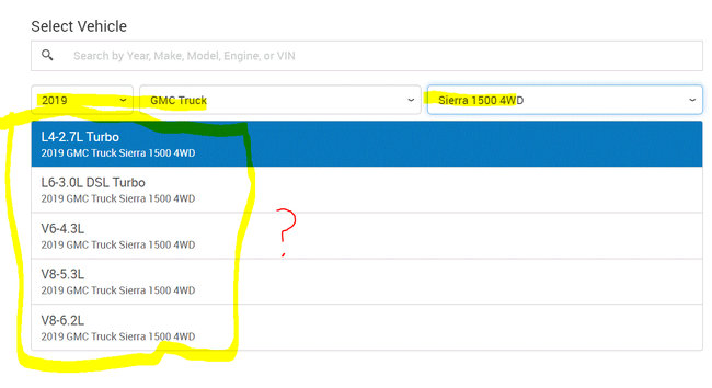

One last question. I need the correct engine size. I attached the options I'm seeing.
Let me know as much as you can, and I'll help you get it figured out one way or another. LOL Also, let me know what was done to date and if any diagnostic trouble codes were provided.

Okay, if you see the door move when changing airflow direction, that won't cause a temperature issue. We need to focus on the blend air door for operation. However, before that, I need you to check something for me.

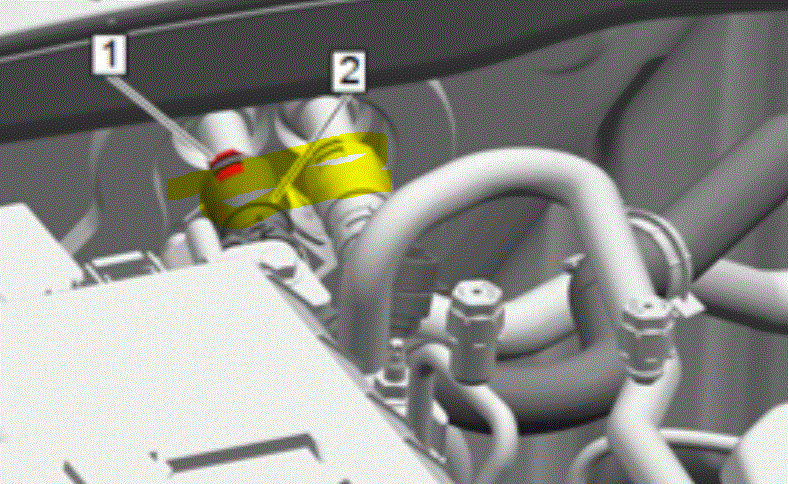

Start the engine, turn the heat on, and allow it to reach operating temperature. Open the hood and locate the inlet and outlet heater core hoses behind the engine where they go through the firewall. See pic 1 below showing heater core hoses.
Turn the engine off and feel both hoses. Are they both hot? Let me know.
I need to know if the vehicle has automatic climate control or manual climate control. Also, please confirm engine size for me as well. Also, here is a link you may find of interest. It reviews common causes of no heat.
Let me know what you find and the additional info I requested.

Yes, they are both hot, it is a V8 5.3 L, and it is automatic climate control. Dual zone.

The idea that both hoses are hot is a good thing. LOL It has to do with the air temperature actuators/doors. Heat it getting into the heater core but going no further.

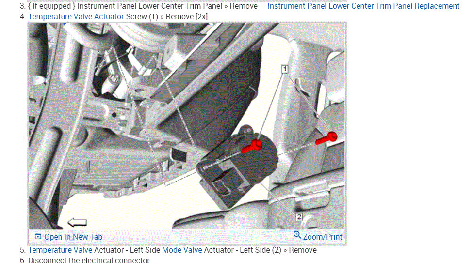

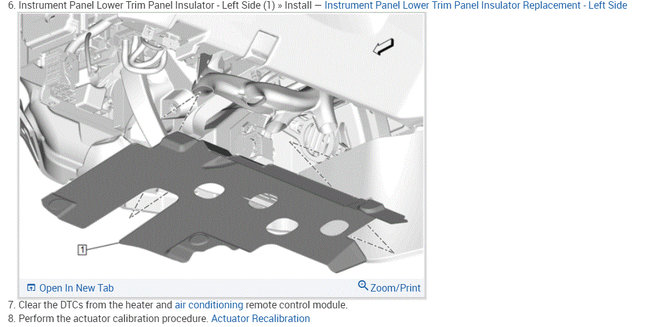

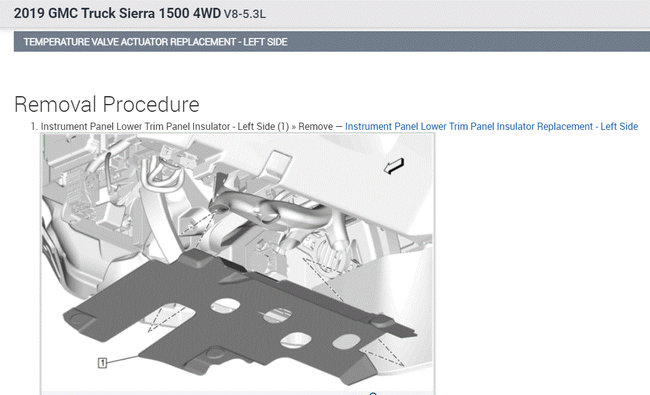

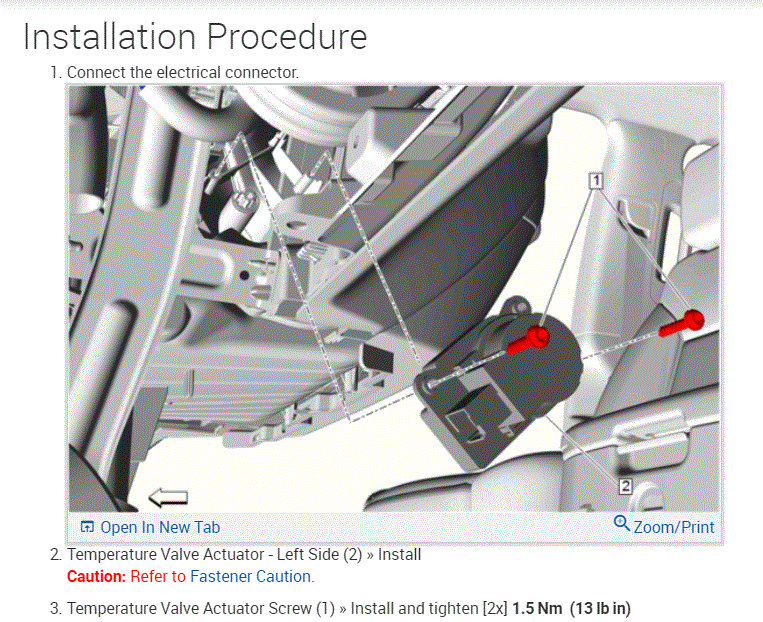

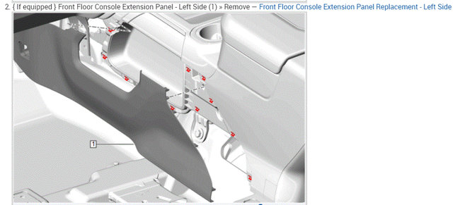

So, here is what I need you to do: Since this vehicle has dual climate control, there will be an actuator for each side. The easiest one to access is the left side. What I need you to do is remove that actuator and while it is still connected to power, change the temperature request for the left side to see if the actuator reacts. If it doesn't, we either have a bad actuator or it's not getting a signal to change the temperature.
When you have it removed, inspect where it is mounted to make sure nothing is broken or causing it to be unable to move the temperature door.
I attached the directions for the removal and replacement of the left actuator. It's a bit of a job, but the right side requires more.
Take care and let me know what you find.

No problem. I just hope it helps. Here is my theory: If the heater core hoses are both hot, then I know hot coolant is circulating through the heater core in the vehicle. So, the only thing that can prevent heat from entering the cab is one of the blend air doors.
Even if the actuators are good, there is a possibility the doors are damaged or not connected. You indicated it was in an accident, so anything is possible. However, I know the heat is there. We just need to determine what is causing it not to enter the cab.
