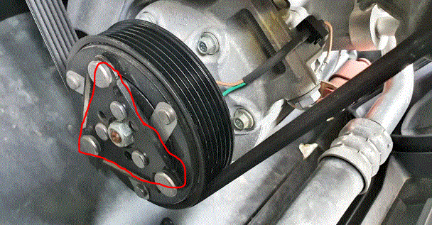

The compressor clutch will make a click when it engages. I attached pics below. Pic 1 shows the front of the A/C compressor. In red, I circled a triangular part. When the A/C is off, the pulley will be spinning, but that center part (triangle) won't move. When the A/C is on, that center triangle will click and start to spin with the pulley.

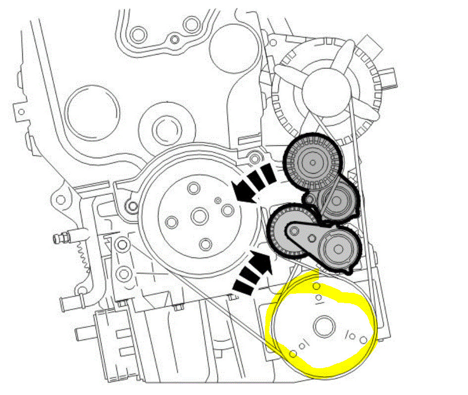

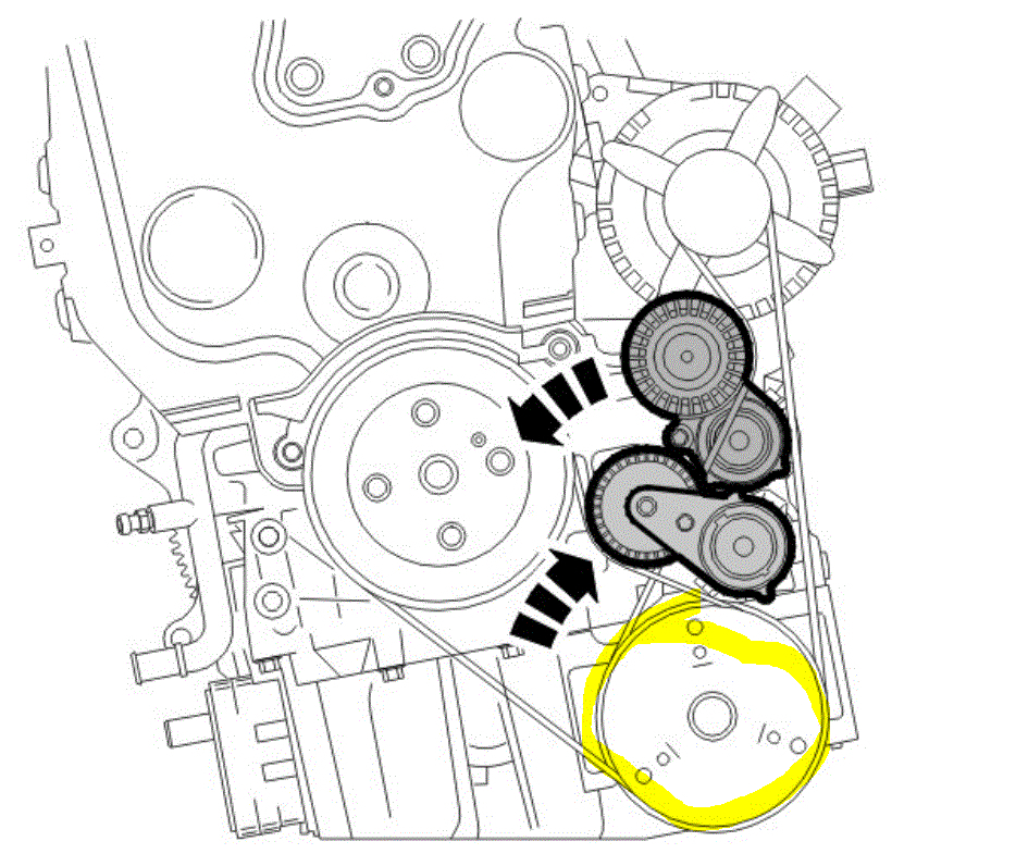

If you look at pic 2, it shows the belt routing for your vehicle. In yellow, I circled the compressor. That pic is specific to your vehicle. So, the compressor on your vehicle is at the bottom, but you should still hear it click on. When it refuses to turn on, open the hood with the engine running and have a helper turn the ac on and off. See if you hear the clicking.
Since this happens at a hotter time of the day, it seems heat related. Metal expands when it gets hot, so I suspect we are losing an electrical contact. We just need to know where. If you find the compressor doesn't turn on, we will need to check if it is getting power. If it is, then it could be the clutch. If there is no power, we need to work backward to determine what is happening. I can help you through it. Also, you indicated you're a girl. One of the best mechanics I've worked with on this site is a girl. LOL, I wish I could hire her.
