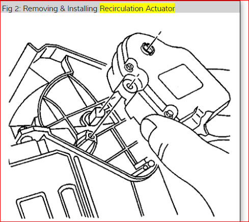

Hello again.
Here is a picture and the location of the two air mix actuators. Hope this helps and feel free to ask any more questions if needed. Thanks for using 2CarPros.

K9NIINE1966

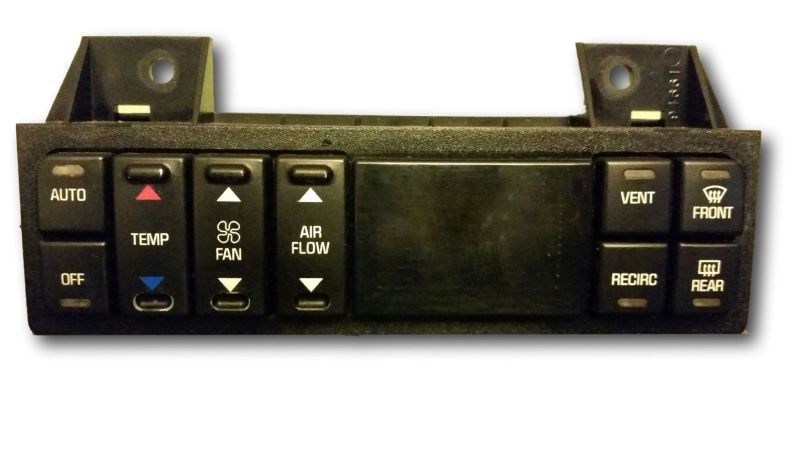

Okay, now that we have put both actuators on the driver side part numbers 89018375 and 89018383, the air now blows likes it is supposed to. Defrost vents floor all work great but now we have ice cold on passenger side and kind of cold on driver side. Could the main A/C heat controller on the dash be affecting this. I tried to upload a picture, but I do not know if it worked.
Jul 13, 2018 at 3:07 AM
K9NIINE1966
This unit.
Jul 13, 2018 at 3:08 AM

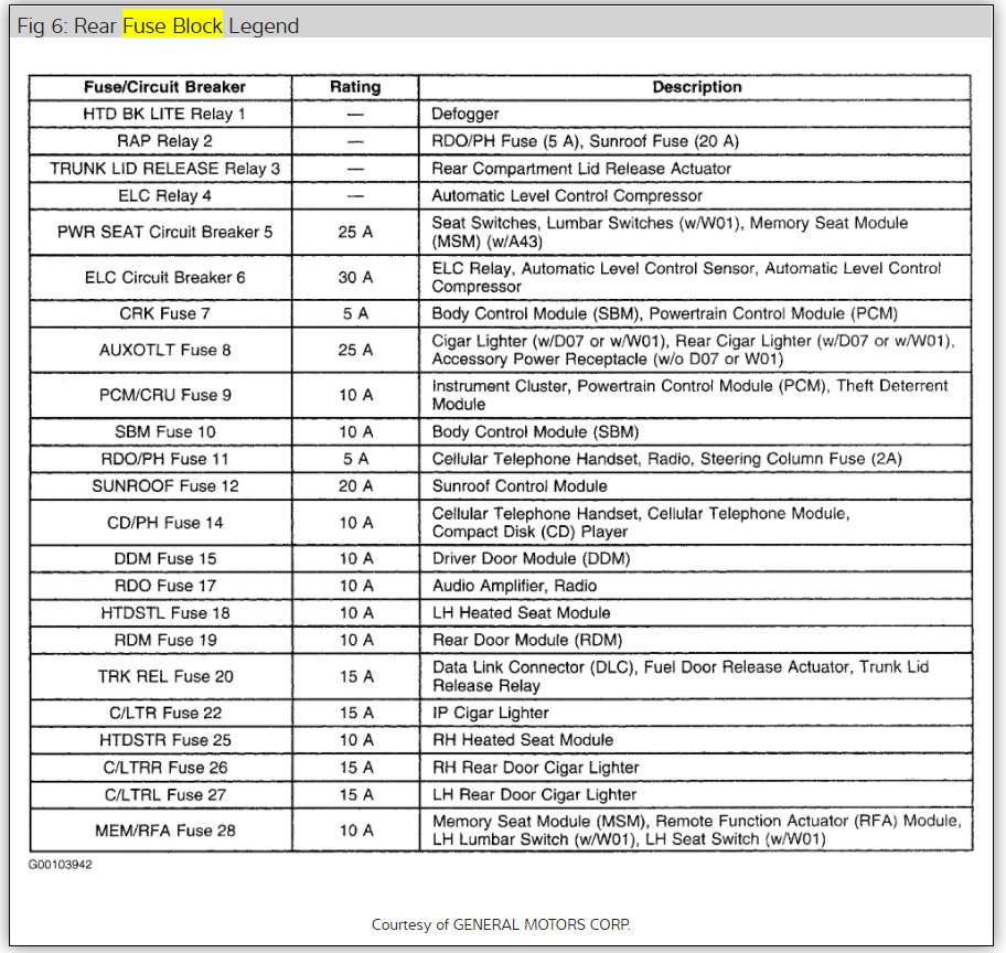

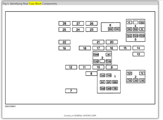

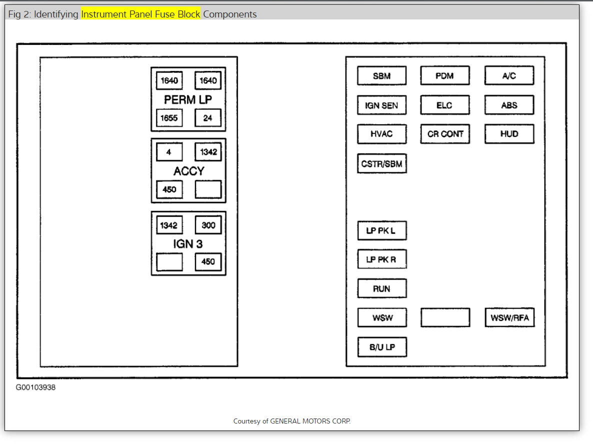

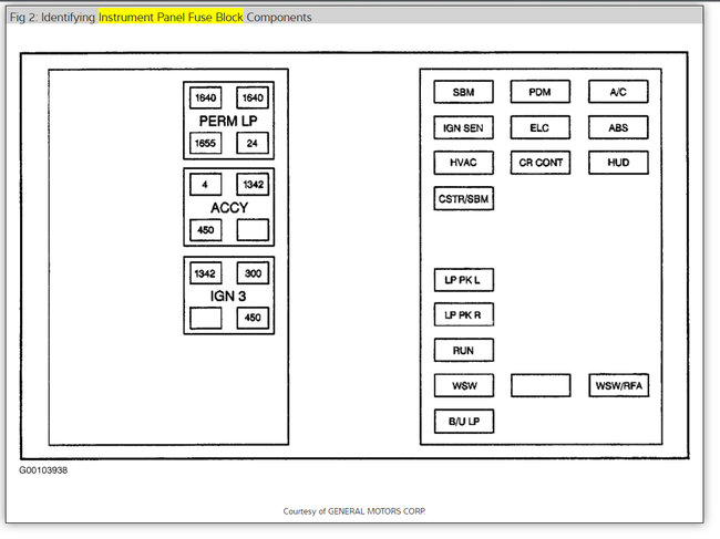

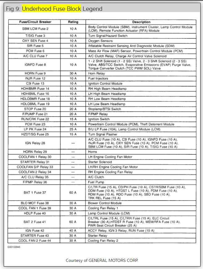

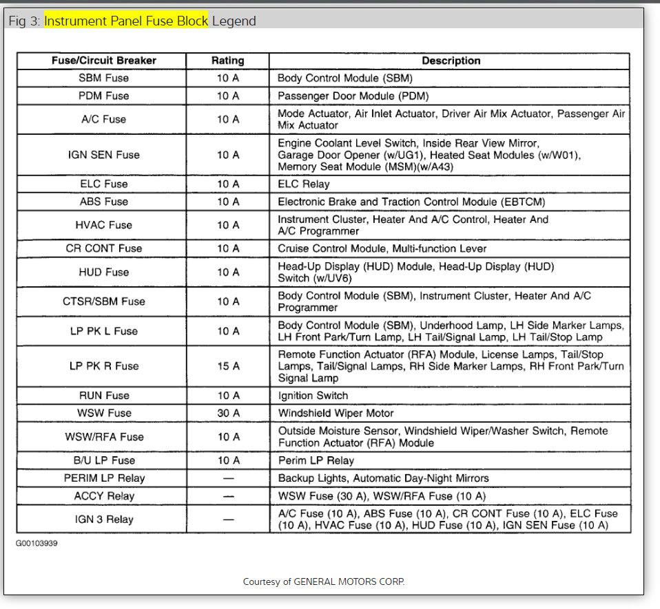

  • 55,770 POSTS
You can try to recalibrate the unit by removing the A/C and HVAC fuse with the key on for five minutes which is located in the fuse panel. Check out the diagrams (below). Please let us know what happens.
